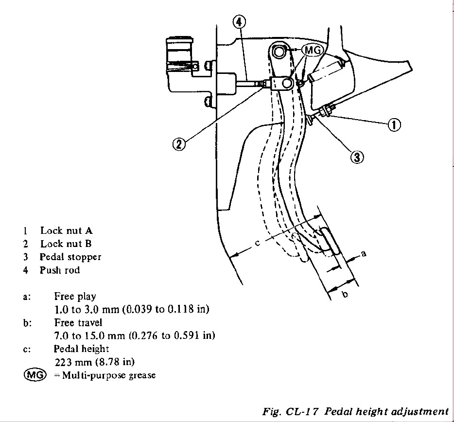

I'm looking to adjust the height of my clutch pedal as it's sitting too low. FSM shows that it should be over 8 inches from the floor/firewall but it's only about 6 inches. I can't seem to get the pedal any higher than it currently is even though there is plenty of room between the pedal arm and the bump stop at the top. Does anyone know how to adjust the height of it?
There is a threaded rod that connects the clutch pedal to the clutch master cylinder, loosen the lock nut and adjust.
The lock nut on the push rod is on the opposite side of the pedal which is not holding the pedal from going the other way.
Wow that sentence makes no sense. Gotta find a diagram.
Zforce gave you the correct answer. Just look in the FSM. It's there.
I can only assume your car is assembled correctly, the lock nut should be butted up against the u shaped bracket that connects the clutch pedal, if not make it so.

Loosen locknut, turn rod with pliers, make rod longer. Two inches is a lot of adjustment though, you might have something else wrong.
I'll have to get in there again and see what I can do. I wasn't sure if it was a turning motion to make the pushrod longer or a pulling motion.

Well, if his is like mine was, then the jam nut might have come loose, allowing the threaded rod to wiggle and rotate. The PO cautioned me before I test-drove the car that the clutch engages close off the floor. He wasn't kidding!

When I checked the locknut on the pushrod the other day, the locknut was completely loose and could be turned by hand.
