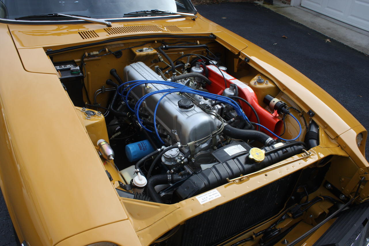

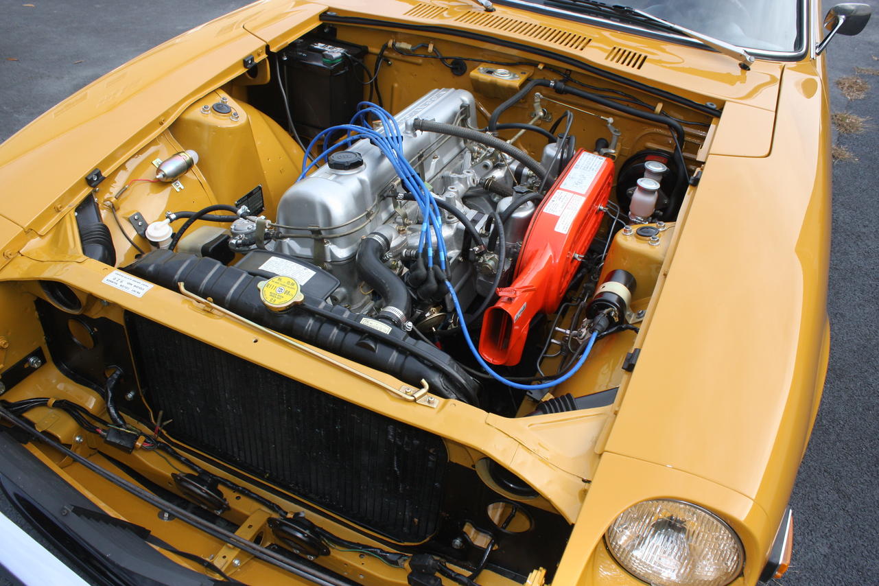

Jeff....My friends dyno still isn't set up....my guess is 170 at the wheels. It runs best at 18 degrees advance at idle. I love the combo of short stroke and bigger CID. It's a really smooth engine. I'm running this combination in the orange and gold car while the white and green car are running the L28 crank and rods .....all 4 L28's are running shaved and shimmed P79 heads with stainless swirl valves and Isky Stage III cams. The silver 73 is running a .040 over L24 with an E31 head with L28 valves and an Isky Stage II cam.
