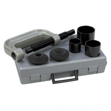

I just got finished doing all my half shaft and drive shaft u-joints and replaced them all with new Spicers. I tried a number of different methods, but ultimately found that the U Joint tool that I purchased from Harbor Freight worked the best. I got it on sale and also had a 20% discount coupon and so got it for about $35. Great investment and worked really well even with some of the more difficult joints to free up on removal. Would definitely recommend this if you are going to do your own especially if you can get it on sale.

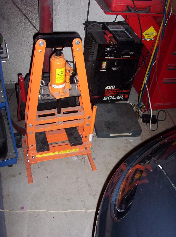

Got to love Harbor Frieght! (for some things) I bought this small press from them a few years ago and use it for u joints as well as a lot of other stuff.
