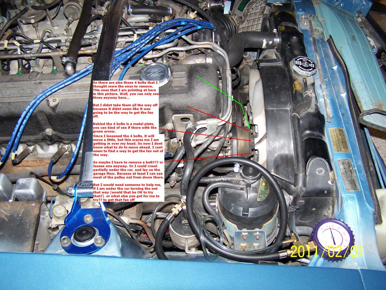

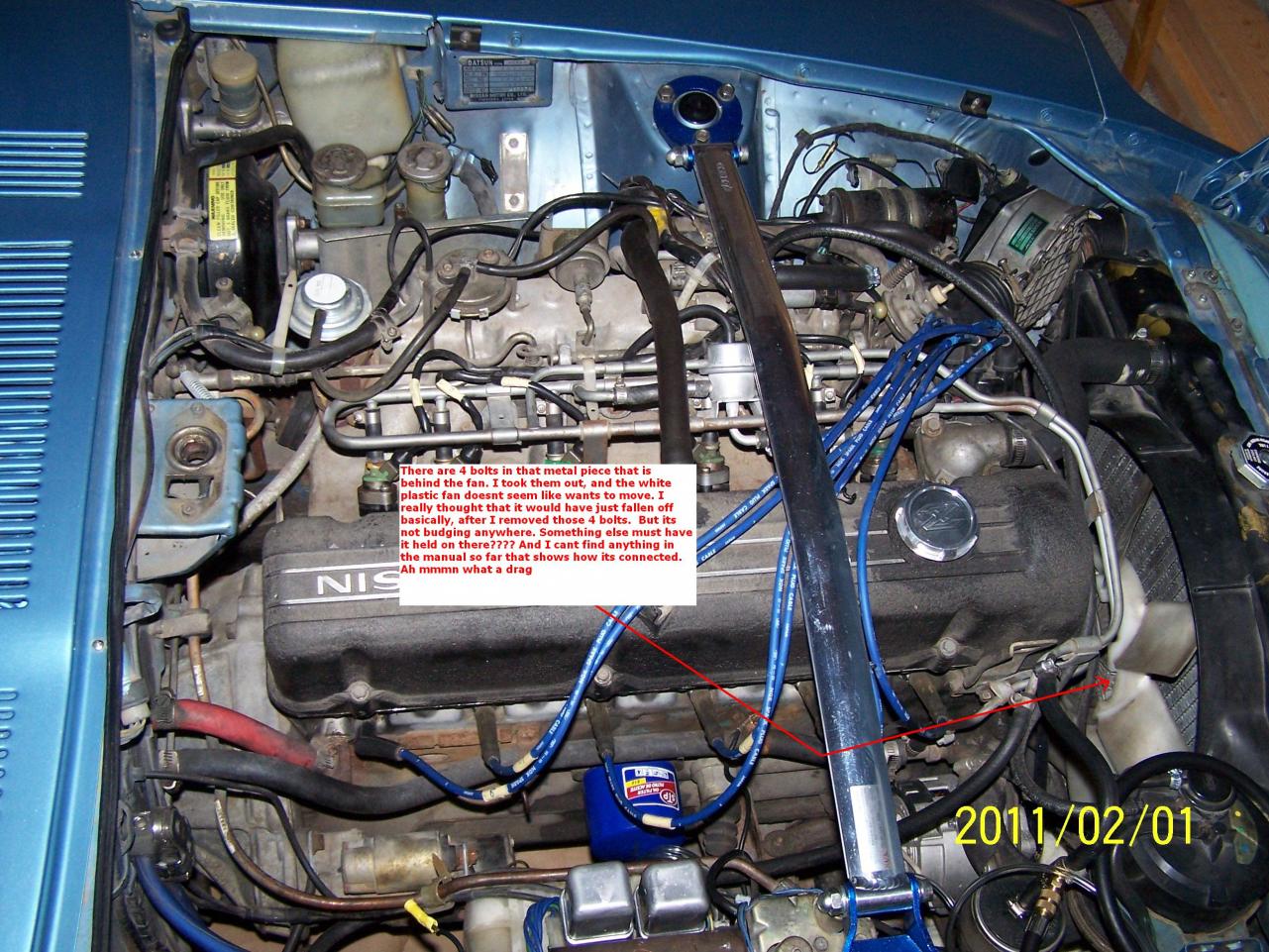

ALso one other question, how in the heck can I remove the plastic engine fan? I noticed two sets of four bolts. Found 4 bolts on back of fan, that didnt seem to help at all, and then 4 bolts on a metal bracket that the fan propeller shaft runs into. But some other force seems to be holding it onto its bracket???? It doesnt seem to want to budge. I just wanted to get it out of the way so I can get a big wrench on the crankshaft pulley nut.
I saw your message about taking a fan belt off, but I have never removed any belts and I think I might not want to attempt that right now....I got enough other things I am already into right now.....

PS PLease look at pictures you will see what I am talking about in a little better detail.

The 4 bolts that you point to in your picture hold both the fan, and the fan pulley to the water pump. This is the "standard" arrangement in most RWD cars by the way. You should at least loosen the fan belt before removing these bolts.
