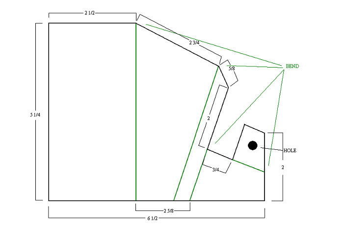

There are several posts contained in the forums that describe a choke bracket to remount the choke lever onto the transmission tunnel. My choke lever is getting very difficult to operate in it's factory location and weather is getting cold enough to mandate the use of the choke in the mornings..
Does anyone have one of these aluminum brackets available for sale that they are willing to part with? The link is here:
http://www.classiczcars.com/forums/attachment.php?attachmentid=15825&d=1167590642
I'm surprised that MSA (or an enterprising Z owner) hasn't jumped on this opportunity - especially since every 240Z seems to be afflicted with this problem <g>
I believe that this is a template for making your own mounting braket. I can't seem to find the post that went with the template but maybe someone else can help there...

If lubing the cable doesn't work and you still want to get a bracket then go to your local home supply and get about a foot of 1/2 flat metal. Check the gauge of the metal to see how flexible it is.
Use the attachment you have as a template. All you need to do is experiment with the bends, test fit and bolt everything together.
It took me about 45 minutes and believe me...fabrication and me have had a life long battle!
If I can make one ...so can you.

For my 260Z, I just copied a bracket that I found a previous owner installed in my 240Z. I think I posted drawing of it in another thread.
