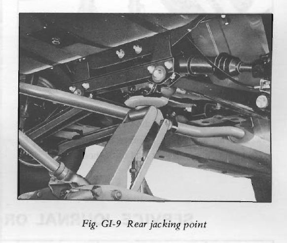

Is it ok to jack up the rear end of my 1970 240Z from under the differential? I have been doing this to get her up on jack stands. I just don't want to damage anything. Is this a problem?
Mike

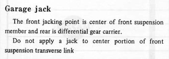

That's what the FSM recommends.
-Mike
Make sure the lifting pad is centered and/or not too big or you'll crush your exhaust pipe.
That was a concern. I have a larger pad that I have to position carefully to missed the exhaust.
