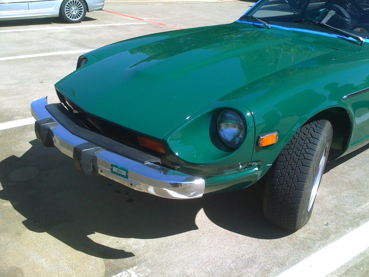

Now that you have a picture on the first post, I can tell you what the prolem is. Somebody, probably the Previous owner, bolted a "Park Bench" on your front end....
Sorry, couldn't help it.
Dave
