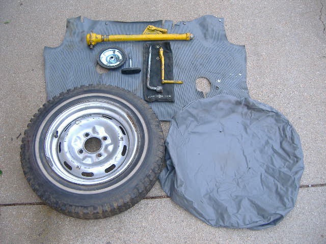

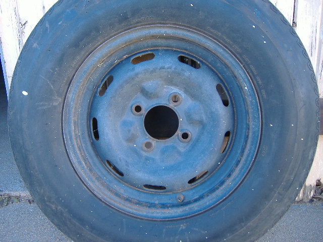

It is the same bolt pattern but not the same wheel, close though. The wheel covers from a Z "might" work on a Roadster wheel. I can check for sure later. The wheel from a Roadster will have 3 balls welded to the inner ring for the 'baby moons' to snap over. Here is one of each.
Bonzi Lon
I stand corrected. Went out and looked, both are the same except for the Roadster has mounting tabs, (not the balls) for the 'hub caps', the 240Z wheel covers will fit.
