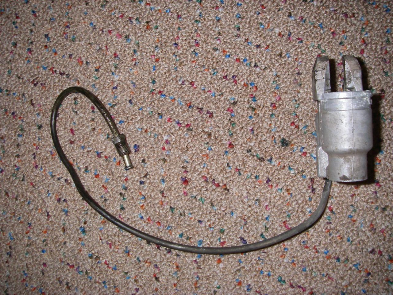

Had to rebuild my driver's side rear wheel cylinder and I managed to strip the hex-fitting on the hard line where it meets the cylinder. Won't be doing that again, I subsequently picked up a set of flare nut wrenches and a mini-blow torch! This line is kinda crescent shaped and I would like to replace it with an identical line. Does anyone have one I could buy, or know where I can get one?
This is the early style, of a '70.

Just go to your local parts store and get a BLJ-320 brake line and bend it to fit. That is going to be the correct tube and nut size for your Z. Only thing needed to bend it is a pair of gloves. Gloves help a lot when bending brake lines.
This is all I did to replace them on my 71 that happens to be the same as yours. Easy job to do.
Dave...
Thanks Dave. I have the hard line to do it and I'm sure I could make a serviceable facsimile, but I'd like to pick up the exact Datsun piece if possible.

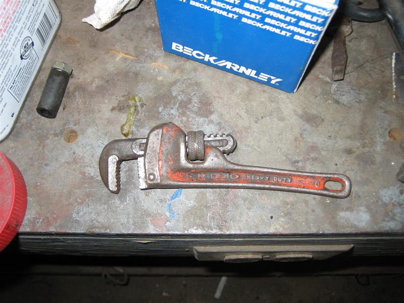

Helpful (I hope) hint. One of the best tools you can have in your tool box is a pair of the small Vice Grips with fresh grippy pads. These work great judiciously applied to the hex fittings on brake lines and assembly screws on SUs (bowls and domes) to just break them loose. Standard wrenches will take it from there. It's called GET A GRIP ON THINGS!!
I'm sure they'll work on other things where Magilla Gorilla at the plant was having a good day so ecperiment around your Z......
Say hello to my little friend!
"Borrowed" from my father's tool box about 25 years ago. Guaranteed to work on ANY stuck nut, fitting, caliper bolt.
Might chew it up a little, (pre-treating with PBblaster helps tremendously) but definitely worth a try.
