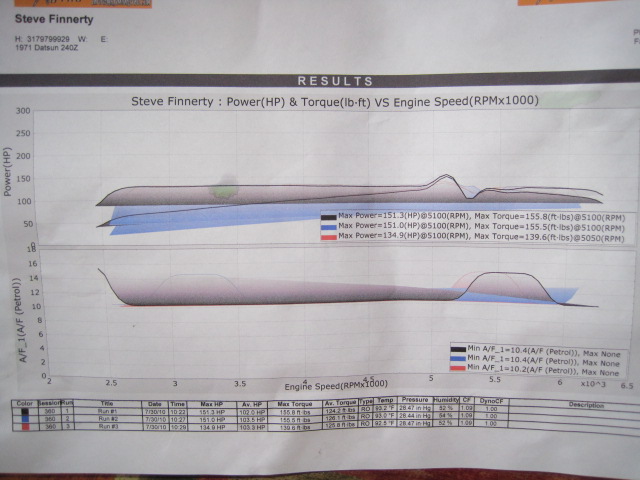

Well I took advantage of the dyno while at Zcon this year and I am looking for advice based on my chart. The engine is hardly broke in with 800 miles, but it was running great so I thought I would see some numbers. I am very happy with the numbers based on what little time i got to fine tune. As you can see from the chart I ran lean at about 5200 with my SU's with SM needles. I am also suprised at the richness at the lower rpms since I did so well with my MPG on the way here. I did have a richness problem on the front SU before I left and I'm not sure what exhaust pipe they were reading off of.
I thought the HP and torque #'s were good for the 2.4(.40 over) and the stage 2 cam. I believe there was more there based on the chart since the cam should make power up to 6500rpm. I do have the 280 valves in there also.
It was suggested that I raise the fuel pressure-but I am running a mechanical pump. What options do i have? I checked float levels before I left and set them to stock specs. From what I read these SU's should handle more hp than this.
I was also interested that the afr's fell off sharply at 5100 instead of slowly tapering off.
I was happy to see that I my engine put out 20 more HP then the 2.4 before me with triples(he was running way rich)
The fact that your cam is supposed to make power to 6500 and you drop off sharply at 5100 could mean you ran out of carb with your SU's and that set up.

Please correct me if I'm wrong but From what I understand a set of SU's should support anything a 2.4l NA L6 can put out. No?
I'll ask the owner to read this over and see what he has in the way of ideas. Forty six millimeter Hitachis supply everything Steve's race motor requires to well past 7 grand with no protests.
Sm's should be fine down low while getting a little fatter up top. What you are describing is bassackwards from that. Velly inellesting!! (from Laugh In)
I would think that the SU's would handle my meager HP even in stock form with SM needles. I have a set of triple Mikunis sitting on a shelf, but I want to get the best tune out of the SU's before I put them on-just so I can compare.

No. Modified SUs can be made to work with up to about 240hp but you lose a lot of low rpm drivability. After that you need triples or fuel injection.
For the mixture issues you can go one size larger on the jet and then run a needle that has a bigger OD at lower rpm and a narrower OD at the upper rpm. That should help the top end without making to bottom too fat.
Check post number 30 on this thread (gives my dyno result with SU's and SM needles).The L28 with Stage III Isky and .080 inch shaved head never missed a beat . The A/F was darned near perfect throughout the RPM range. Guy http://www.classiczcars.com/forums/showthread.php?t=31001
