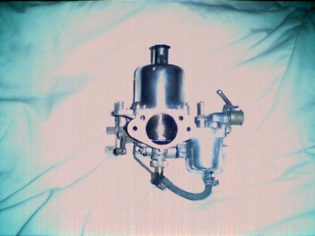

Today I was sitting around at the shop looking at my motor on the stand . Just wanting somthing to do so I pulled the carbs and started in on the tops. first I took the tops off. Then used 150 sandpaper then 200 then polish and my benchgrinder with a buffing wheel. WOW I will post some photos soon. I have only done one top at this point it took me about a hour and a half. Now you can see your face in it. This is going to look so cool when done and back in place.

here is the one I have done. This will look so much beter under the hood.
Now ya did it. I've had a buffing stand I bought form Eastwoods sitting in the garage for a year, now you made me see what I need to do. WORK!
Work is true. But worth it. The carbs are the easy part. I am working the intakes next. Then who knows timeing cover and waterpump. But when you can get this look with what you have with just some time and work with little money why not ?
Ouch !!!!! Nice Job !!!!!!!! That will give me something to do !!!!!
You think buffing out the stuff is work? That's not near as bad as trying to keep it looking that way. That can be a full time job.

Yes, the upkeep can be a real pain. I have taken every part and put a real good glaze on them. I have done this with wheels and had the shine last well over a year whith little work.
With the valvecover I have polished the lettering and raised bars and lower edge. Then painted the rest flat black. It looks so good.
