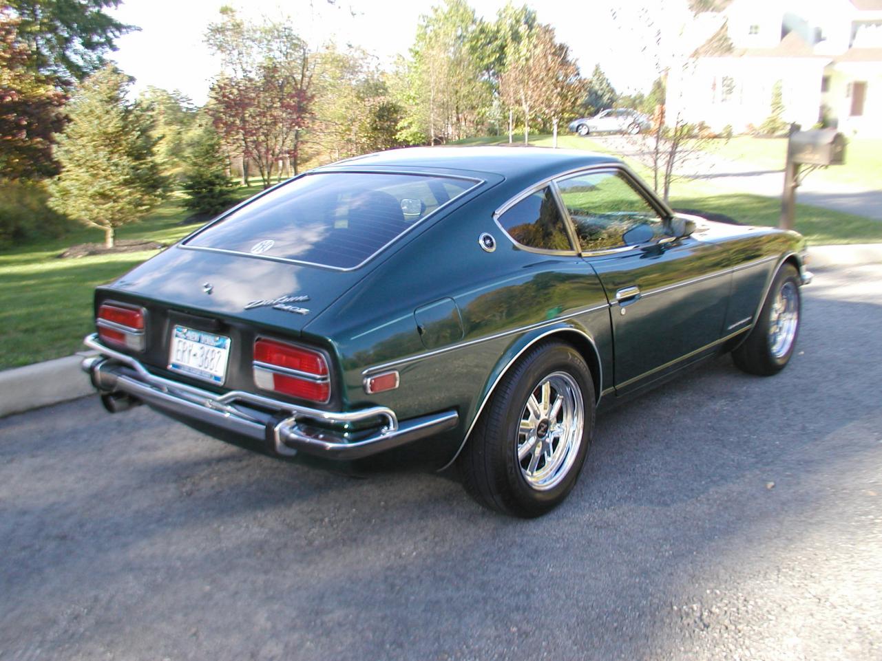

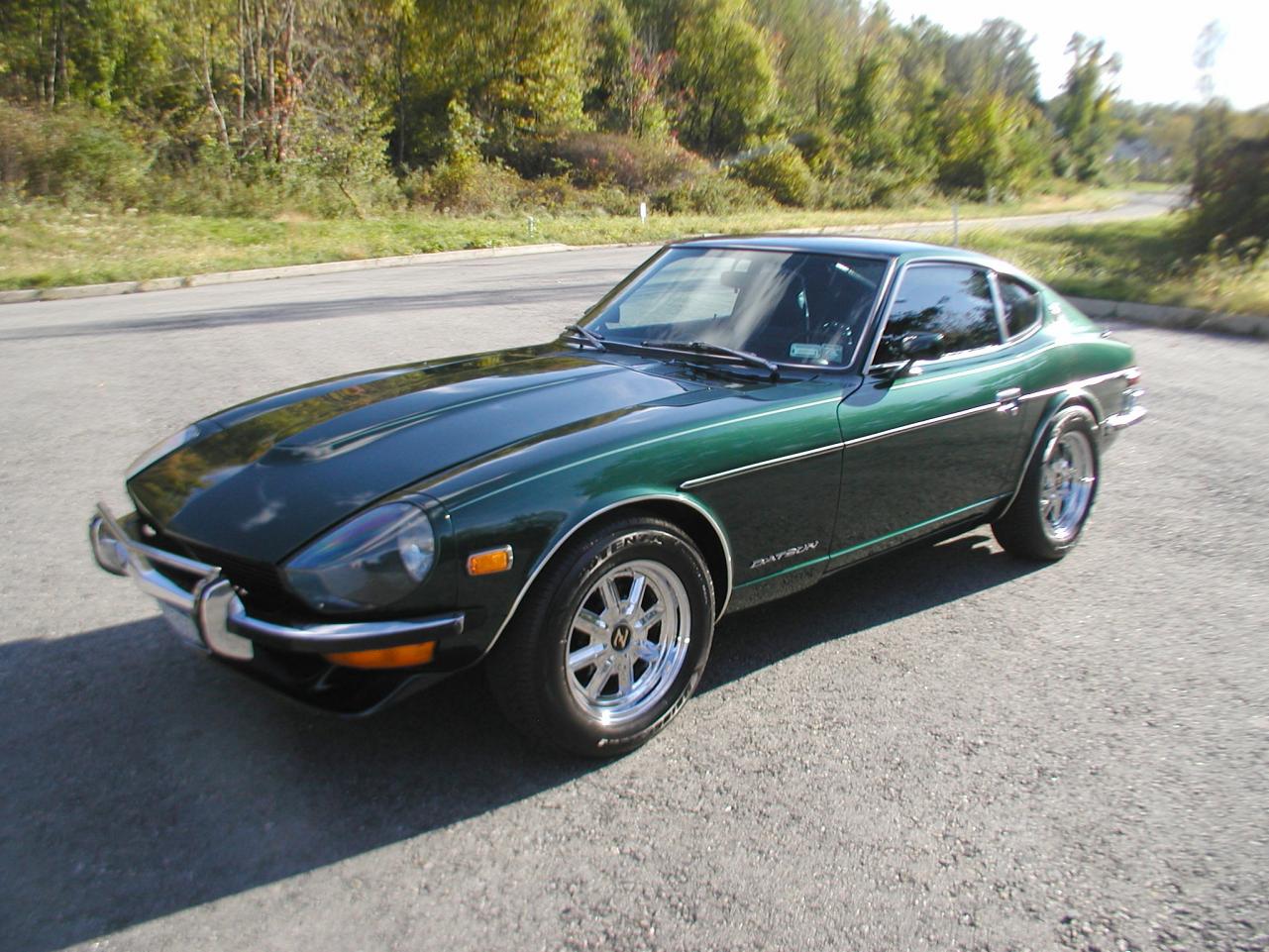

Hello, I'm looking for advice on an SEM product: Clear Chip Guard - Aerosol 39804 . I'm getting my 240z ready for summer driving and this year my goal is to try something that prevents all the stone chips along the running boards and rear fender from dinging up the paint. I must spend at least an 1hr per month touching up stone chips. With my tires on 7.5" wide rims and driving on clean highway and smooth roads, I still pick up quite a few small stone dings in the paint - in some cases down thru the primer to the metal.

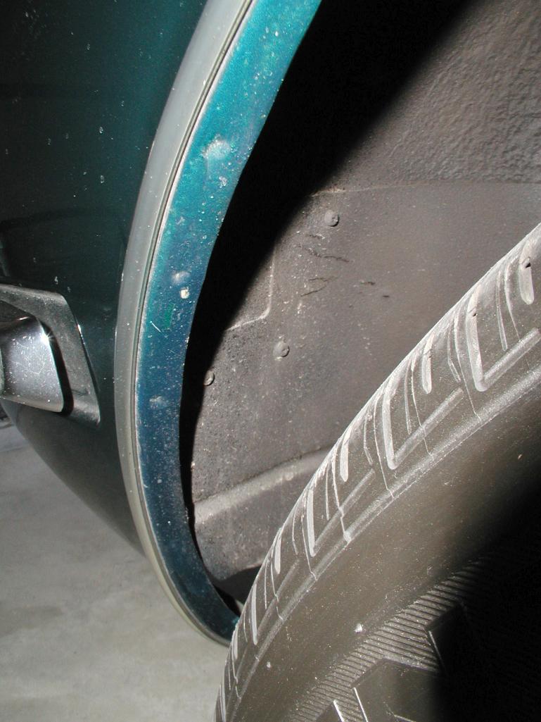

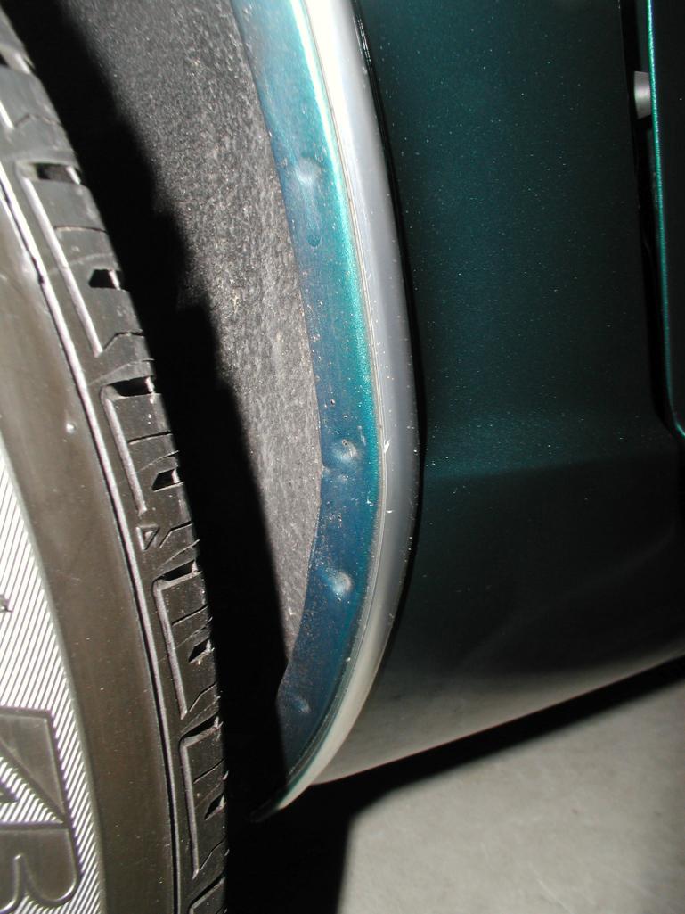

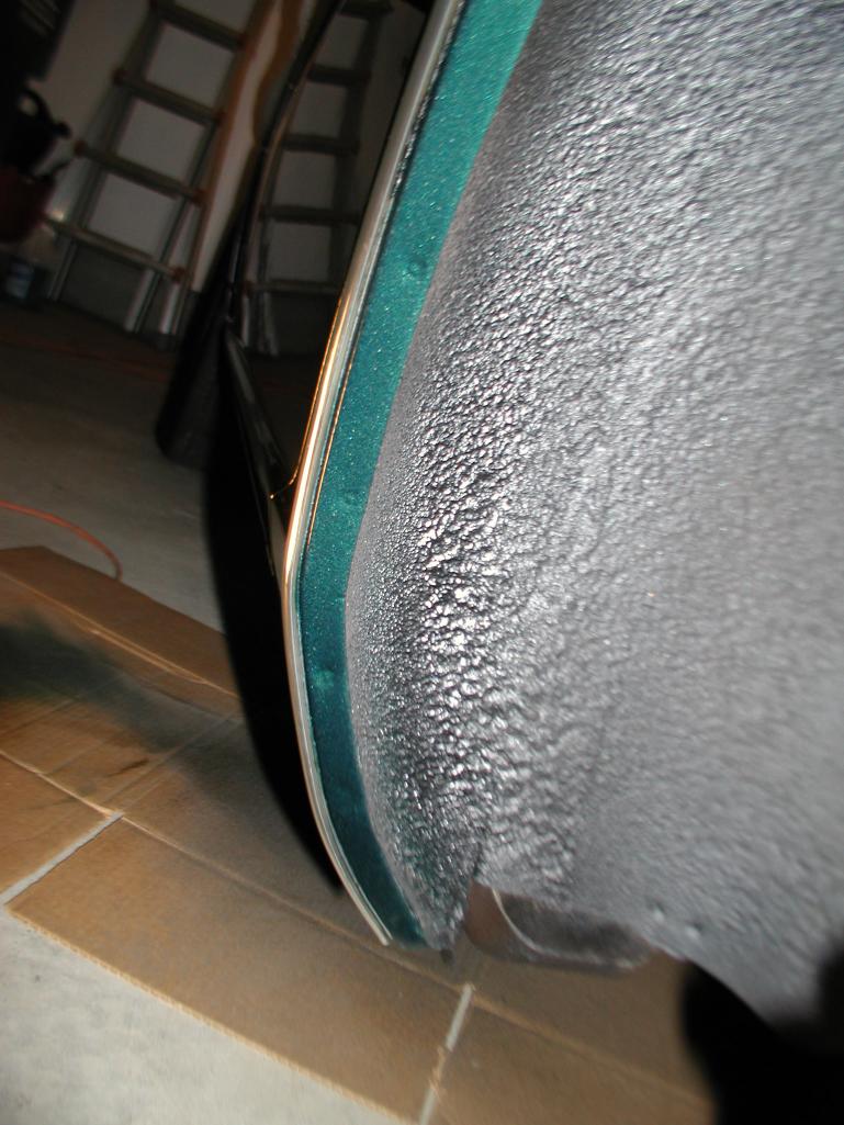

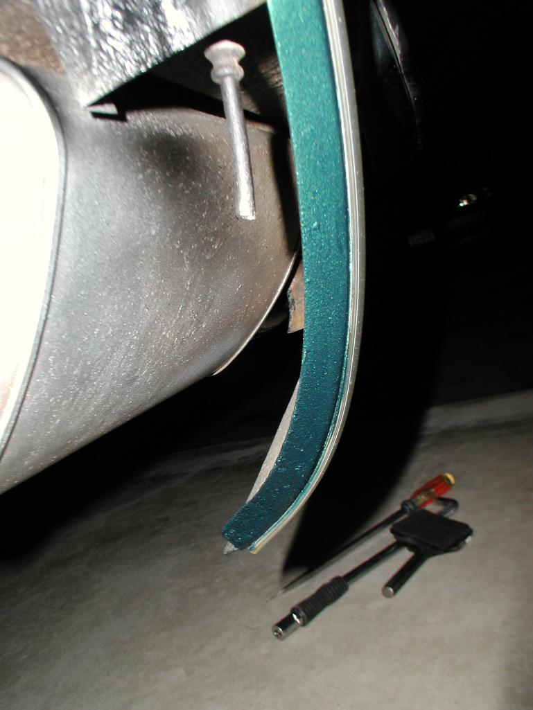

Hello, since I purchased a can of SEM Chip Guard -39804, I tried it on the wheel well inside edges. They get chipped up pretty bad and I'm always touching them up so I figured I had nothing to loose tyring it out.
So .. my process steps were for the most part just as described on the spec sheet. SEM Tech. Data Sheet: http://semproducts.com/images/tech_files/CG%20TDS.pdf
Sequence:
1) Cleaned surface from dirt and road film with dish wash detergent, water & spong. Rinse clean and thoroughly dry.
2) Using Scotch-Brite Pad (Gray color ones), rather than 400 grit Sand Paper, I dulled the surfaces enough to prep for base Coat Paint.

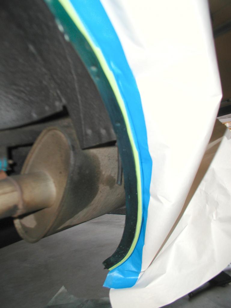

3) Then I sprayed 2 light coats of my "Green" Body Base Coat paint. I allowed 10mins between coats and then 20mins for it to dry.

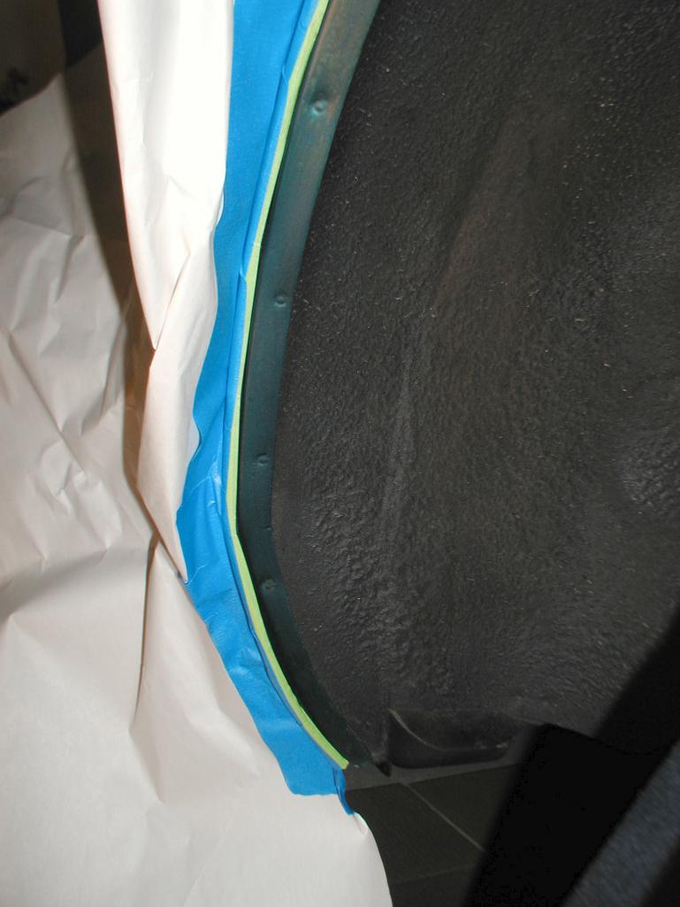

4) Most important part when using the SEM Chip Guard - for maximum gloss and clear/smooth finish:
......... a) Hold can ~20 inches away. Calibrate your spray distance with a tape measure just to be sure you are far enough. Too close leaves a lumpy surface.
......... B) Start by spraying the SEM Chip Guard OFF the surface on paper masking area until the flow is steady/uniform keeping ~20 inches distance from the surface. I applied two passes so it was uniform and had a wet look.
......... c) Wait about ~5 mins, then repeated above applying two passes for another wet coat. Then repeated after another 5mins and did a 3rd application.
5) Drys to touch in 30mins - pretty quick. Pulled tape off immediately and no pulling or sticking to the tape edges.

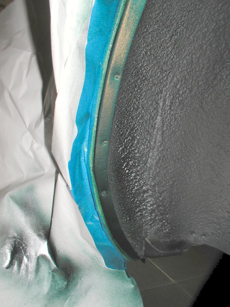

Photos could have been better, anyway they are ... 000/001 - before, 002/003 - scotch-brite scuffed, 004/005 - green base coat applied, 006/007 - After SEM Chip Guard applied.
Overall .. it' looks pretty good. The SEM coating is defnitely heavy. We'll see how it holds up...
