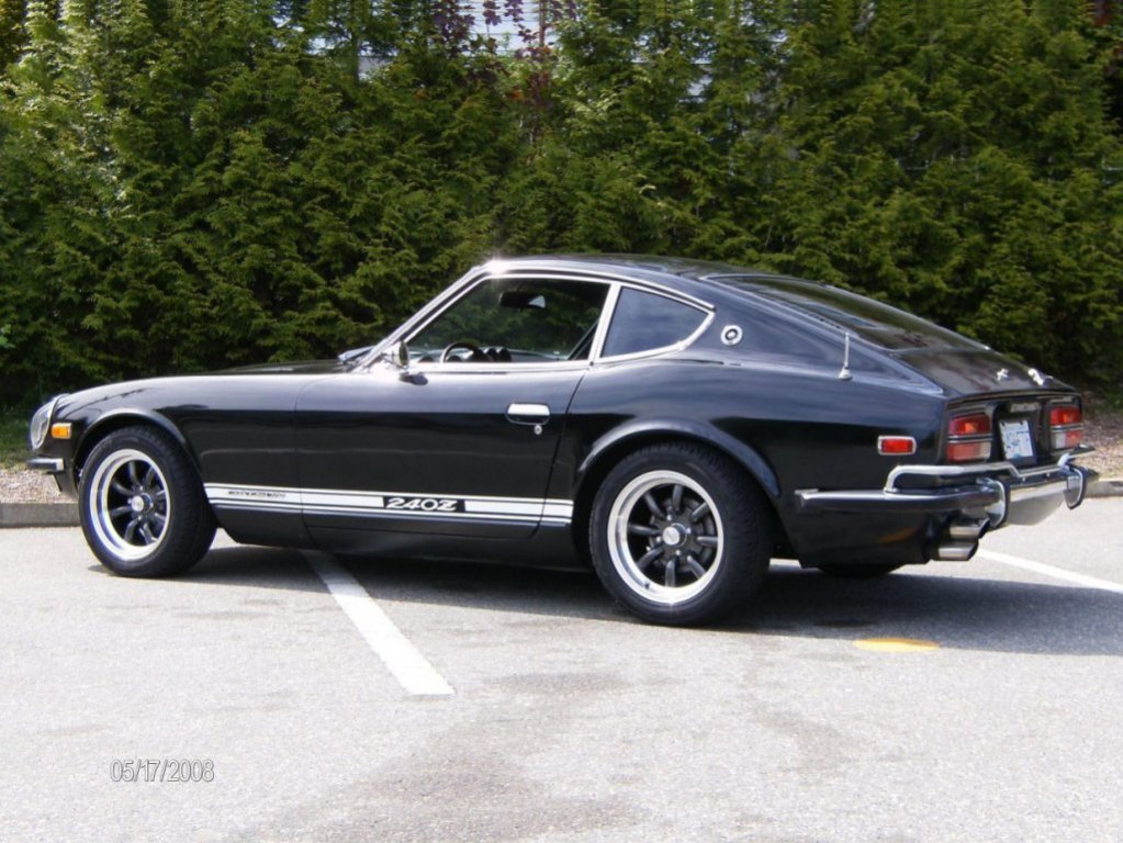

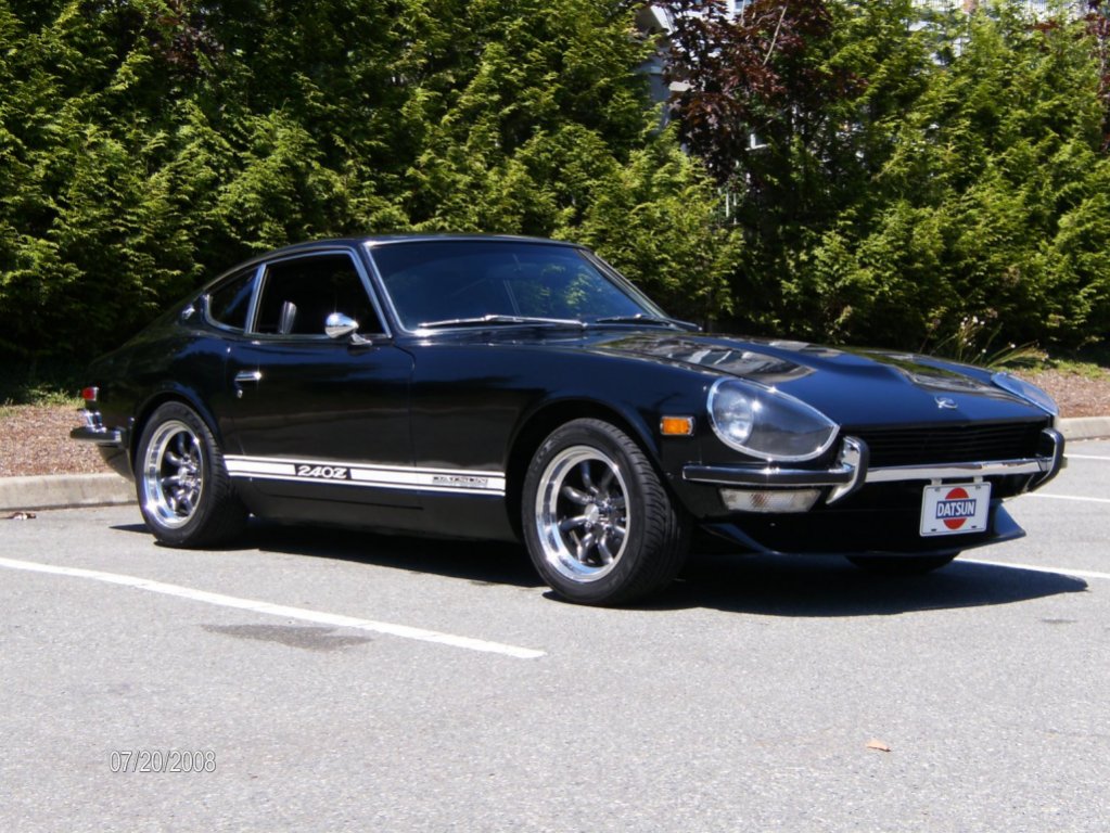

When I had the '72 in Vancouver, I used the Eibach lowering springs, new struts and dropped the car 1.5 inches...I had the 15x7 Konig rewinds with 195/55/15 Kumhos as I didn't want to go too wide....and there was absolutely no rubbing issues.
If I was to do it again, I would go 16" wheels, wider tire and maybe not lower the car at all but go a taller sidewall to fill the space.
A couple of pics with the rewinds for you.
Chris
