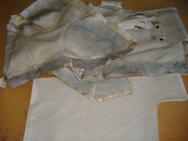

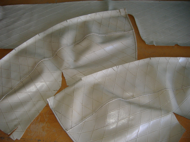

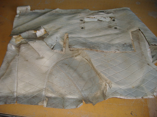

Same problem here, quarter century of overspray and grime, on off-white no less. Laquer thinner was the only product that cut it quick and easy. I found using small squares of cloth to take off most of the grime, then follow with a clean cloth and thinner to remove the residue worked best. Plenty of safety precautions and ventilation. Some before, after and compare.
