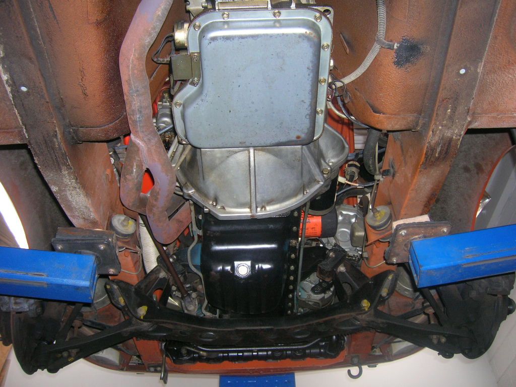

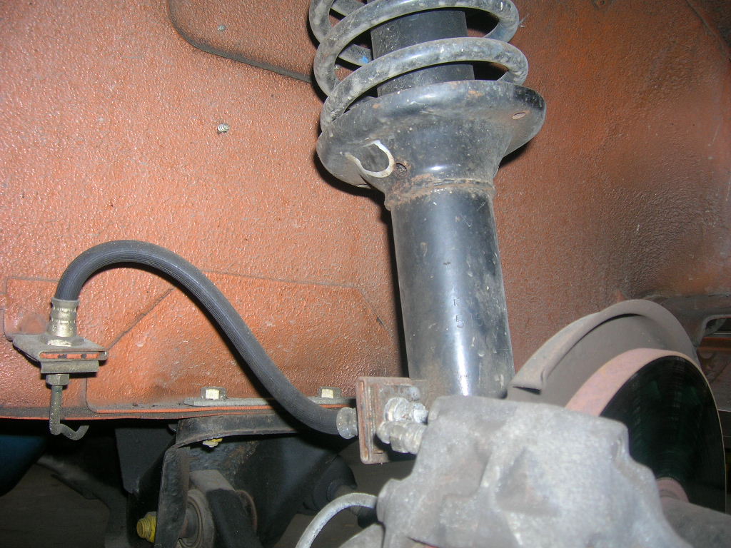

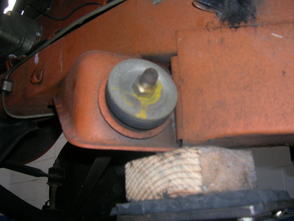

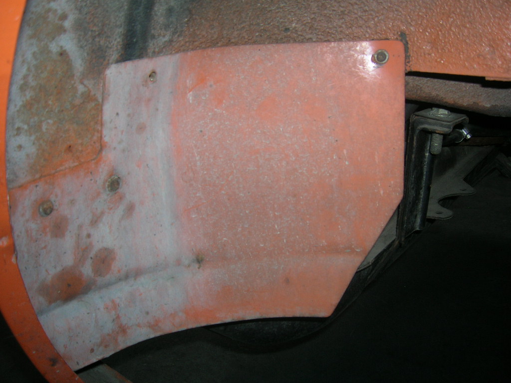

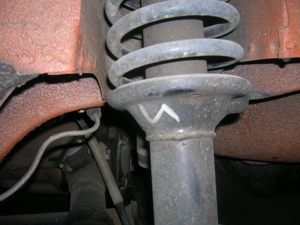

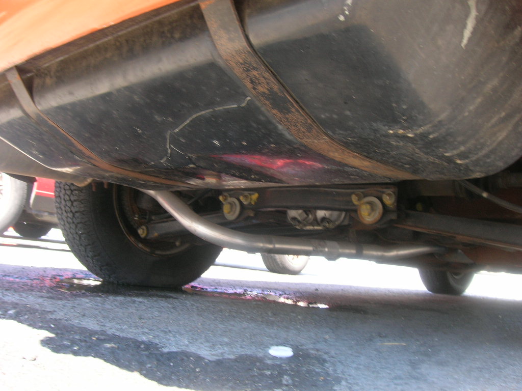

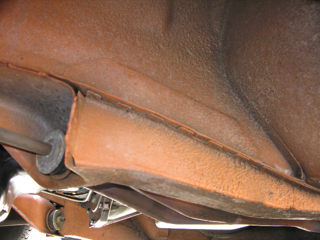

Many cars that were shipped to East Coast had black under coating.
Many others for West coast did not receive any.
Here is one from Wast coast. I hope this will help you little.

Are you talking about factory undercoating or additional undercoating applied by dealers? I wouldn't doubt that many dealers in rust prone areas added additional undercoating, as much for additional profit as for any protection it provided, but I have never heard of the factory undercoating cars differently based on which coast they would be sold on. I doubt it was even known which coast the cars would be sold on when they were on the production line.
Based on what Terry Vollnogle relayed from Carl Beck, the only difference was that very early cars (1969 and early 1970 production) only had undercoating (which was then covered with paint) in the wheel wells, while later cars also had undercoating (also covered with paint) on underside of the floors, etc. http://www.classiczcars.com/forums/showpost.php?p=303027&postcount=19
This is consistent with what I have found on my three 1969 production cars and my 5/72 car.

I can pretty much confirm what you said, Mike, as well as the reference going back to Carl. We had this discussion a long time ago when it was believed that all undercoating was applied after arrival in the States. The description from Carl and Terry is fairly accurate, showing a rippled texture to a thick paint finish throughout the rear wheel wells and rear deck extending into the transmission tunnel. I have no evidence of the front fenders receiving this treatment; just the front wheel well area of the chassis indicating that this surface was applied prior to application of any mechanical and body components. I think the splash shield in the right rear wheel well is discussed accurately also. No texture, just paint with painted screws. I would not describe the paint finish as "overspray" though. I find a thorough spray applied finish. I have an example of an early car in silver and the paint finish underneath does not contain the metalic luster of the upper body surface. It is simply the grey pigment.

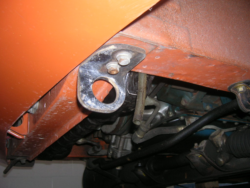

I suspect that the "undercoating" finish was applied at the same time the body seam sealant was applied. The paint finish is obviouosly spray applied and I have noticed thin or non-existant spots underneath the cowl, top, and inside the rear quarter panels. Ther is also a bare strip on the post that braces the rear valance at the center of the car. My cars show no evidence of paint inside the constructed body sections. It seems to be all bare metal in there.

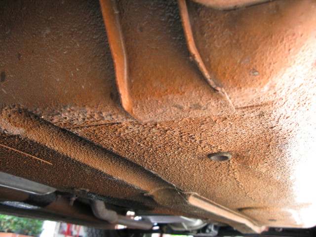

Here's a pic of the original coating I found while cleaning off the years of accumulated crud under my Z.
This second pic shows the rear valance reinforcing strip that is void of paint on every S30, that Chris mentioned. I originally thought that was caused by the grounding clamp being attached at this point while in the paint system. I now think it was simply from the placement of a temporary upright support, used to hold the rear hatch open during the painting process.
