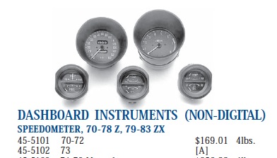

E, I was pretty certain that the three-wire started before the end of the 240Z run. While the Nissan parts list is not helpful on this, I note that the MSA catalog lists the same tach for '70-72, and the '73 unit is different. So I'm thinking that 3-wire for a '73 might be correct.
Or at least we can assume that the '73 unit is unique in some way, if not in the 3/4 wire part.

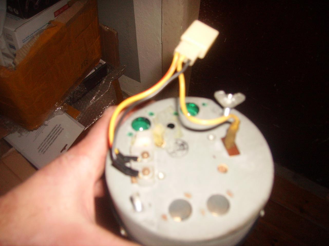

I have one here that was in with a parts lot I bought years ago. It looks to be the same as the one in Dan's pic. There are 4 wires pinned in the connector, but the two white wires are actually 1 wire that makes a loop and runs back to the connector. Other than that I know nothing about the reason for that. I took 1 pic and the camera died on me.

Enrique, this is the same tach that I have that I told you of,
yellow/red and black wires and a all white that makes a loop.
It has the same square connector with four pins.
Ron yours is the same as mine. the loop part should be held in place by the insulated block held down with a nut. A friend of mine needed a 280 tach and I had one so we traded.

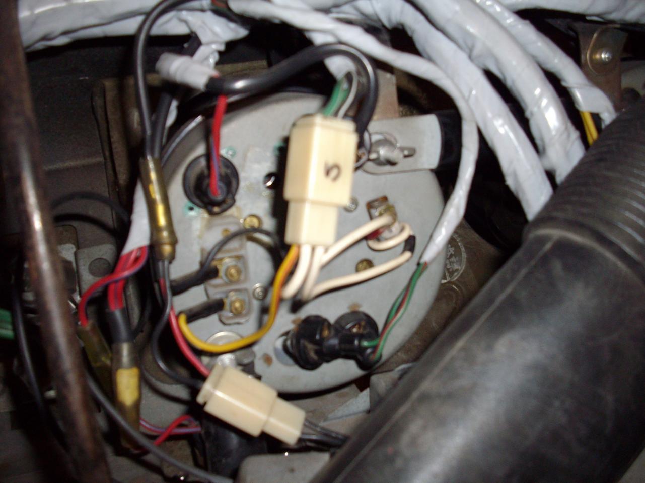

This is the back of my -73 3 wire tach.

yours is different

That's the one!!! I am the one that Enrique has been asking for. I just became a member. My name is Dave. Thanks for the picture. Does anyone know where to find one like this? Please let me know by posting or sending me a PM. Dave
