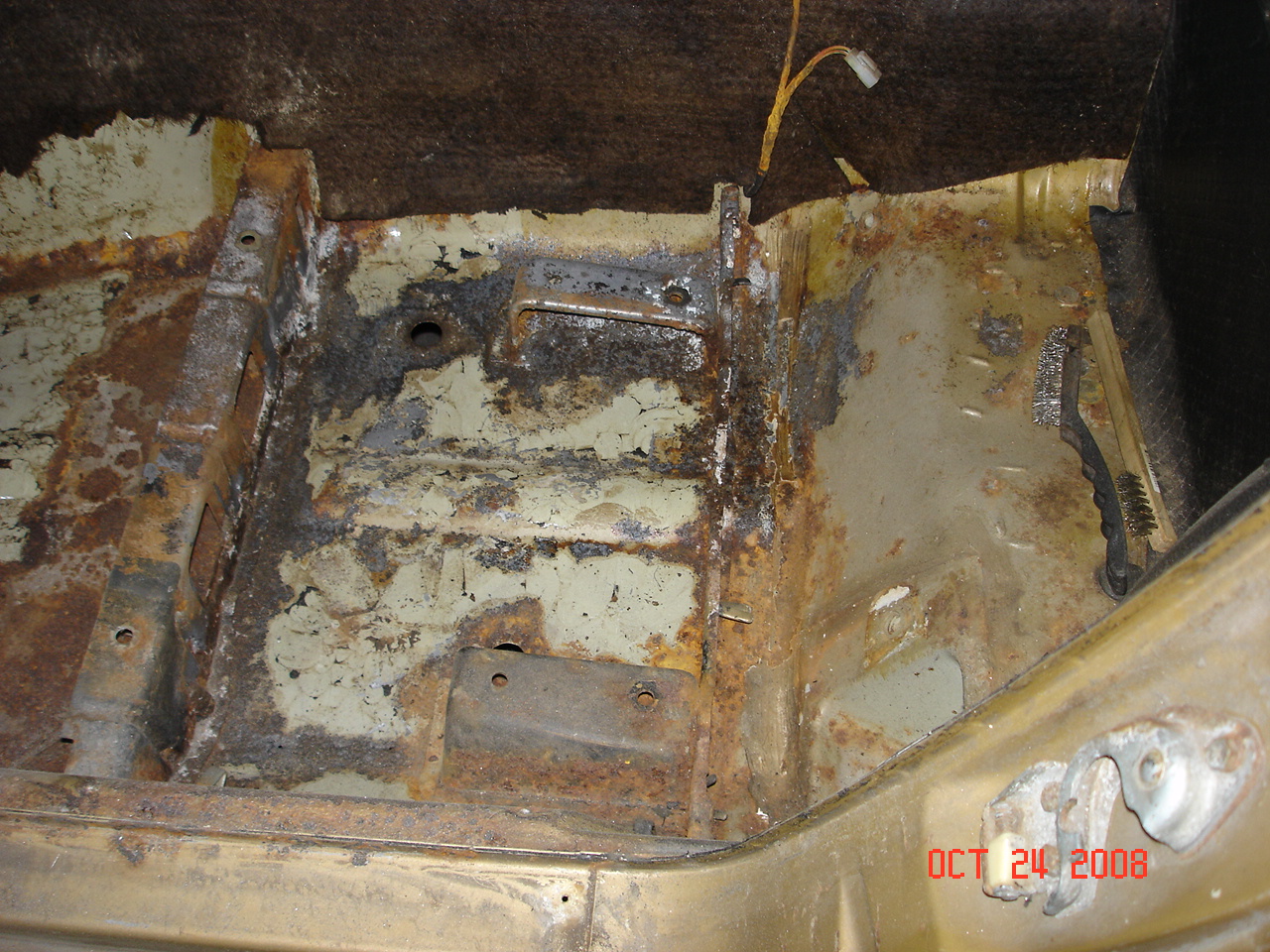

I just waited for the cold weather to chill the mat by leaving the garage door open all day. Then I used a body hammer with the pointy end on it and it snaps out like Peanu Brittle, as said above. Then follow thru with a putty knife for the small bits that are left.
The first 2 pics show the after, of removing with cold weather and a pointy happer and also show the Rust Mort white residue that I later cleaned up.

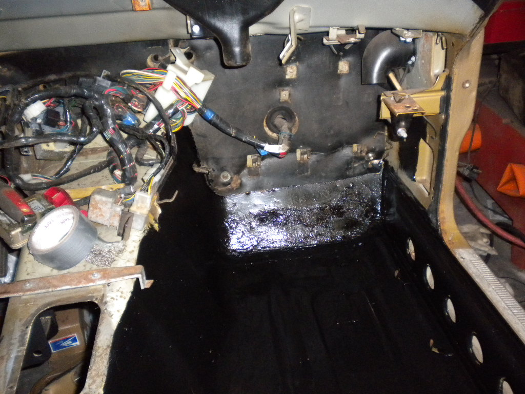

The 2nd 2) show the Duplicolor Truck Bed liner over the POR15 and welded holes. I cut out the rust and weled in Patch panels, then undercoated the under side, then was able to POR15 the rusted area's then coat the whole floor with the plastic/Rubber truck bed coating. It's basically a Pool Liner now. Water will never touch bare metal on these floors.
And as soon as I have the Money, I'll be laying down 76 square feet of Dynamat Xtreme on the Floors, firewall, back wall behind the seats, a little inside the tool boxes, the rear hatch floor, inner doors using strips and outer doors using a full sheet, as well as the rear quarters and Sprayable Dynamat in the doglegs and in the lower kick panels below the doors. Sure, there will be extra weight but it'll be a beautiful thing. Quite enough to not yell over road noise and exhaust sound. Quiet closing solid sounding doors. Louder stereo due to less sound loss due to noise and vibration. It'll be like a new car. But it better be after $300 in Dynamat, spray, truck bed liner and filler in the quarters.
