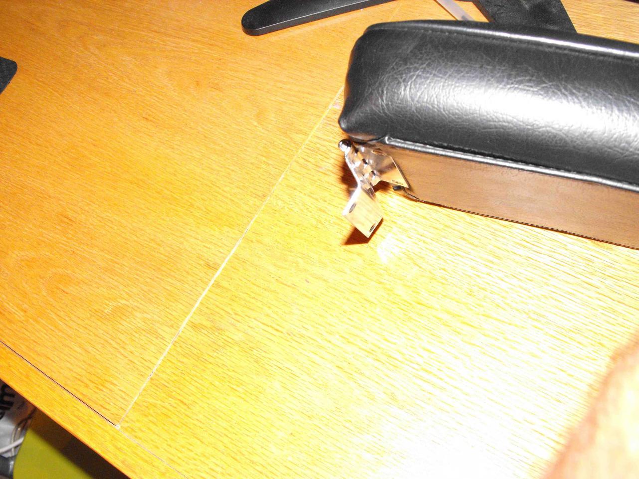

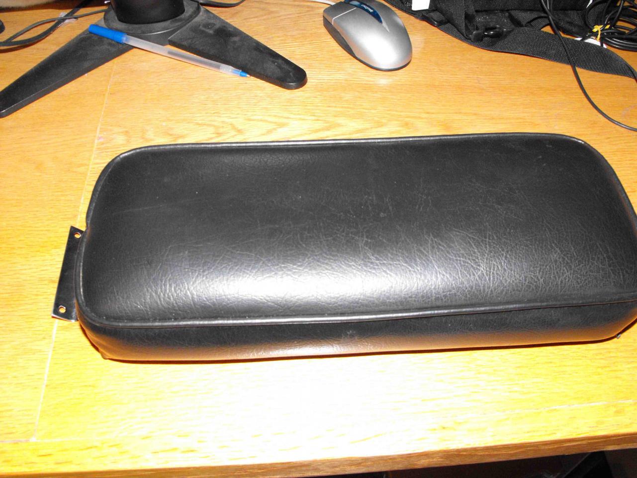

Does anyone know the history of these Center Console Arm Rests? Are they after market items? Still available?
I am relocating the pad from my 70Z console to the 71 Z console because I really like it and I drive the 71 every day. (Not to mention, the JCCS judge gave me the evil eye on my 70Z indicating it wasn't a stock part).
Also saw the pad on this photo, but this pad looks a bit taller and nicer than mine.
http://www.classiczcars.com/forums/album.php?albumid=177
Thanks,
Rich

The pad mounts on the inside rib of the console. You can see in the middle picture at the top that the mounting hinge piece has a bend to match the console inside rib. I think this is visually much nicer and mechanically better.
My dad installed the pad with machine screw and nut; no problem stripping out.

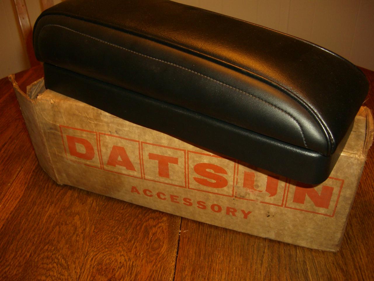

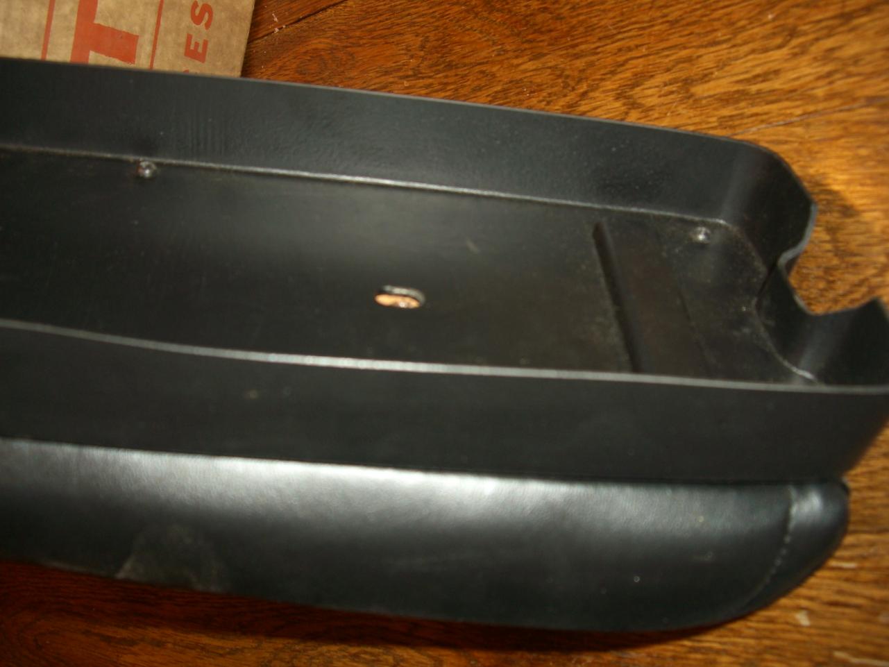

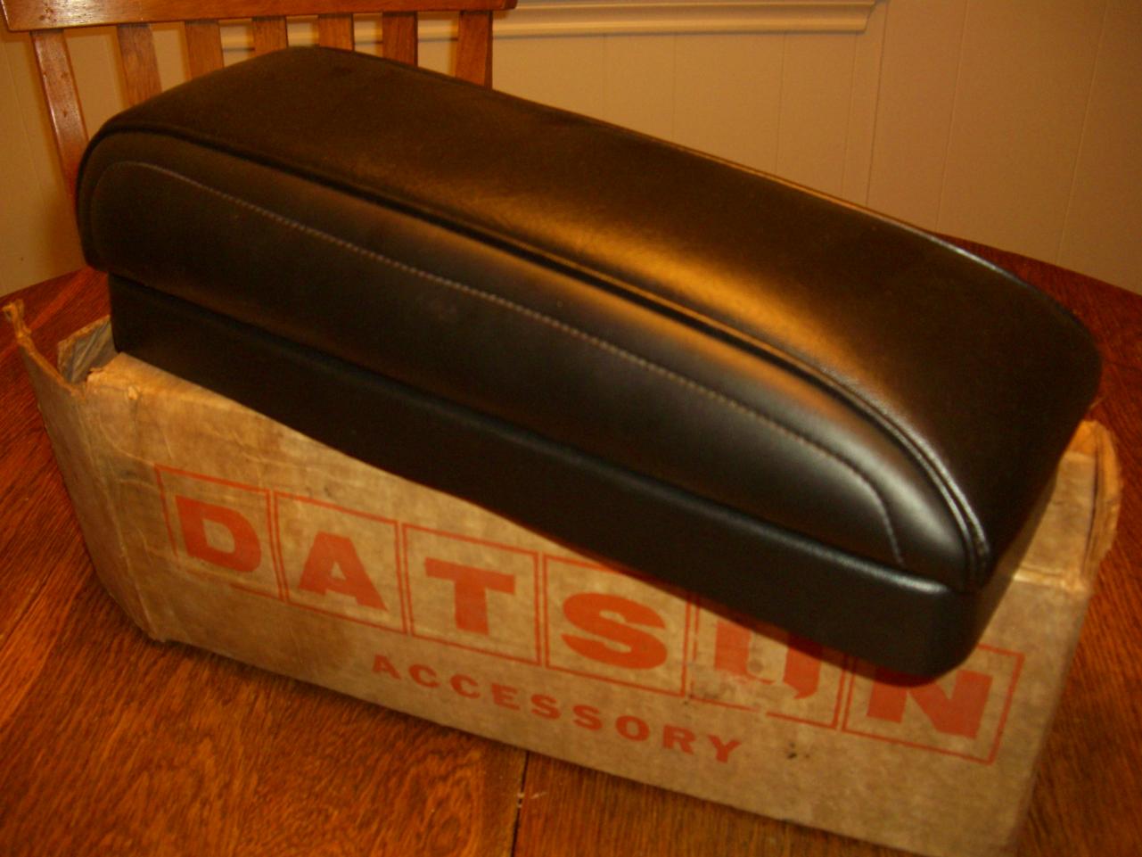

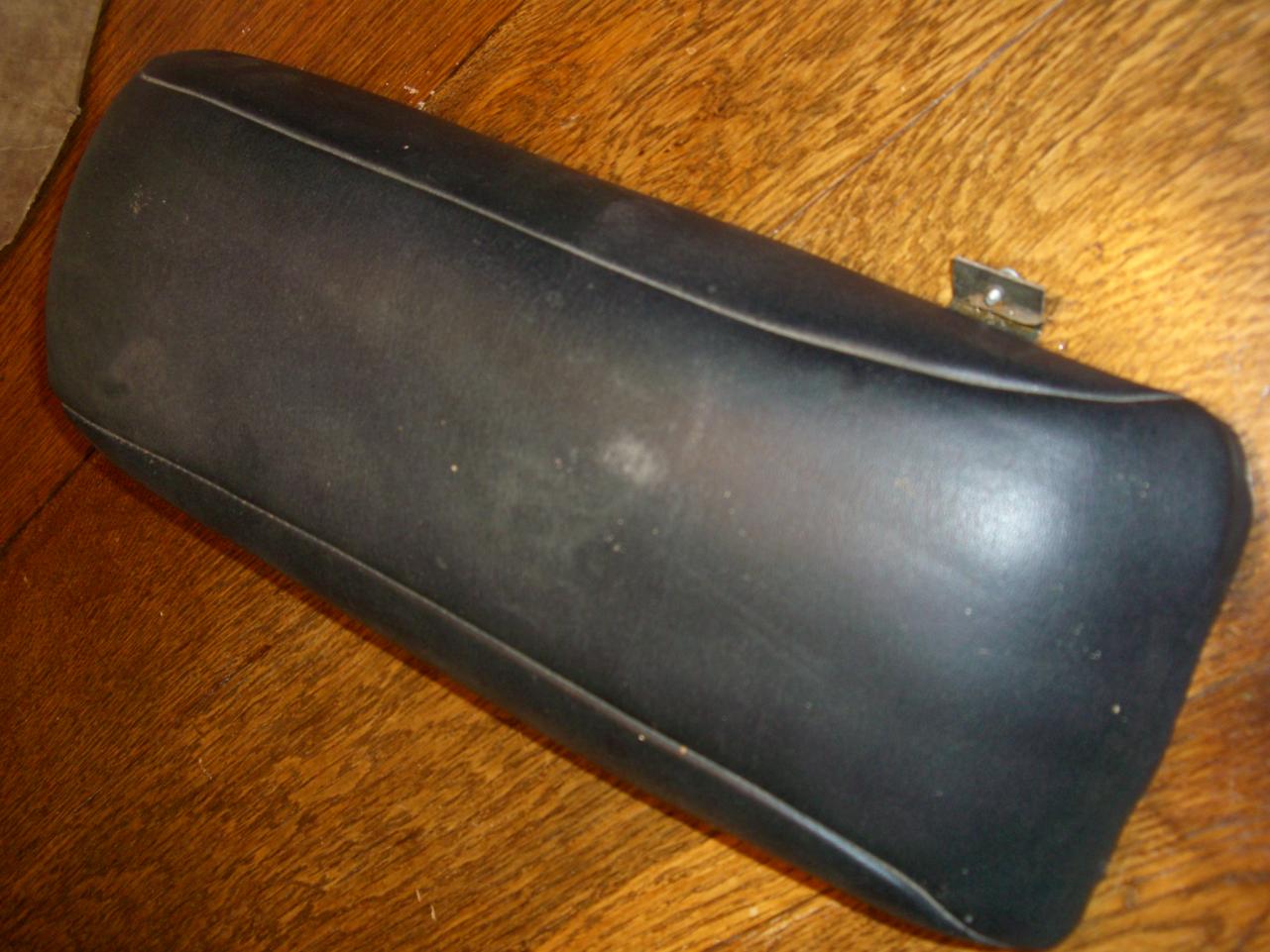

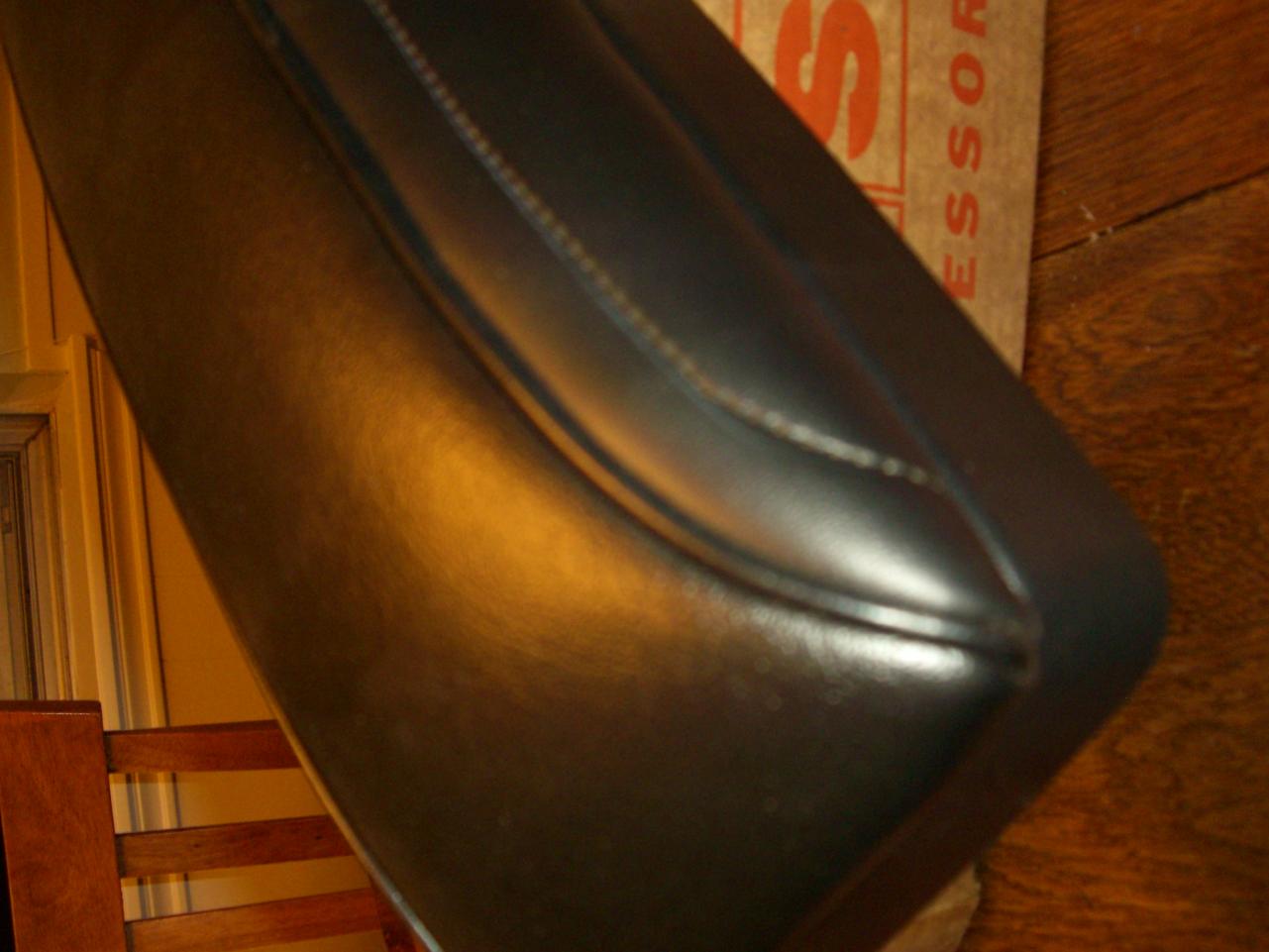

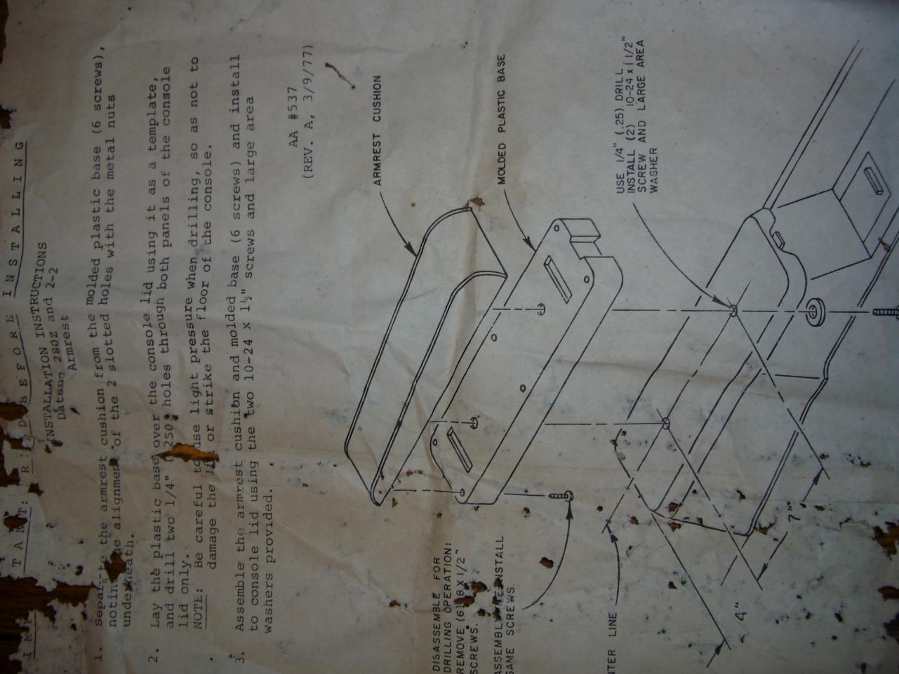

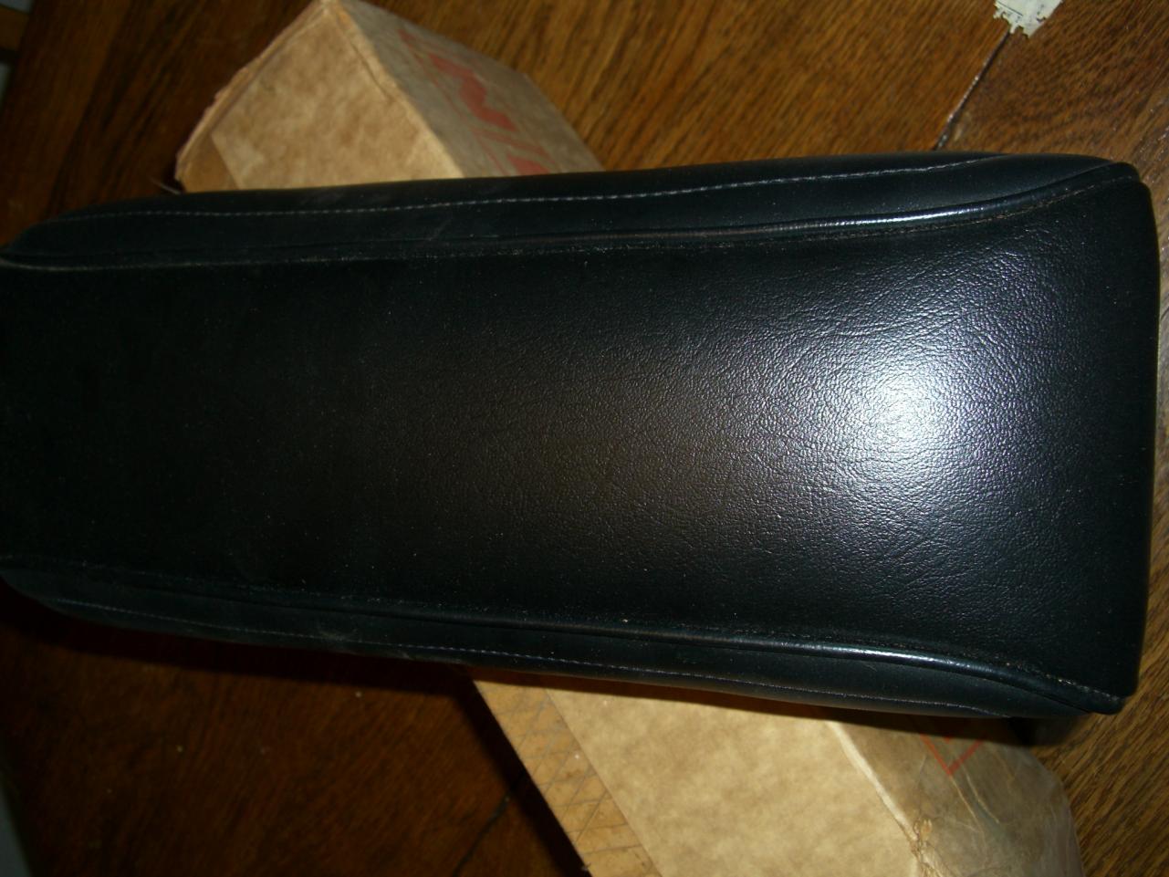

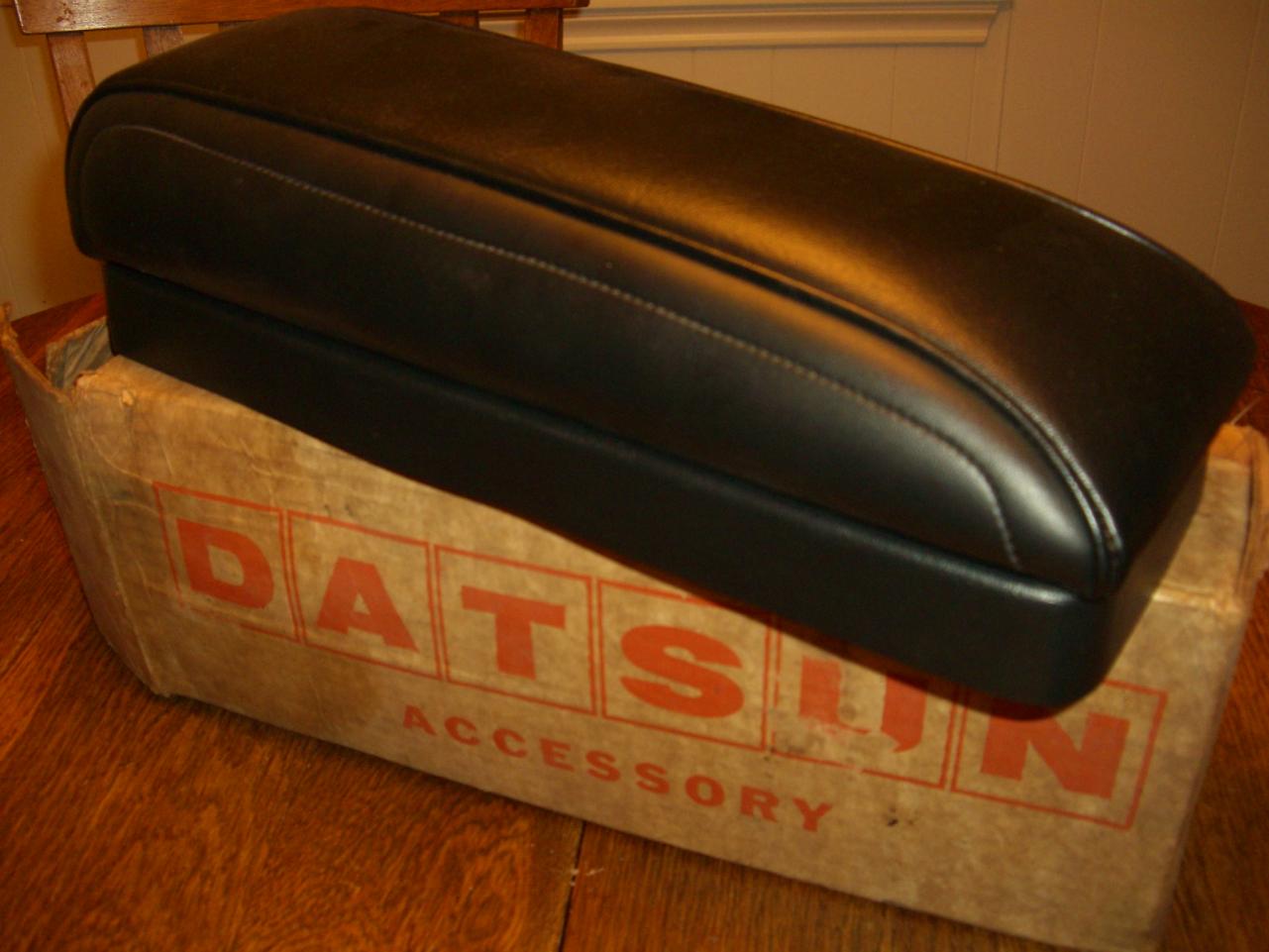

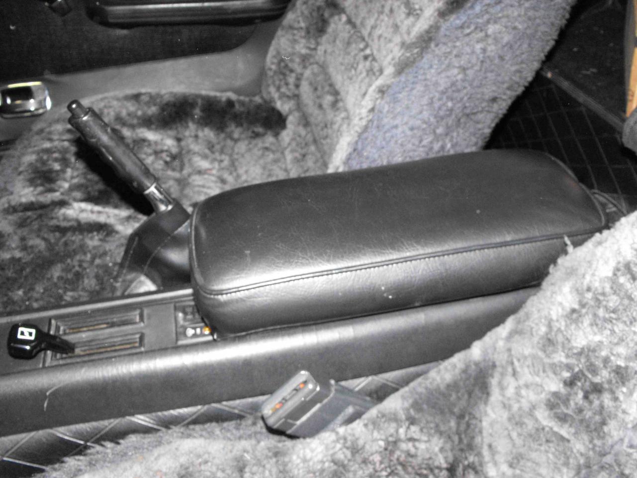

I am attaching a number of pics of my Console Pads for those that have expressed interest... I hope that this helps. I am uploading them in two posts.
