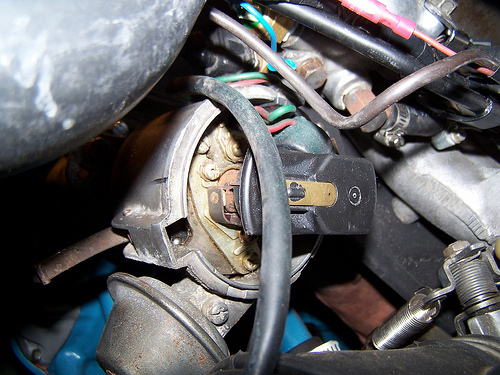

1) i thought i had timed the oil pump correctly when i first put it together, but it seemed to be off once i got the distributor back on. i pulled the pump off and we put the engine at top dead center and lined up the rotor with the mark for 1 on the distributor body. as far as i can tell, it's timed.

i checked the oil pump again and took a photo of the rotor (see attached). the engine is definitely at TDC, the lobes for the first cylinder are up, the rotor is lined up with the timing mark. i don't think i could be any more certain that it's timed correctly.
