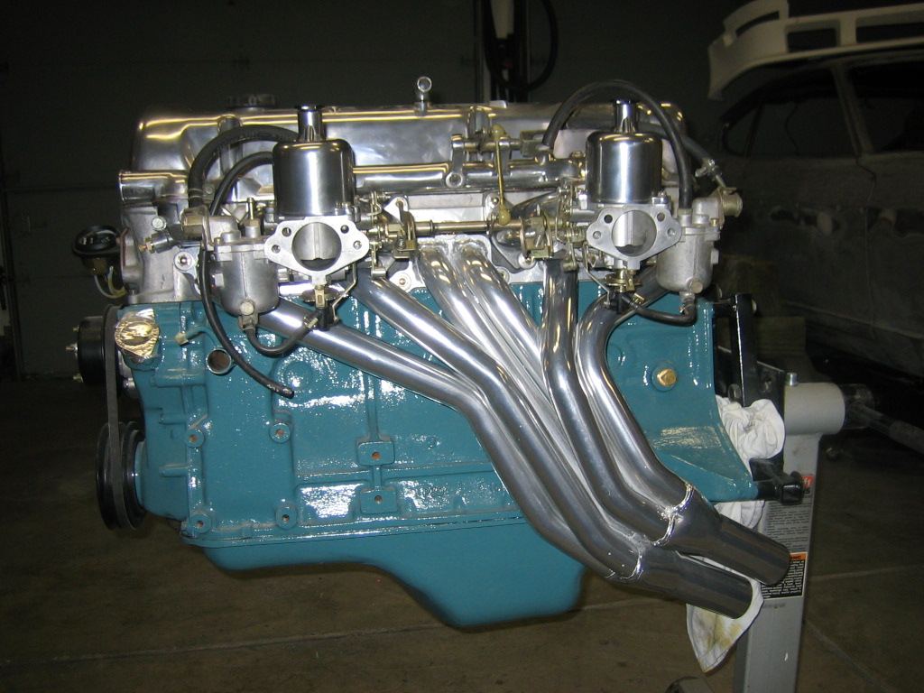

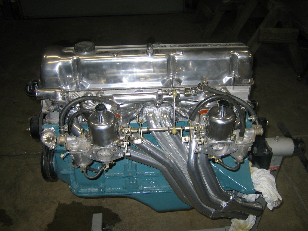

Heres what my set-up looks like before it has been run. Those pretty carbs would look great next to a ceramic(shiny header). Be advised, I was told by a friend and verified thru research that you don't want to dial in new carbs with a freshly coated ceramic header. A bad fuel mixture will dull the finish of the ceramic and never come back. I wish I could get some Z therapy carbs, but my carbs are almost new-plus I got some mikunis for after break in.
Good luck with your carbs!
These are the essentially unchanged directions since I had the Sanderson's on my Camaro. It's true, the finish will dull and the coating cracked on my headers. It has more to do with a Mallory distributor with a bad advance curve. High egt's from too much advance really damaged the coating on my headers.
