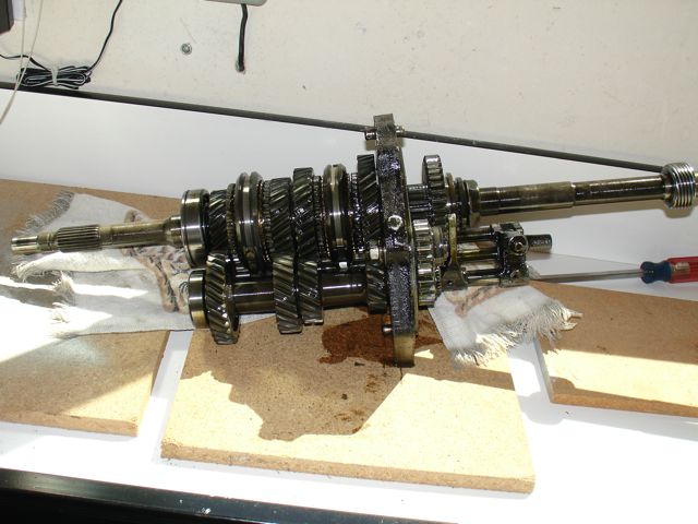

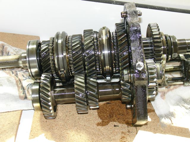

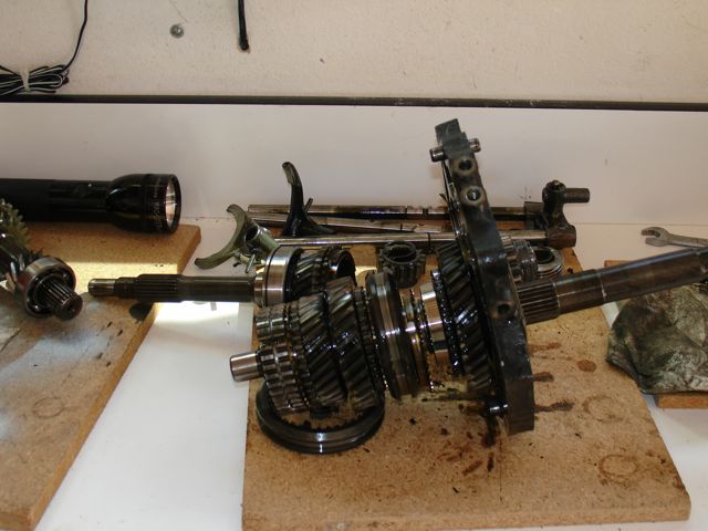

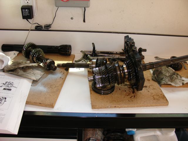

OK I have some photo of the trans rebulding. The pictures are 280ZX trans. you are talking about. You will need hand-press and big table(bench).
You need to order trans rebuilt kit that has bearings, bushings, and seals. Also syscros for all the gears to avoid feature problem.
