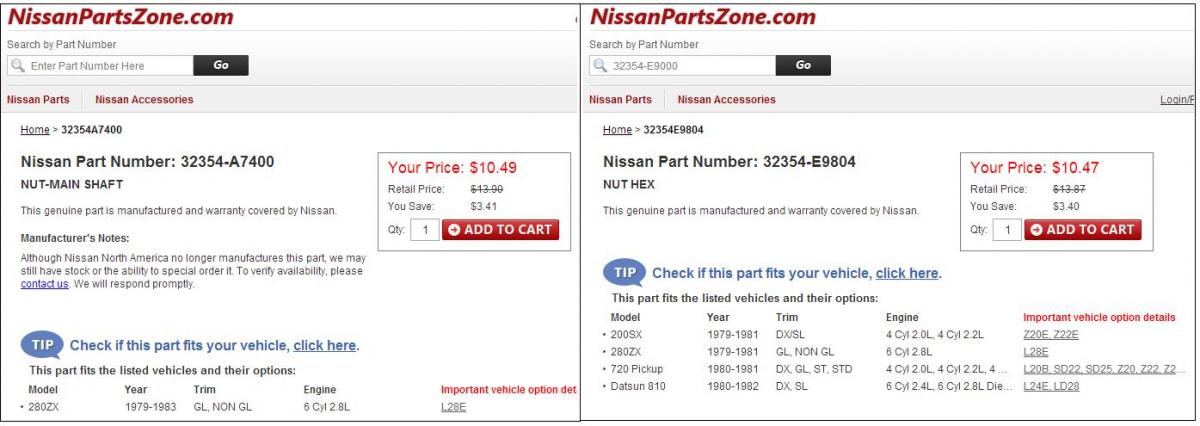

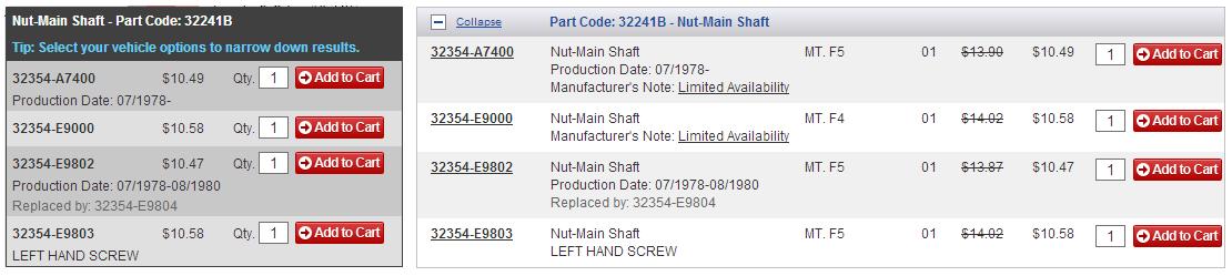

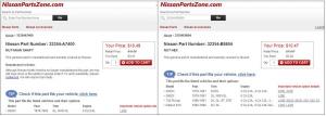

Nissan parts zone still quote it as being available, but that could change when you order it. There is a thread here with a member that ordered the LH thread nut and got a RH nut. Maybe he still has it.
I made a screen shot two years ago (left attachment). They were all available then, but now only the 32354-E9804 is "available" in right attachment.
