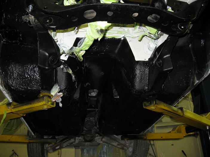

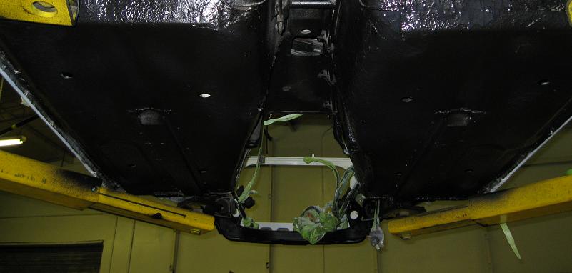

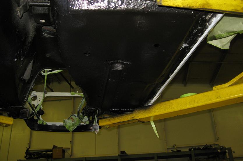

I went by the shop today to check on the Z and the painter had just finished applying this undercoating that looks alot like a rhino liner type of product.
The new floors from Zedd's were put in a few weeks ago and were covered with por 15, and the outside received this. I'm happy with it because I am going to be driving the car and it needed to be protected, but would this be considered appropriate to a purist?
What is the acceptable method for undercoating? A little late now, but was curious to what others thought.
