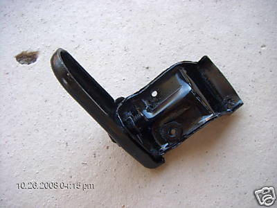

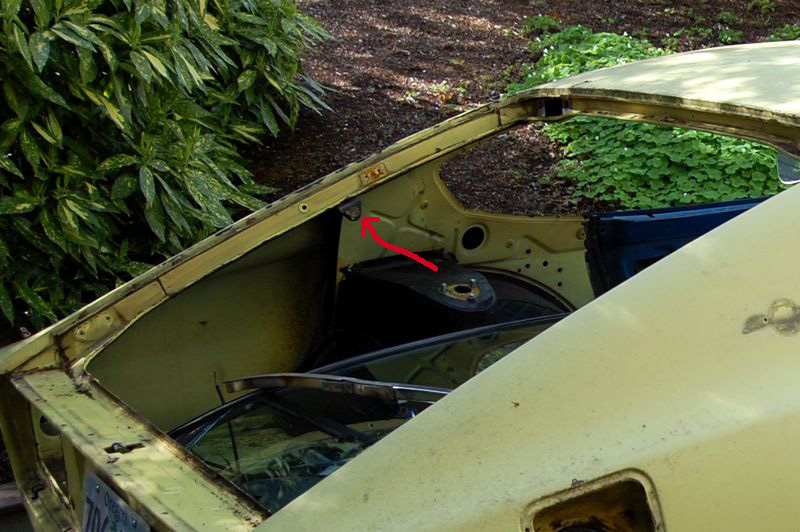

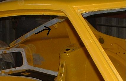

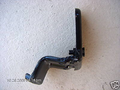

The hatch support cylinder mounts with two bolts to the hatch itself. On the body end, there should have been a mount tab welded to the body that has a single hole in it. The cylinder has a pivoting bracket that bolts into the mounting tab. I attached the only picture I could find of the body tab.
It is one of those things that i have been hunting down and finally got one, loads of pics here.

havn't seen the bracket sold by itself. Mine actually just popped it's weld over the weekend and came off. I was able to clean it up and screw it back into place through the hols where the weld was alond the drip rail in the hatch. If you do not have the bracket at all the only thing I have seen receintly is...Zeddsaver selling this on ebay.
