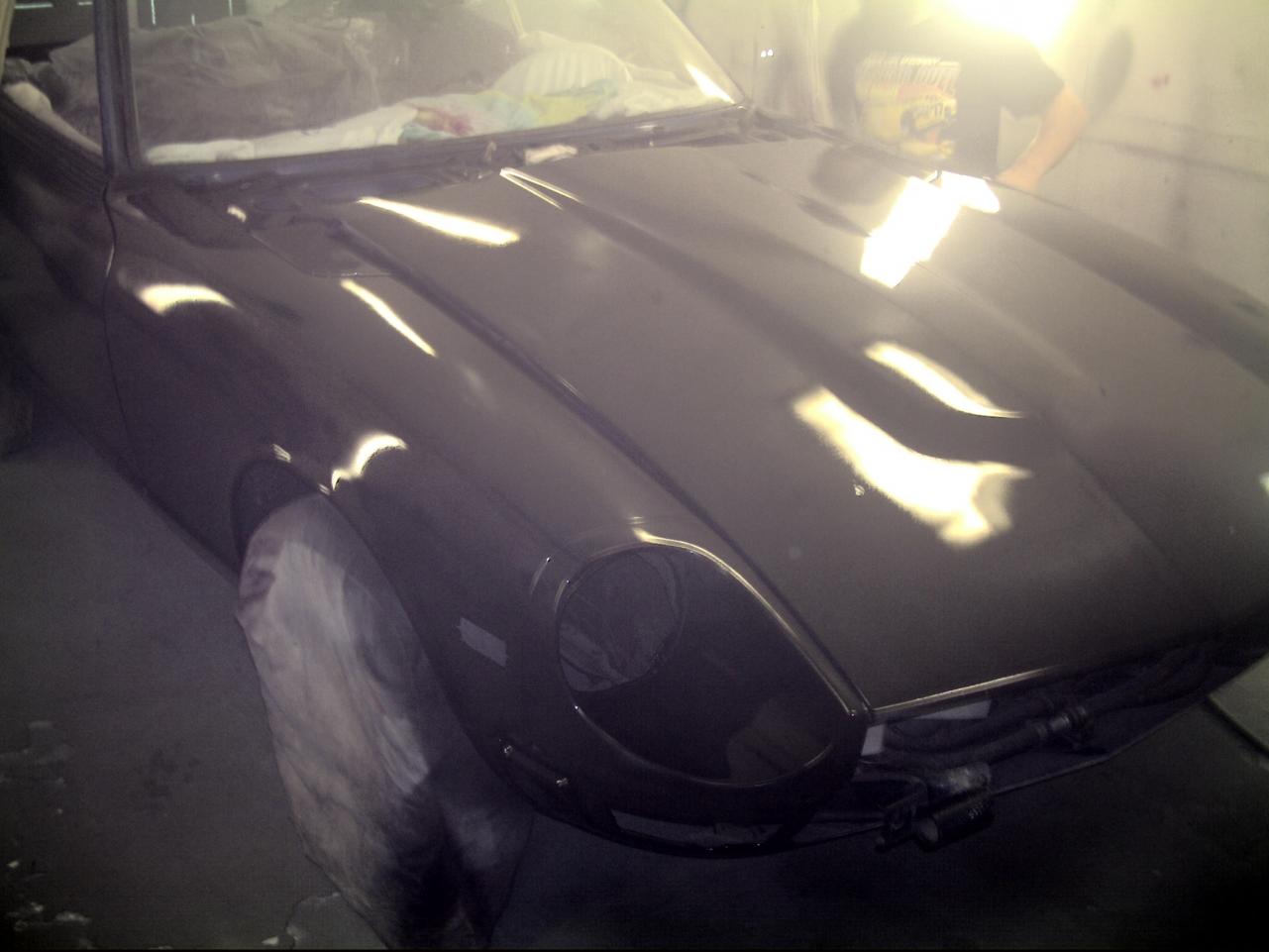

My center and right ones are fine, but I'd like to get a new left filler. Thanks for all the input guys. I'll keep watching and checking around. Meanwhile, here's a pic of the car in its sealer coat. Color should go on next week.
