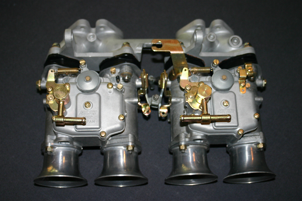

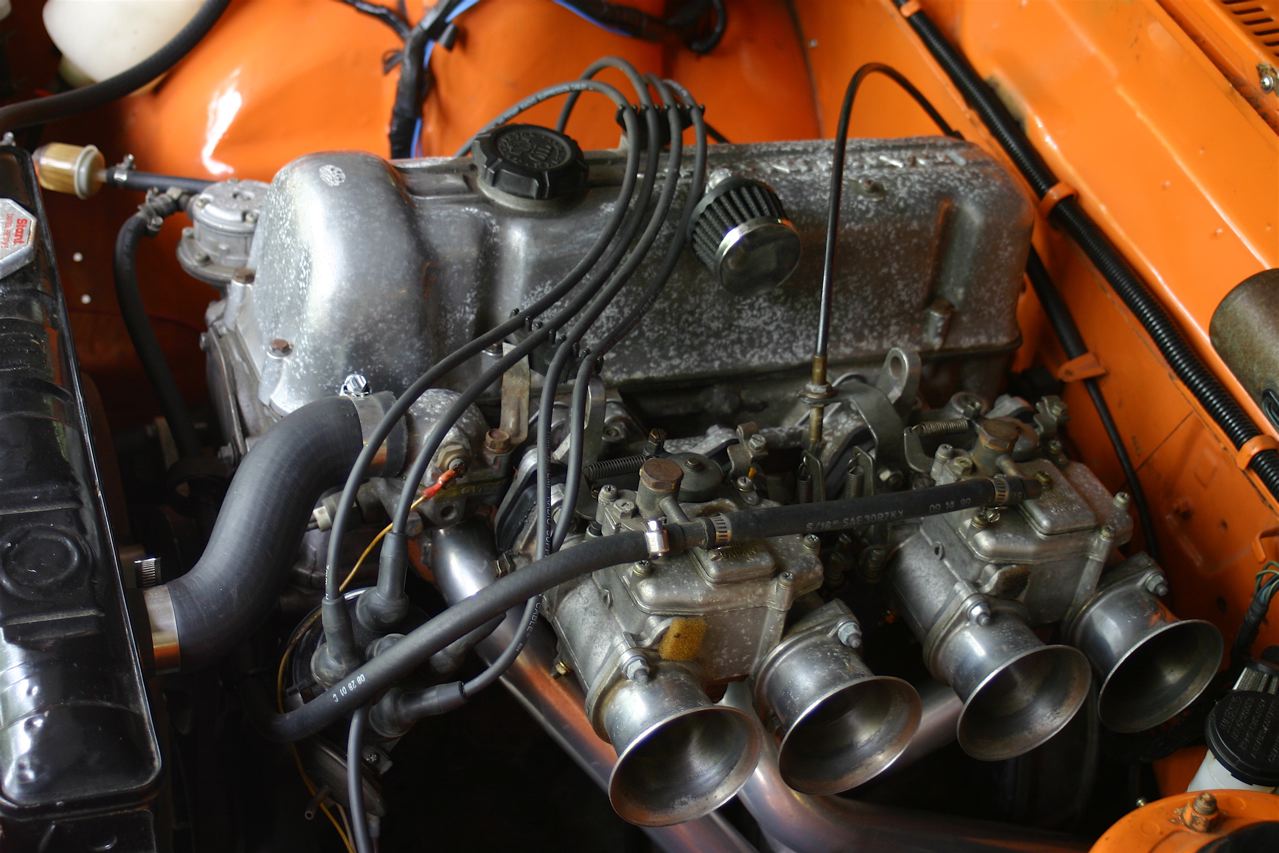

Here are some photos before and after of mine in my 510. He blasted everything and put new cad parts on :)
He is very fast on turnaround as well.
