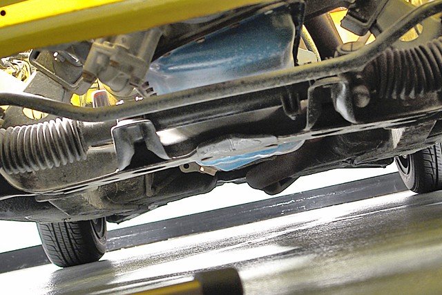

Why didn't they do the under carraige? Anybody spending that much is going to look under the car.
