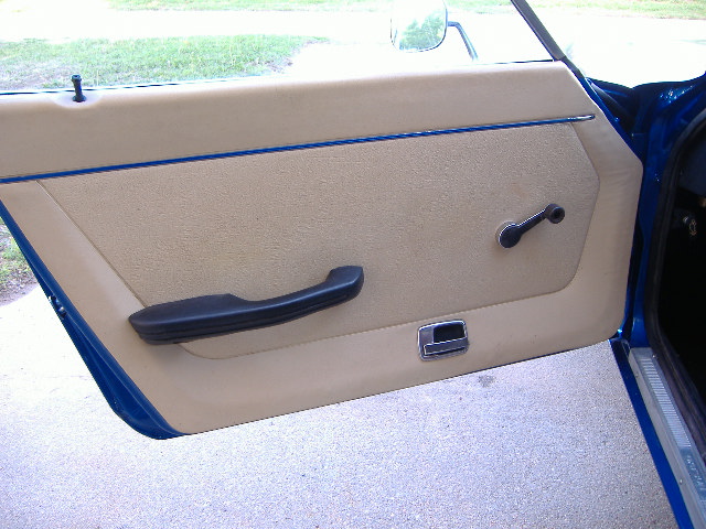

The blue plastic that is under the chrome matches the exterior color, so I removed all that would come off safely.

David, the process you cite is what gets used for HARD plastic "chroming" and not the vinyl strip on the doors. Vinyl striping with this type of "coating" usually gets it's film covering applied immediately after the vinyl tubing has been extruded.
The door panel vinyl strip is therefore, already "chromed" on it's surface before it gets welded (possibly Ultra High Radio Frequency weld as that doesn't involve a hot press) to the base vinyl and hardboard. This is done with a large machine that presses down on the vinyl strip and the vinyl covered hardboard and "zaps" it into place. Look at your door panel and you'll note a distinctive weld flange at the junction between the door panel vinyl and the tubing.
The vinyl strip can lose the "chrome" film for a number of reasons. Most commonly due to the heat expansion and cold contraction differences between the vinyl tubing and the film.... minute, but present. Add to that the subtle differences in the adhesive coating on the film as the tubing and film were mated and you have the future potential for them to separate. The film is THIN... thin enough to resemble a decal, which it basically is.
Once the film separates ... anywhere... it starts peeling. The difference in the strength of the adhesive (after 30+ years) and the film's strength is what keeps part of it from peeling, while other areas don't.
While the typical tubing on the door panels after the chrome film peels off is a nice semi-transparent blue, I have seen pale amber and even a "green" tint.
The repair or replacement of that vinyl chorme strip depends on it's condition. I have been able to re-film the strip with what I consider acceptable results. The link I gave above shows panels 3+ years AFTER they were re-installed on the car. The car, while not the exclusive Daily Driver, is the preferred vehicle of choice by the owner of that car. As a result it has seen sufficient traffic to "pass" a "beta" test.
The problem in offering this "service" is in the shipping both to and from. However, with "used" panels at $185 each (making it $370 for a pair), it might be an alternative. Especially if your door panels are in good shape and acceptable ... except for the chrome vinyl strip.
