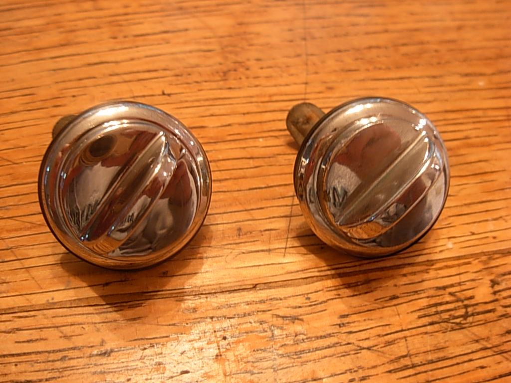

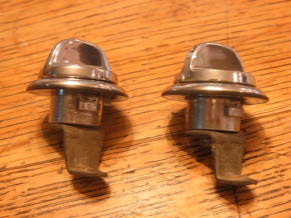

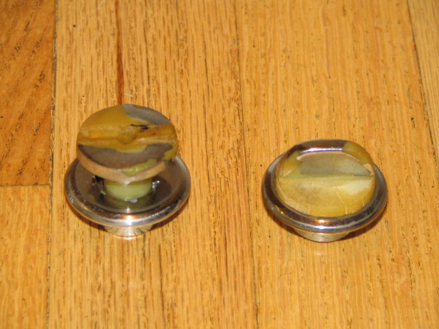

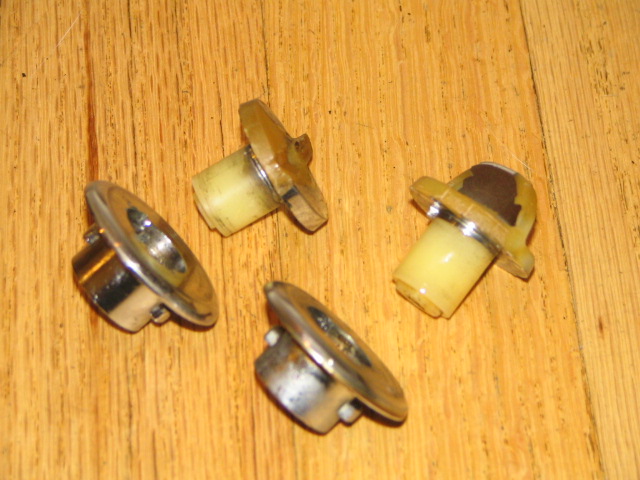

Anyway, the plastic knob that was on HLS30-00331 when I got it was broken off down to the base. See the attached before photos. Rather than just throw it away I wanted to see if I could repair it. I used an unbroken original I have to make a mold using POR15 epoxy putty. Then I made a small "T shape using a piece of coathanger wire and epoxied that into the middle of the base. After that cured, I put some non-stick spay into my mold, filled it with the epoxy putty, and embedded the base with the "T" wire into the putty. After a few minutes I gently worked it free of the mold and it had the rough shape I needed. Then I blended it down into the edges of the base and shaped it some more with my fingers. After it dried I sanded it with several grades of sandpaper to finish shaping and smoothing it. The epoxy bonded to the base very well. I tried twisting it pretty hard quite a few times and it never had any issues.

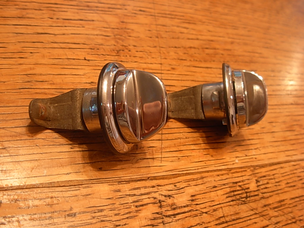

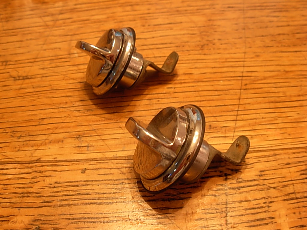

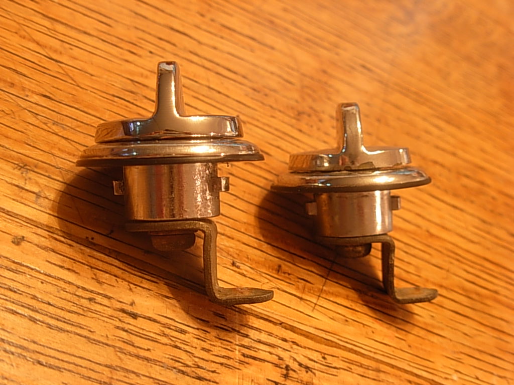

I sent the repaired knob to out to be electroplated with my plastic taillight trims and some other items that I just got back. I think it came out great. I took a few comparision pics to an original knob I have. My repaired and rechromed knob is on the left. The chrome is heavy duty, much better than the original factory finish. Unfortunately, I can't find any of the "in process" pictures I took, so all I have are the before and after shots.

Thanks Arne. I was very happy it turned out so well. That epoxy putty is pretty amazing stuff. I'm not sure if the POR type is better than any other, but it worked great.

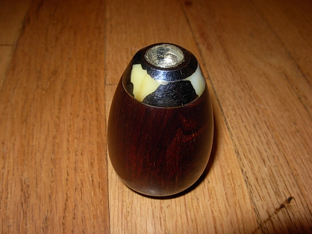

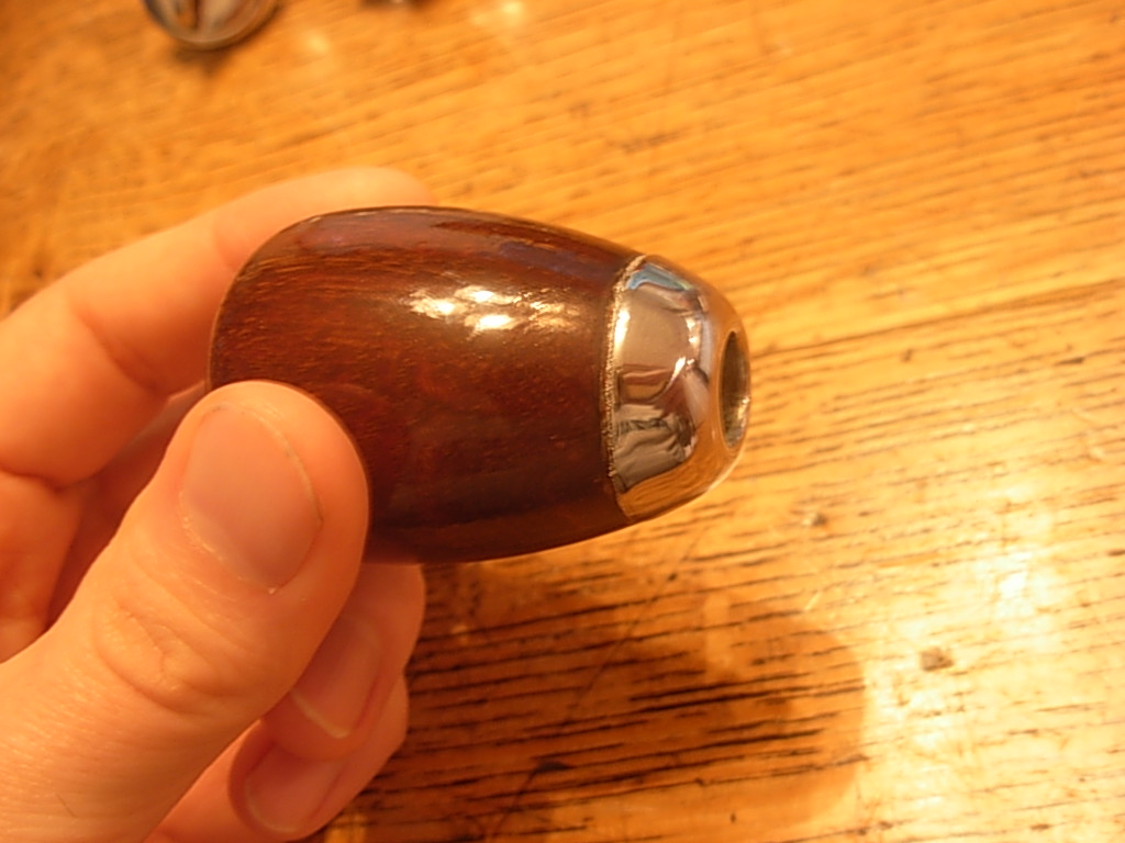

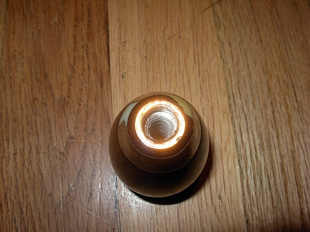

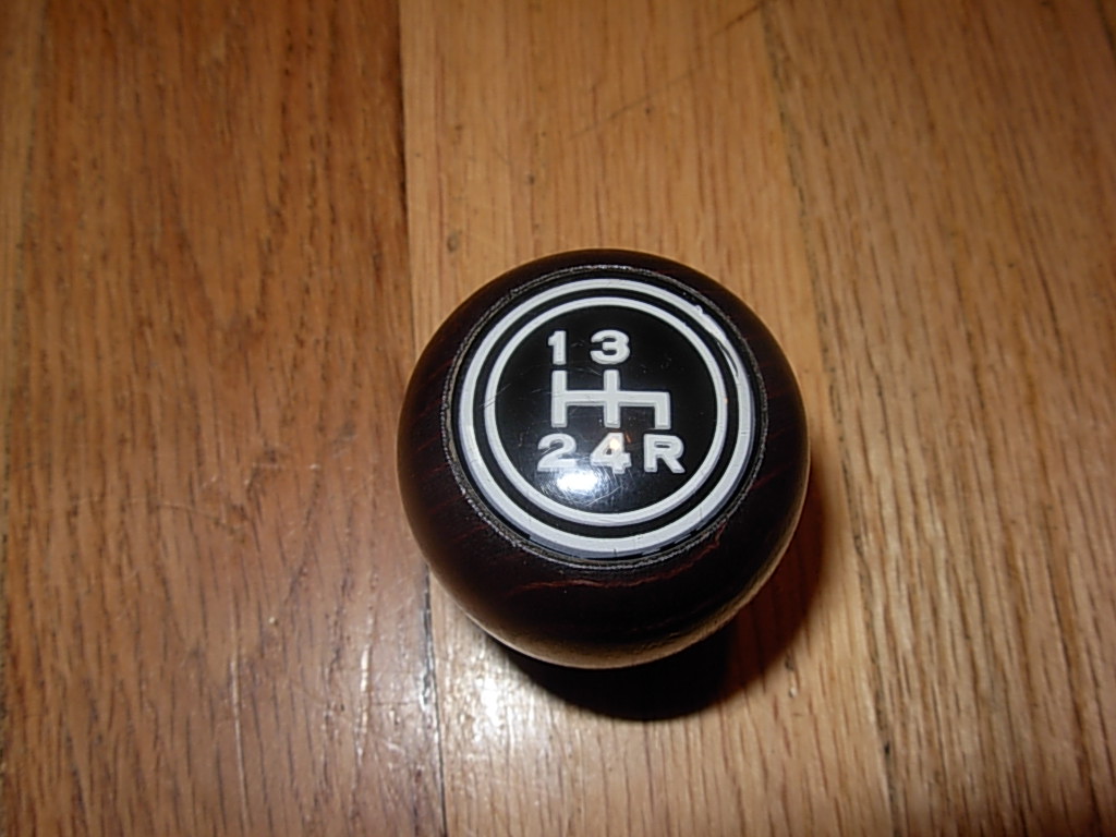

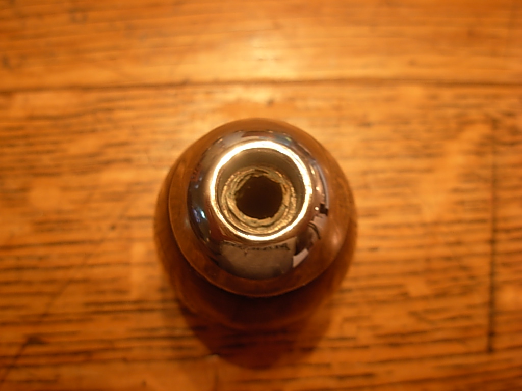

He also replated the plastic base of my shift knob from #32. Here are the before and after pics.
