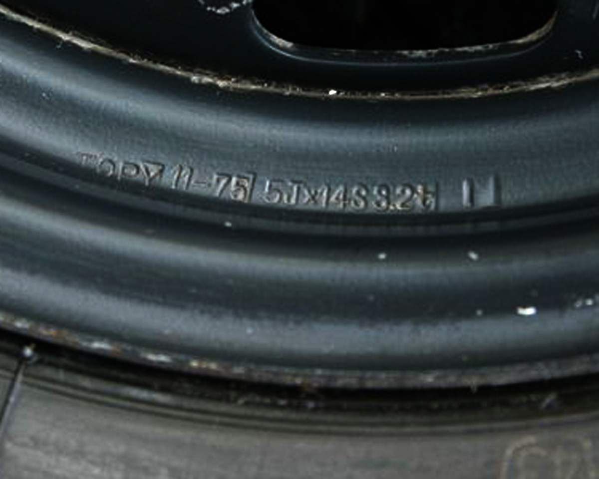

OEM wheels on the Datsun 240-Z from Oct. 69 until the 1972 Model Year - were 14" x 4.5". The 72's came with 5" rims.
All the OEM steel wheels are stamped with the production date and rim size. Normally the information is directly across from the valve stem.

In addition to what Carl noted, wider steel wheels were theoretically available from the dealers' parts department but never came factory installed. The wider wheels were 5.5" wide, and were part number 40300-E4600, list price of $13.50 each in 1971. They would have looked identical to the normal 4.5" rims, and all of the same markings (as described by Carl) would be stamped. I don't know of anyone who has seen a set of these early 5.5" in person, however.

No - the OEM styled steel wheels were 14"x5" from 1972 model year through the end of the 260Z's in North America in 1974. I don't know about the 280Z's - but I haven't seen any OEM steel wheels that were more than 5" wide.

Although this chart does not have a specific column for Canadian models, the publication it comes from has provisional coding covering them when applicable. The Canadian models had the same wheel size - 5J-14.
Arne correctly discusses the existance of 40300-E4600, a 5-1/2"x14" steel road wheel shown as optional, however I have never seen one either. It is not listed in the Fairlady parts catalog either. That catalog shows the 4-1/2" rim applicable to the L20 versions and the 5" rim applicable to the L24 equipped models. I should also note, while we're talking about stock wheels, that the magnesium road wheel 40300-E4200 was 5-1/2" and applied to the PS30 models.
