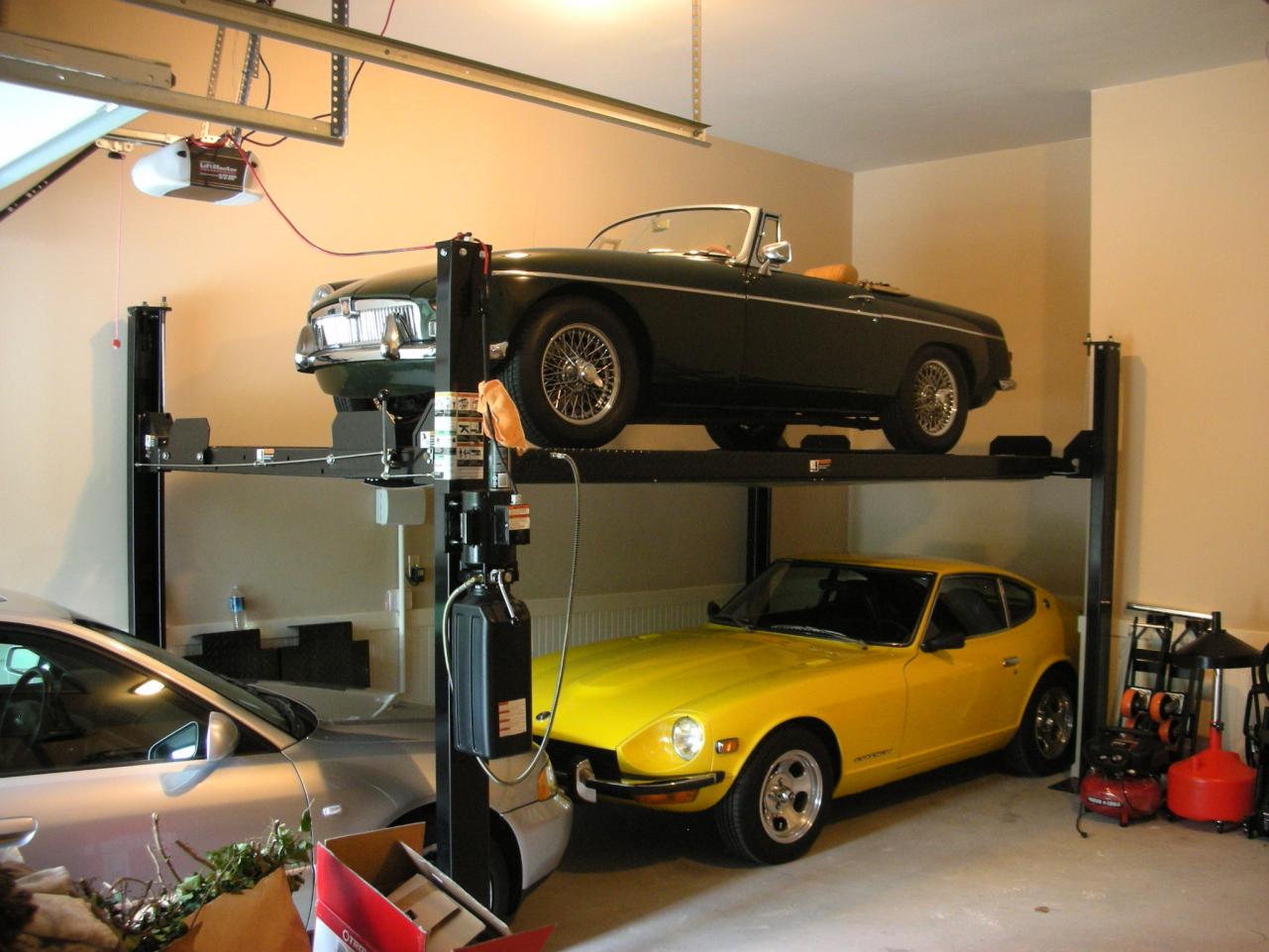

I bought my 4-post lift from Greg Smith, and am very pleased with it. After doing lots of research and looking at the specs, I could not justify the significant extra $$$$ for the BackYard Buddy (not that there is anything wrong with it) for what I am using it for. Mine is the Direct Lift Pro Park 8 Plus (which incidentally seems to work just like the BYB)
The lift I got includes 3 drip trays, a jack "tray/stand" and they threw in an oil changing funnel/drum when I asked for it. The lift also includes 4 wheels that you can attach to the posts to move it around the garage or wherever you want to put it (you can see them leaning on the back garage wall behind the air compressor next to the lift in the photo I have attached). No clearance problems, it has a great safety system to ensure the lift doesn't fall.
My garage is almost the same size as yours is Marc. I am 21' wide and 24' deep ( 27' on my side with a 3' alcove). I put mine as close to the wall and back of the garage as I could. I can put a car under it and open both doors if necessary, but it is a bit tight on the wall side (so I back in the car that will be under the lift). My wife can get her car on here side, and even with a lawnmower in the middle, still has plenty of room on both sides of her car.

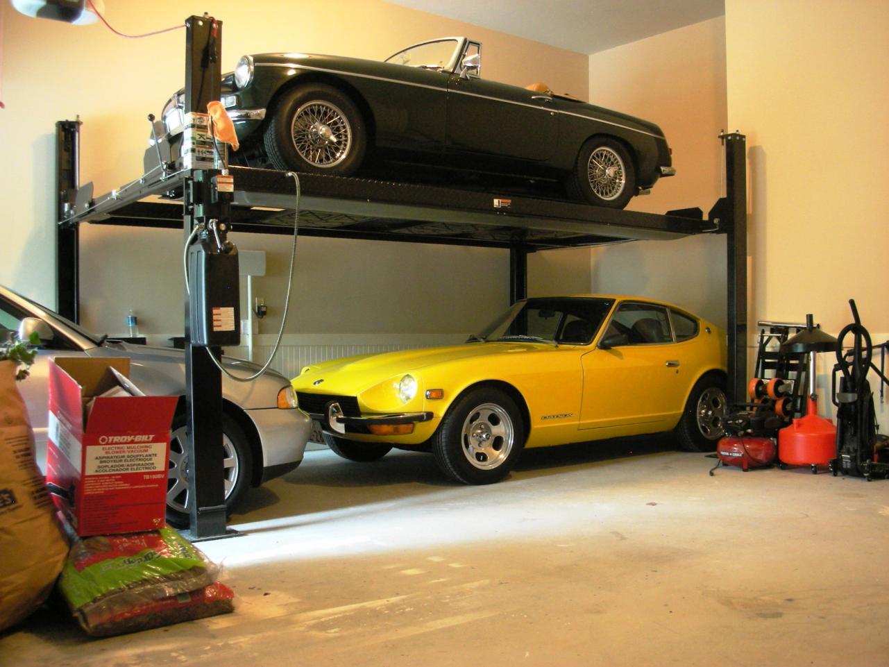

As you can see from the attached photos, I put 3 cars on my side with no problems. The garage door is the standard 8' door, and opens without any issues, and stops a few inches from the end of the lift (see second photo taken from a ladder).
I love the lift and it is great for getting under and working on the car. Be advised, you'll see lots of things you might not have noticed about your car(s) before! :) In the photos, the lift has 2 more notches and is 68" at the bottom of the ramp, and over 6' under the car).

Gald to be of assistance. Yes, the lift has the double lock system. It definately works because when we were installing it, we ran the cables the wrong way thru the first time (which made the system think the cable was broken) and the lift would not go anywhere! I like the added security - to me, anything that helps make sure that my car will not fall is a good thing :) The channel locks are good too, I just lift the car to the point I want it, then let if back down to engage the channel lock. So the lift is not dependant on hydralic pressure to keep it where it is.
I got the 110 motor, it take about two minutes for the 110 motor to go from the ground to 6 feet up. To me, that is plenty fast enough.
I like the plus version as it is higher than the standard. This means that I can put the car at 6 feet up and still have two more notches (over one more foot) to go higher, and I like that the lift is not all the way at the top where I normally keep it. I think it is more stable that way. If you have the ceiling room, I'd get the plus. If not, I am sure the standard would work just fine as well. Based on my photo, you can see that even with the standard you could keep it a bit lower for storage use (and raise to the top when you want to work on the car) and still get a car under it without a problem.
Also, I did not have mine bolted down, and it stays in place just fine.
