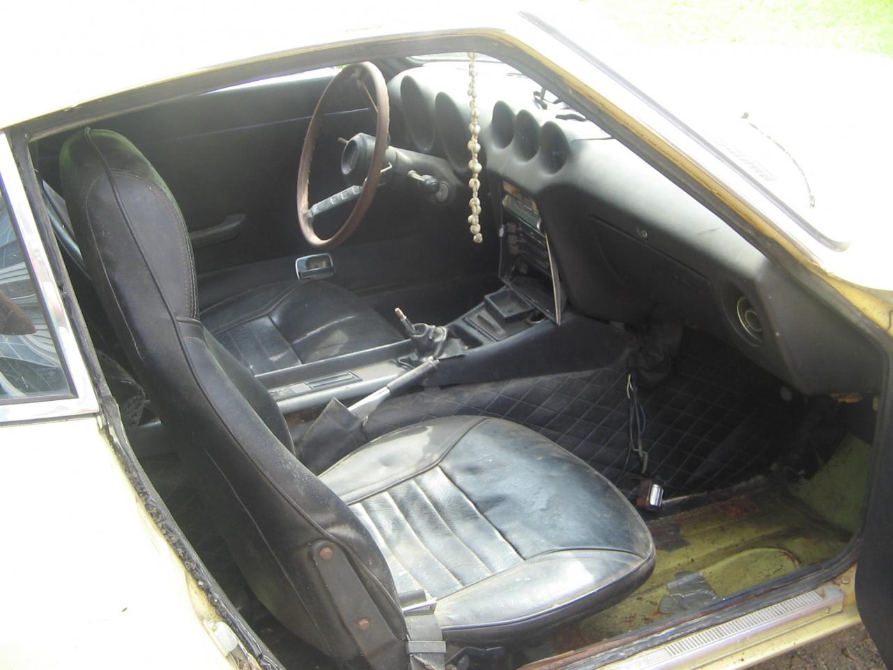

As long as you realize that you will undoubtedly have at least $5000 spent on this car by the time you're done, it's your call. Project cars are great as long as you know what you're getting in to. That's the value of having "friends" like us to lean on.:) Our combined experiences make all of us vastly more knowledgeable.
When you visit the car ths weekend, take a jack and pull all the wheels so you can check the wheel wells for rust using a screwdriver probe. If you don't know where to probe, you can look at my gallery or PM me. My original owner '72 has every rust condition known to Z-dom to one extent or another. Your potential purchase looks pristine by comparison.
I'm gong to spend well over $10k getting my car resurrected, but that's my sentimental choice. Some may gasp at my folly, but where else can you end up with a screamer for that kind of money? Besides, at 57, I'm only going to do this once.

It is really hard to say from the pictures provided. I would look at the trouble spots and asses it from there - some important things (in no particular order):
Frame rails - from the front to the rear
Battery tray and below (right to the frame)
Glass
Interior damage
Exterior damage or rust (how much and how deep)
Paint (original - if not how much work was done on the car befor)
Was the car in any accidents (I would stay away from any car that had ever been significantly damaged)
Was it used for towing (I just bought one that was - it may have changed my opinion if I had known)
Hatch sill (rust)
Door bottoms (rust)
Was the car used for racing
Mechanically intact
Floors and spare tire well
Wheel wells
(check the what to look for list in Zhome.com)
Matching numbers
If these things (or even most of them) seem acceptable or good I think I would have it picked up by now. From the pics you have shown - I like it, but it appears not to be original paint - so there may be hidden body damage that you can not see.

Anyway, for an early model car... that price isn't bad. Try to see if he'll take $1k. Just know that you'll spend at least $5 - 10k to restore her...
HOPEFULLY the engine is good for a rebuild. You want to keep the matching numbers (if they are matching).
Mike
I think it all depends on what you are looking for.That would be a 3K+ car here in new england. $1500 would be a good buy if you want something to putter on for the next 3+ years and finish as your funds allow. Like eveyone has said though, Carefully inspect the entire car so you know what you are getting into.

If you can't afford it right now - how about just putting off the purchase while you save a little more cash to start with a better car. Alternatively - you can start buying the most common parts needed to refresh or restore a 240Z now. Then get the car later - its far easier to store cash or parts than to keep a car in a garage space.
Personally, I don't see how the car pictured could be mildly "refeshed" for anything less than $15K.
i dont really need to have the car running right now and don't mind working on her piece by piece
If you want something to work on - and really enjoy doing that sort of work - then by all means go ahead and get it. It's just that it is SOOOO much more enjoyable to work with a car that isn't a rusted mess to begin with...

I'm with tibZ on this one. In Cali, Florida or Texas, that may be borderline car. But here in New England, that car is damn near cherry. But it will be costly to get her going again. I though I would just "refresh" my 73 for a couple grand when I bought it. It was in much better condition than that one, and my couple grand quickly swelled to about $6,000 in no time.
Even still, I would scoop that car up in a minute for $1,500.
AND
Mike
As you can see - many of us have different experiences. I don't see how you could get that car in even "presentable" condition for less than $10K, even if you do the body work and paint yourself.
Past that, its been my experience that once you start "refreshing" every thing leads to the next - and you'll be lucky to have less than $15K in it.
Lots and lots of little stuff adds up in a hurry on these projects.
