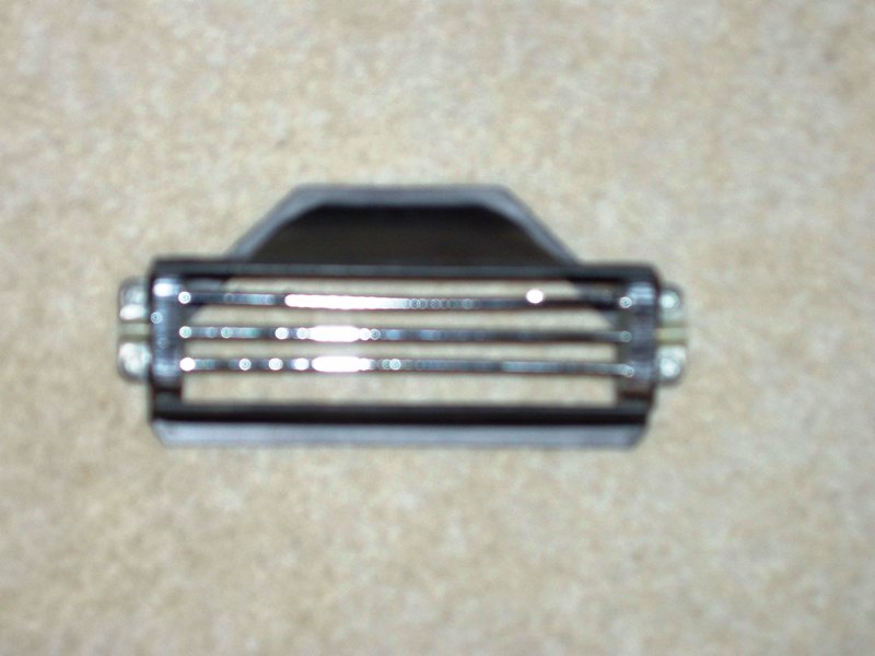

I have installed the HotRod Air aftermarket AC in my Z and am not satisfied with the air flow provided by the center vent over the vent controls. I have a 70 240Z with a later model vent that diffuses the air both to the right and to the left, but I am trying to find a vent that will help me concentrate the air to the driver. Here in Arizona the hot summers are challenging for any
AC system and focusing the air directly on the driver would add in the comfort department. I am hoping I can find a replacement vent of the same size, with louver controls.
Here is a pic of my original vent, which has big gaps and does not concentrate the air at all where I want it.
Any thoughts out there?

Sorry, E, I was showing a pic of my original vent, the one that is installed has the ribs that point to both the driver and passenger. Still not a great option. Looking for something that will allow me to point the vent directly on the driver or passenger, or both.

Thanks, I feel I need something different than a 240Z vent, not sure if later models have anything that might work. The inner dimensions where the vent/louver would go are 1 1/2" by 5 3/4". Would love to find something that fits inside and has louvers that can turn the air any direction.
