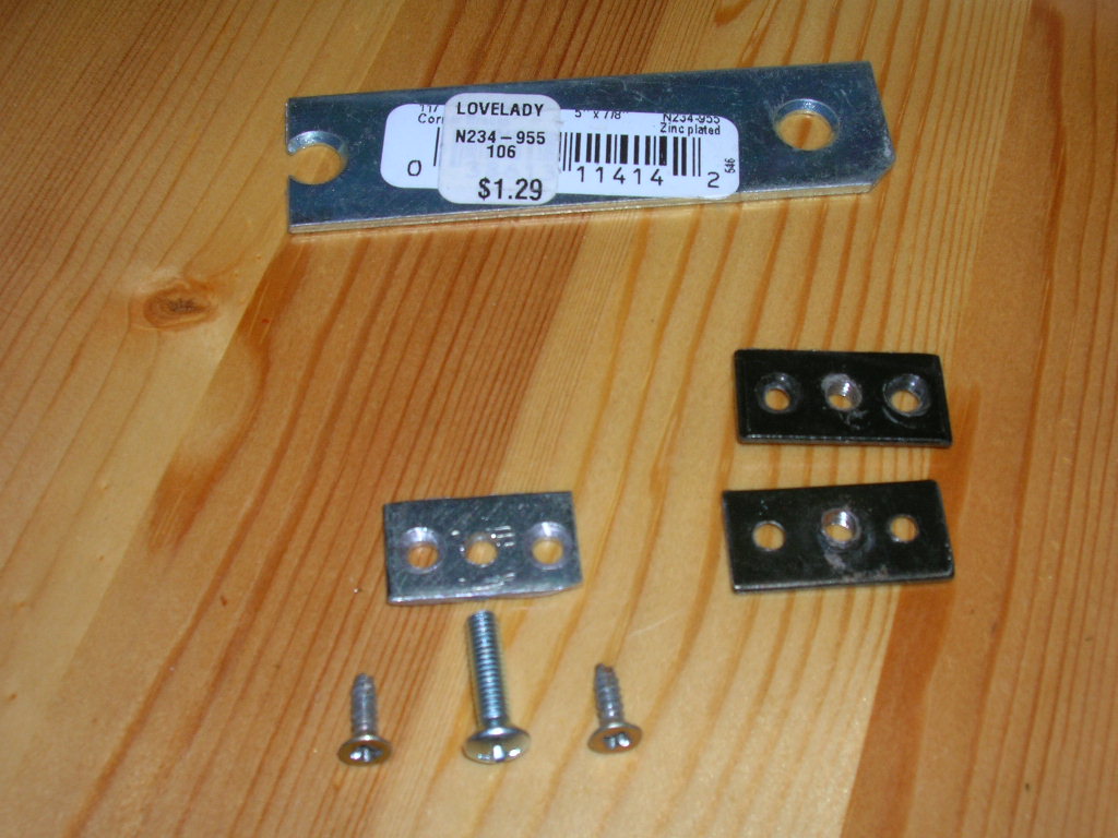

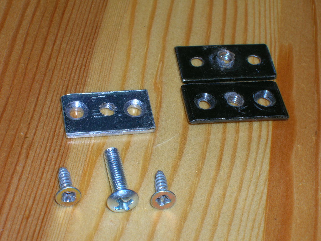

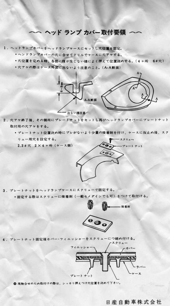

I have a new old stock JDM headlight cover that were sitting in Japan for a long time in the original box. It came with "instruction paper" so I would like to share info about how to recreate brackets as close to original ones.
As you can see, you buy a little bracket with 2 mm thickness and 1.9CM with. It is very cheap and zink plated one.
You drill out 3 holes and tap the center one. Other outer ones, you enlarge (a bit) at the enterance. Screw are regular cad. plated wood screws. (I recomend you have 73 and up metal headlight bucket!) And use round head bolts to hold the covers in place. The bolts were zink plated(not chrome) .
I just wanted to see if it was possible and easy enough for anyone.
I am interested in your repro ones so I do not have to worry about replacement after all. Since aftermarket one retails for 22000Yen(about $230) is very poorly made, and never come with hardware nor intruction paper. I hope this info could help you all.

I have a New Old Stock set sitting in the original boxes with the original paperwork to work from-all of the components are pictured in my gallery
http://www.classiczcars.com/photopost/showphoto.php?photo=12162&ppuser=4106
http://www.classiczcars.com/photopost/showphoto.php?photo=12159&ppuser=4106
and in another thread I will locate later.
I am not certain what we-this will be a team effort- will do about hardware as the original is not built to last, and is dificult to install. Using Threaded rivits would be far easier to fit, and longer lasting. I am aslo going to develop a seal kit to keep moisture and road debris out of the covered nacelle.

Totally agree with you. As far as the seal part, I found that they have little open area at front bottom part of the lense. Is it water escape area? I have total of 2 new sets and 1 used one, and they all have this 1/2 inch opening on the seal.
