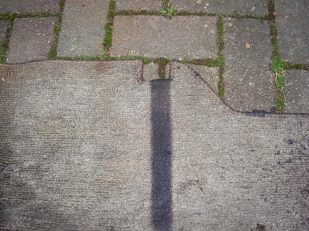

Yes, I'm talking about the notches cut into the rear edge of the deck carpet where the straps are attached. My original carpet was long gone when I got it, so I wasn't certain how the front straps were attached through the carpet (individual holes or a longer slot). Based on what was described, my 5/72 probably had holes for the front mounts but notches cut into the rear part of the carpet.

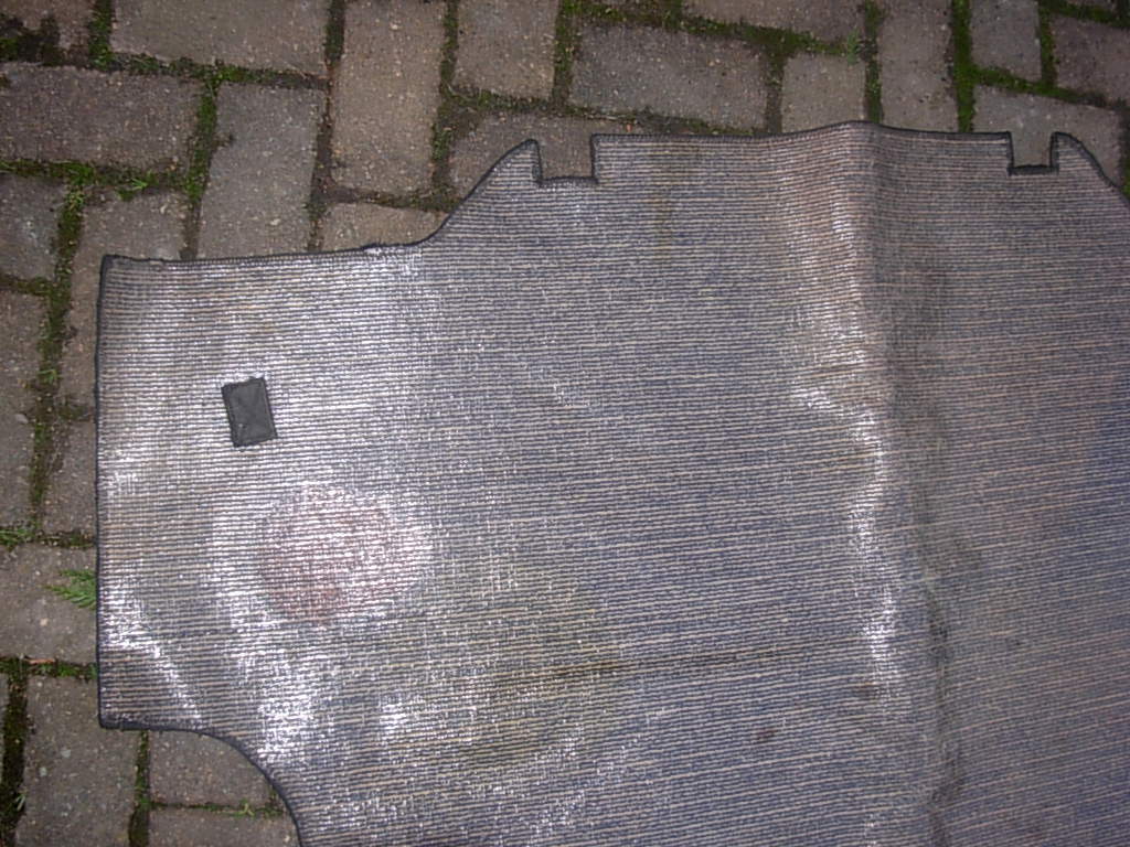

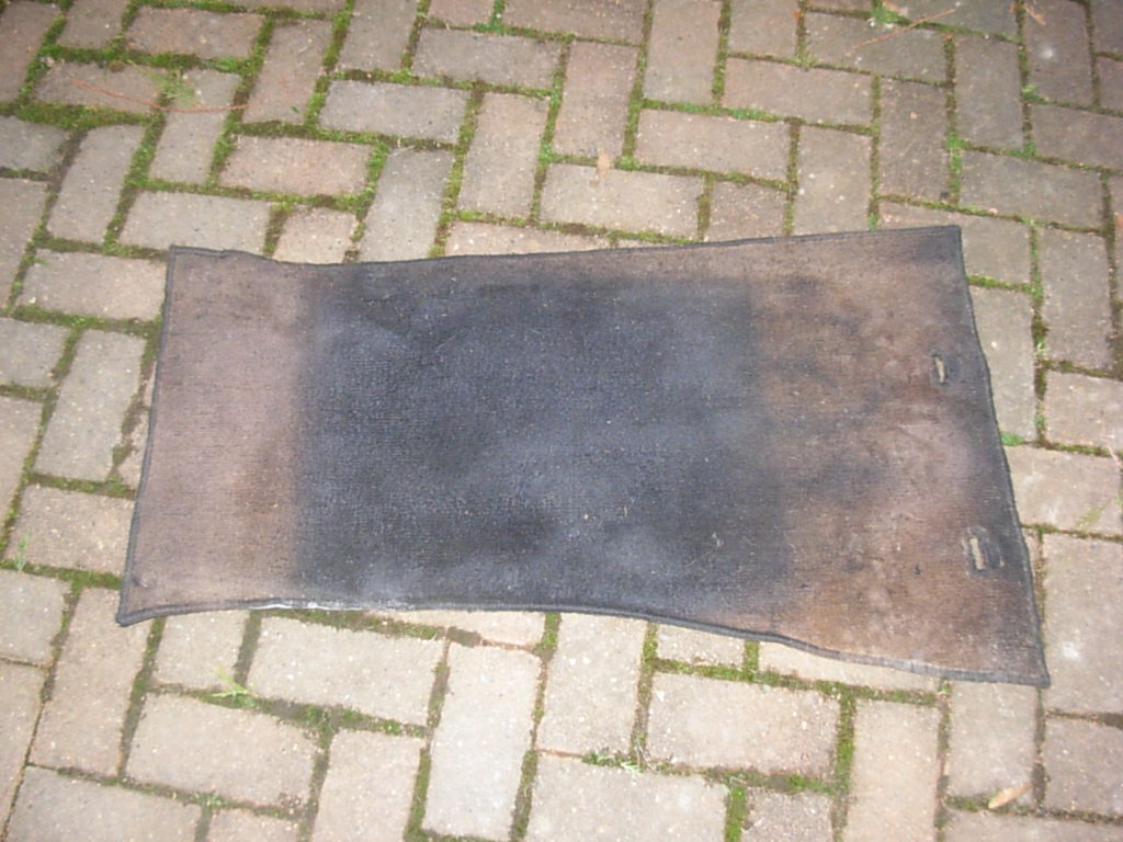

Steve, my "72" was also produced 5/72. I still have all the original carpet/jute in my car except for the drivers side front floor board. It isn't faded either. The carpet is the same style/mount as the photo's westpak posted. I pulled the car out of the garage this weekend and took some photos. I pulled all the carpet except the rear deck. I should post them sometime soon.....
P.S. My 5/72 has the (2) notches cut out in the rear (by the tail lights) of the carpet….

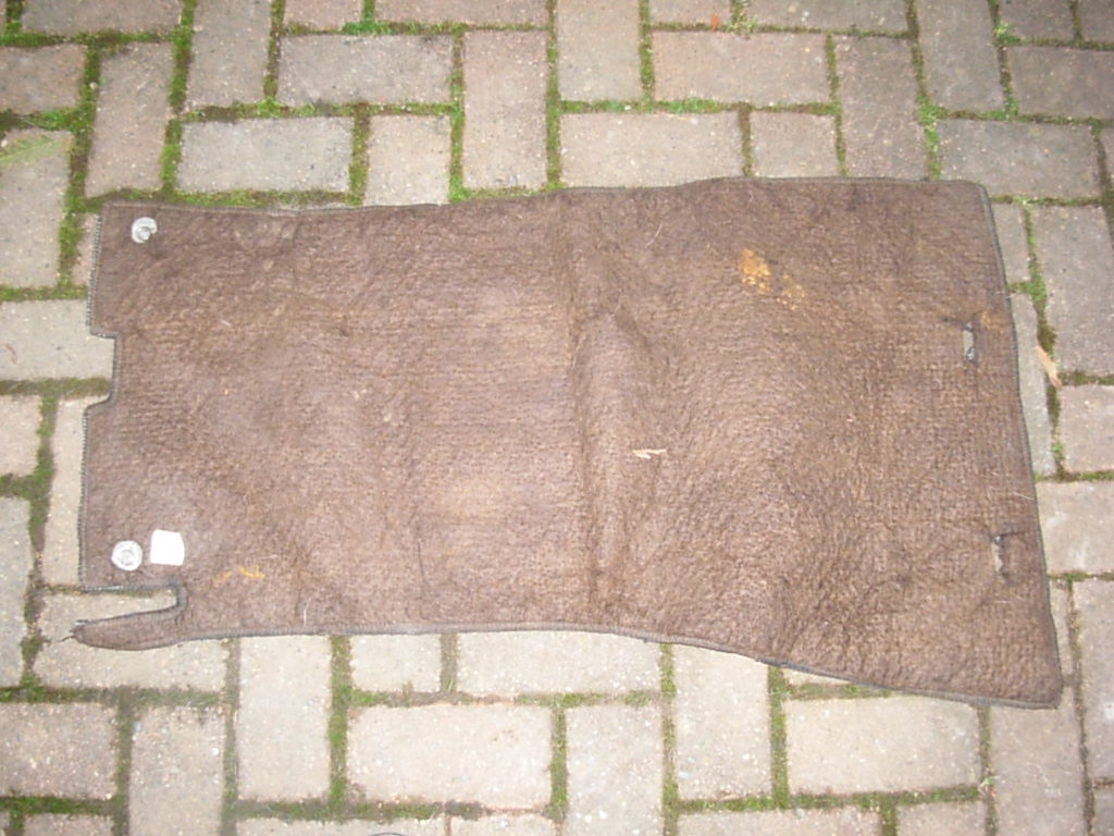

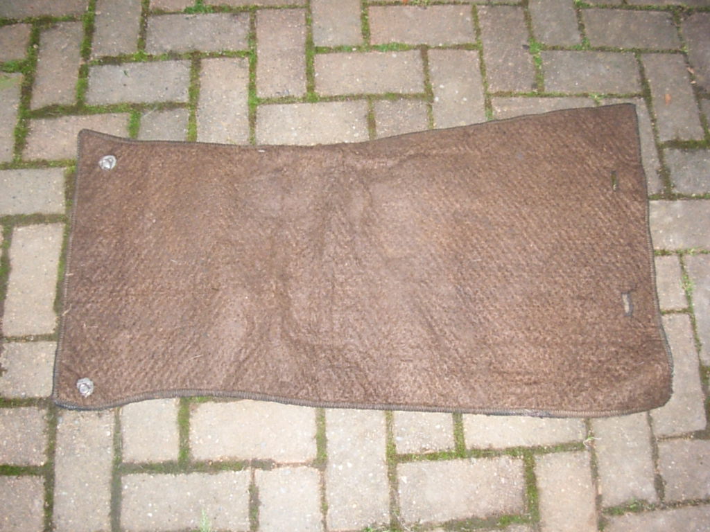

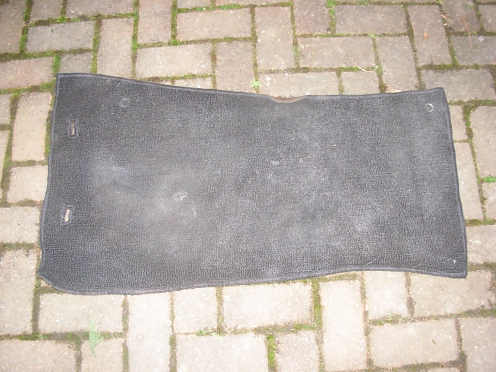

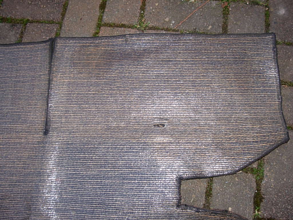

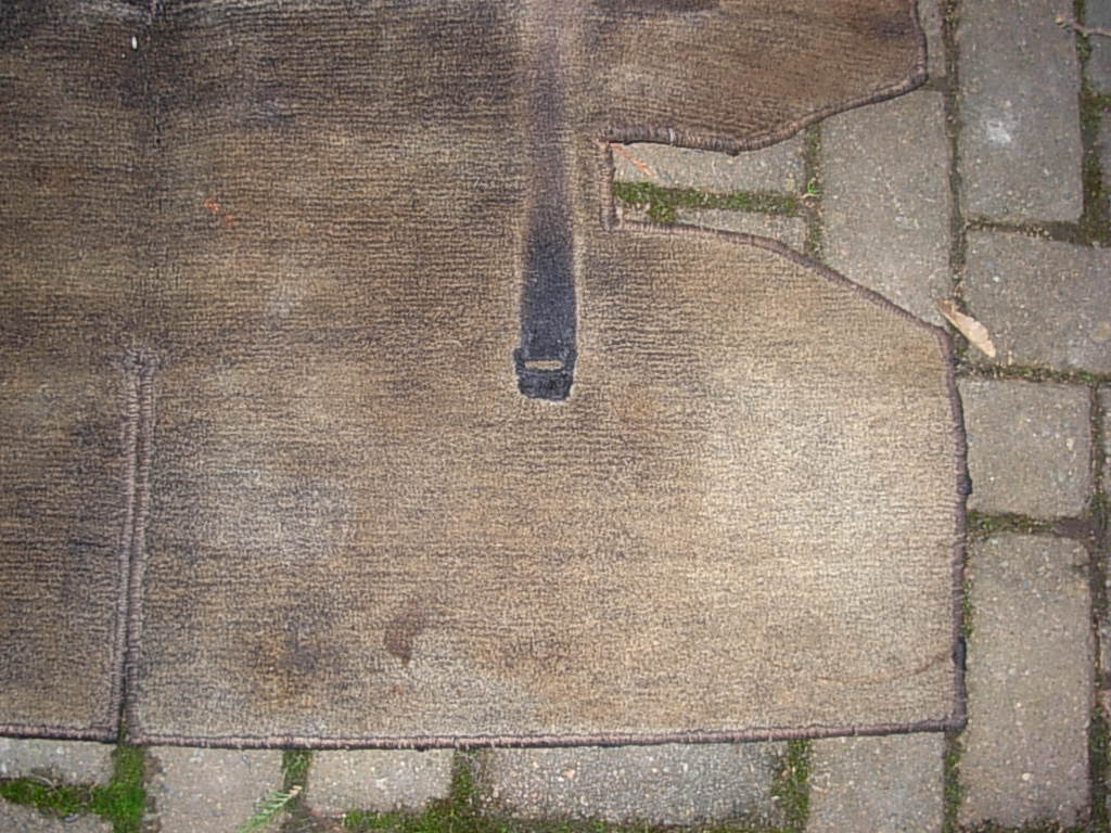

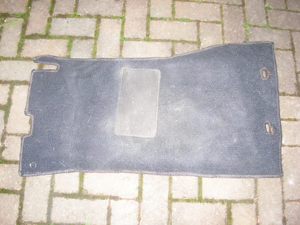

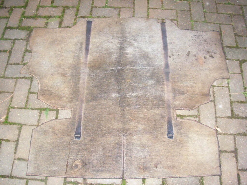

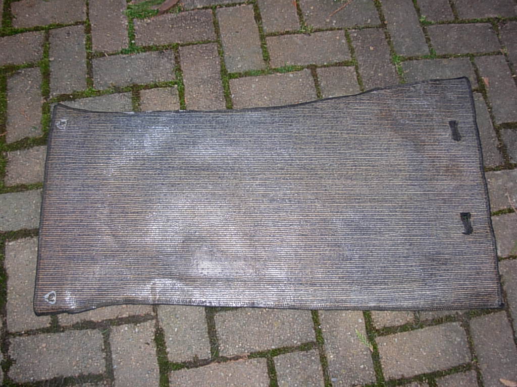

Here are 3 photos. Pardon the dirt. I never cleaned the inside and this is years of grime. You can see the screw mounts in the carpet:
My 7/70, 10/70, and 2/73 build date cars have the L shaped metal clips on the front floorpans just in front of the seat mounting brackets to hold the Metal Carpet CLIPS that I mentioned to Arne and that BonziLon provided pictures of. These protrude up through serged cutouts in the carpets and the clips installed under the L shaped floorpan clips to hold the carpet and keep it from sliding. The firewall end of the front carpet was fastened by 2 female snap halves clinched onto the carpet and 2 corresponding male snap halve studs that were mounted on the firewall insulator near the juncture of the firewall/floorpan.

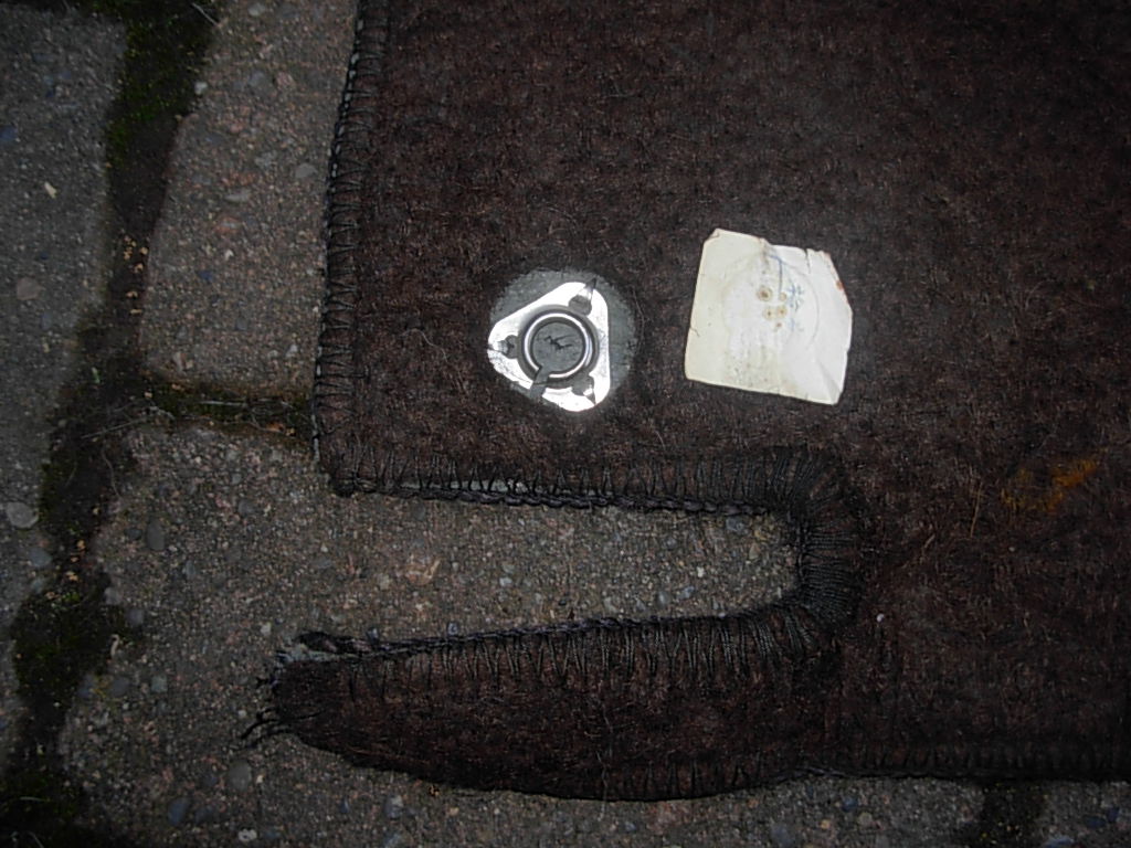

Both the early cars had unsplit rear deck carpet (storage covers behind the seats----not pockets in the deck) with factory installed screw positions for the cargo straps in the rear deck metal. serged cutouts for this end, and notches cut and serged for the straps as shown by westpak at the rearmost end.
The 2/73, of course, had the split for access to the storage bins, cut outs in the carpet that were unserged (the metal end screwed directly to the deck), and the notches at the rear for the cargo straps which were serged.
The carpet pieces that went behind the front seats have a seam where it was cut and then resewn to make it conform to the rise in the floorpan as it meets the rear deck forward wall (riser).

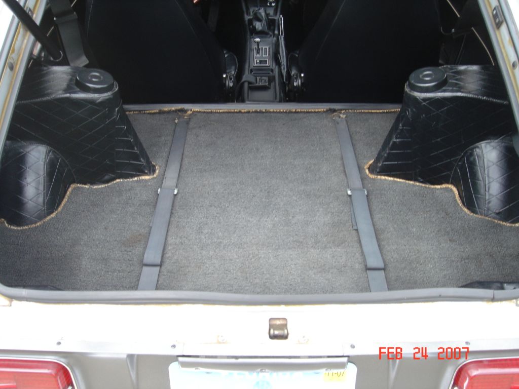

I'm not certain when - but the early cars had cut-out's for the luggage straps, and later cars simply had holes for the mounting screws to go though, with the fasteners on top of the carpet. I noticed this on my early production 72 Z (11/71).

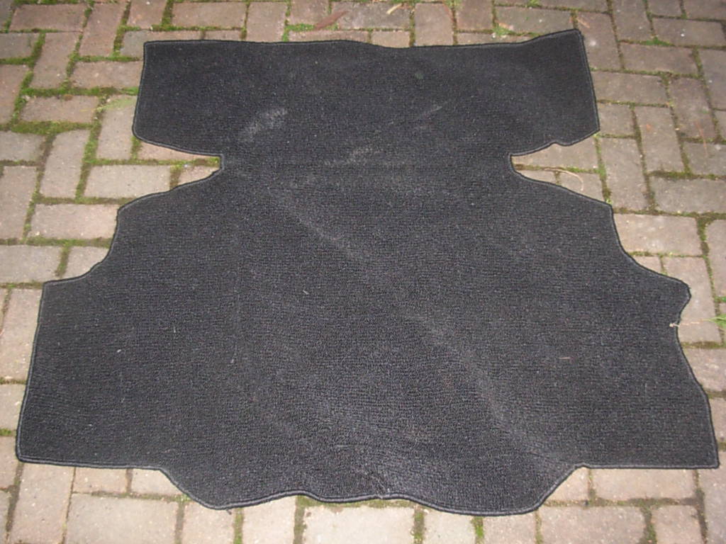

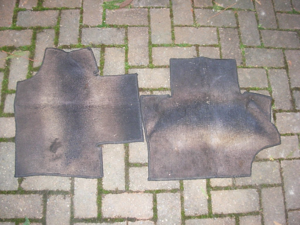

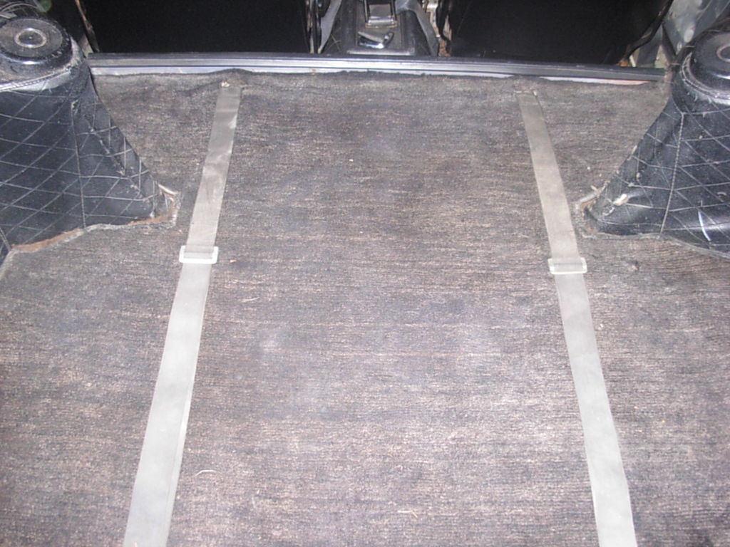

I am going to post some various carpet pics for comparision. This carpet is in my low mileage 5/72 (a series 3 car). It is in like new condition. Notice the more defined loops and the grey backing, which are different than what I have seen in earlier cars.
-Mike

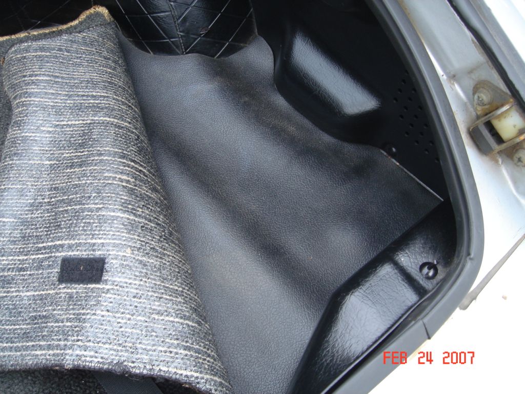

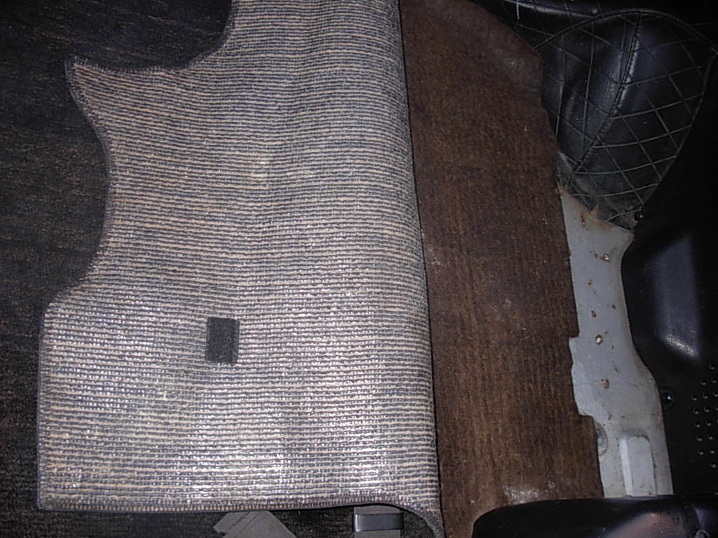

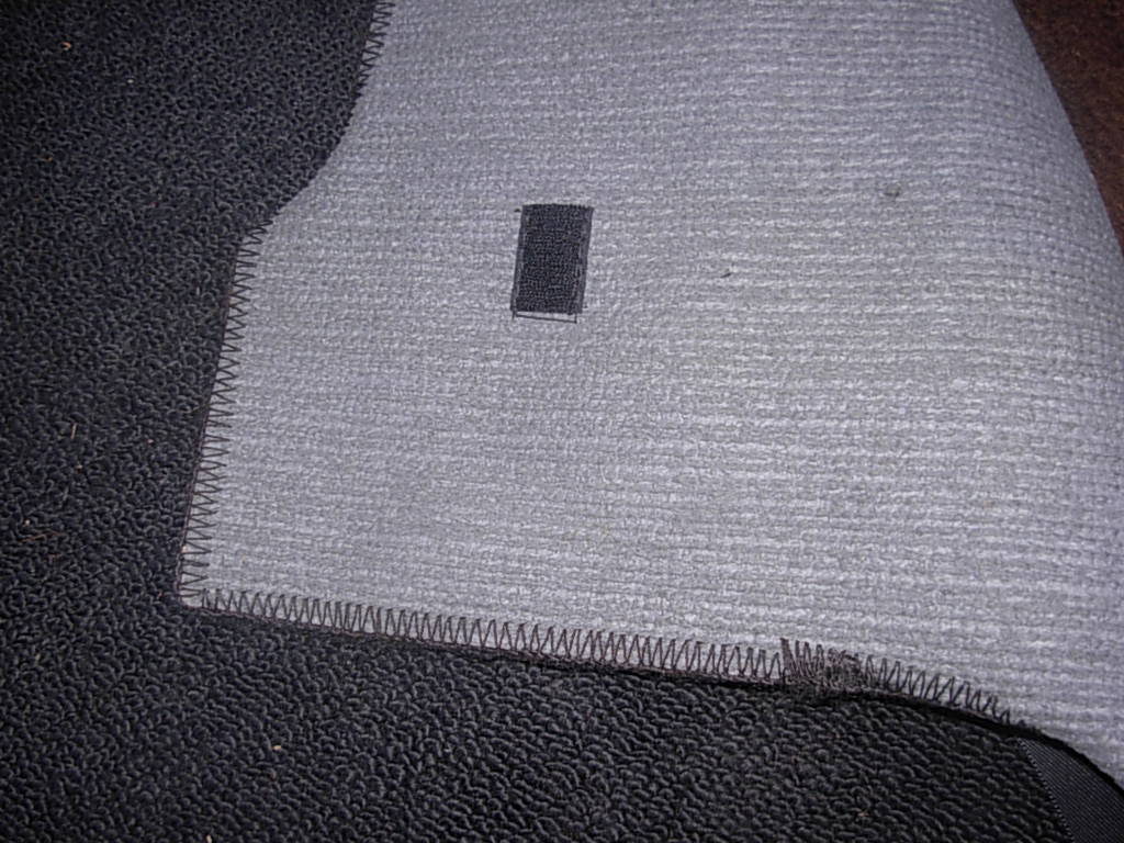

The are pictures of early carpet. The first three pics are from an 11/69 production car. The rubber mat is unique to some of the 69 cars. The other pics are from a 5/70 (this carpet is currently in my #237). Notice the clear backing and less defined loops (not just from wear) on both.
-Mike

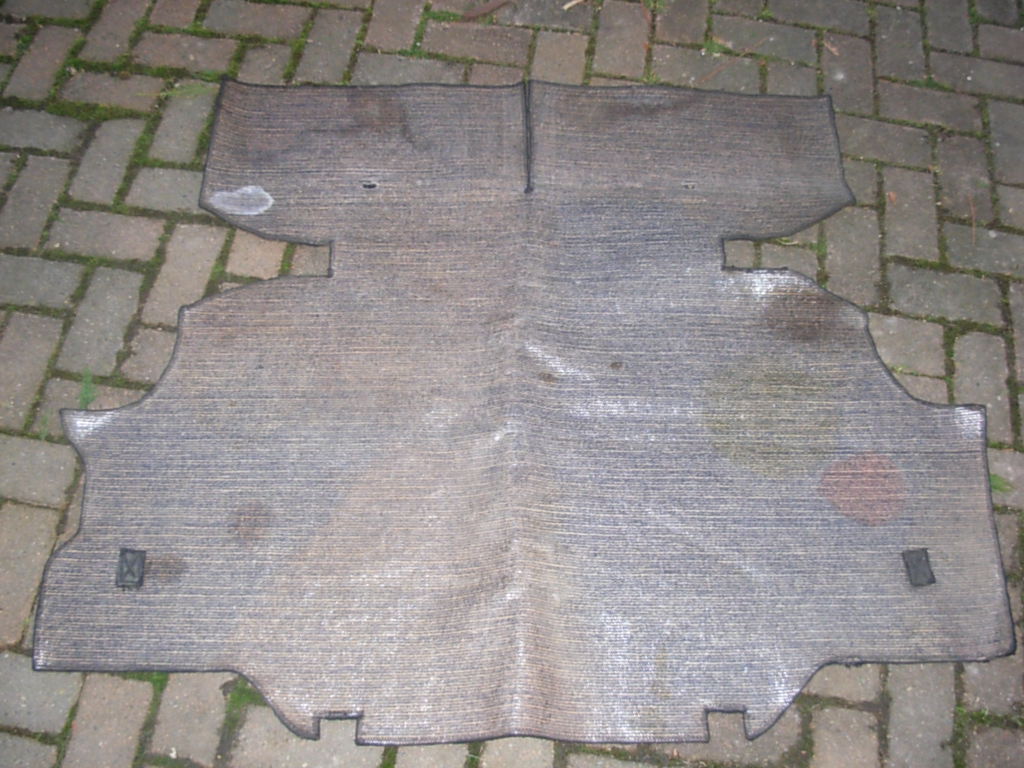

This is some very faded carpet from a 3/71 (an early series 2) parts car I got recently. It has the same clear backing as the earlier carpet, but the cargo straps are lower and there are flaps for the jack and tool storage compartments.
-Mike

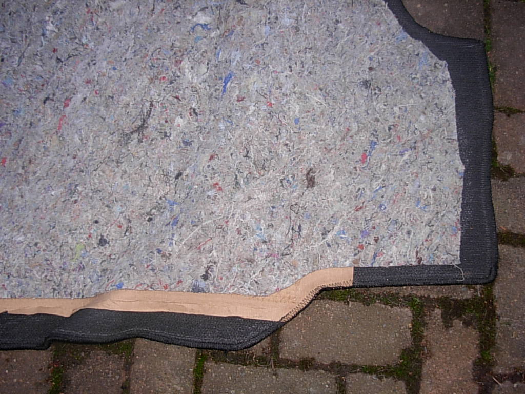

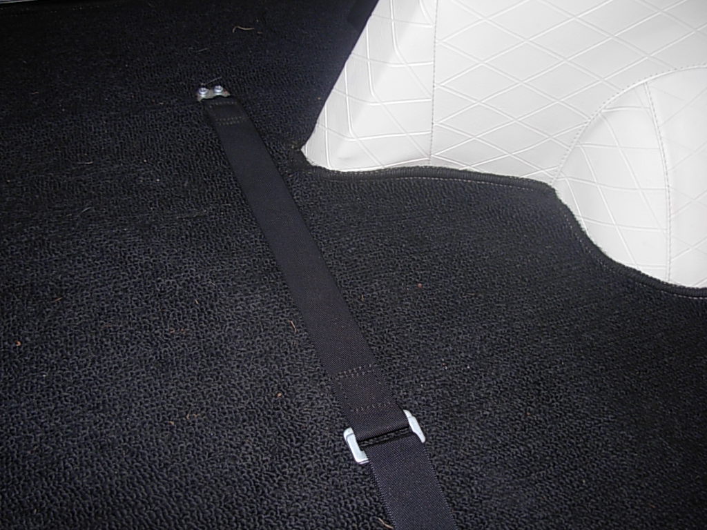

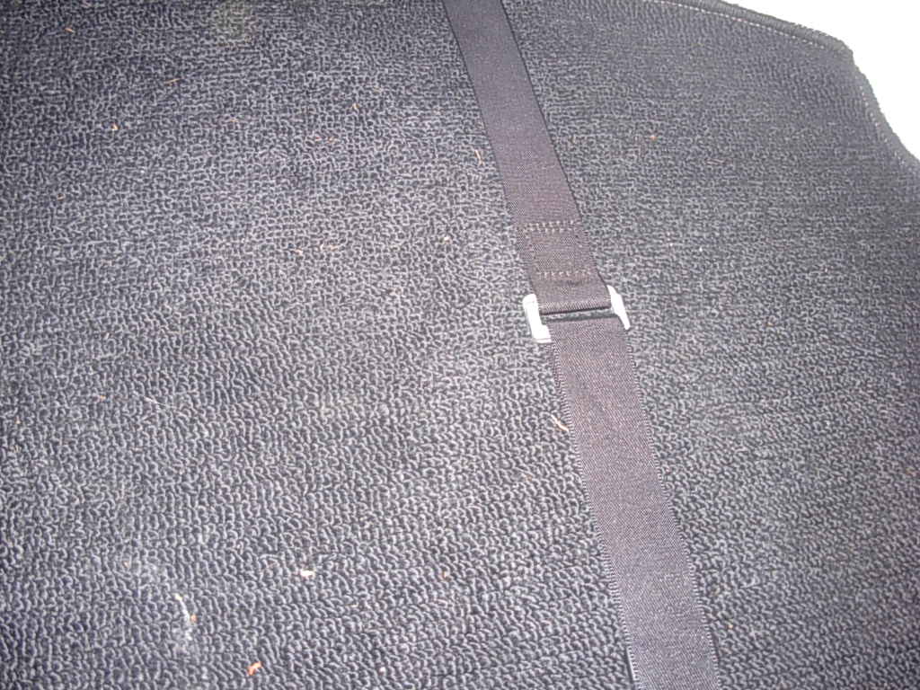

This is the carpet from Too Intense Restoration for the series 1 cars. Bound edges, but no cut outs for the cargo straps, it is much lighter (maybe because it doesn't have the spray on back coating), it has the back padding made of colored threads, and the pattern is not as accurate as the original.
-Mike

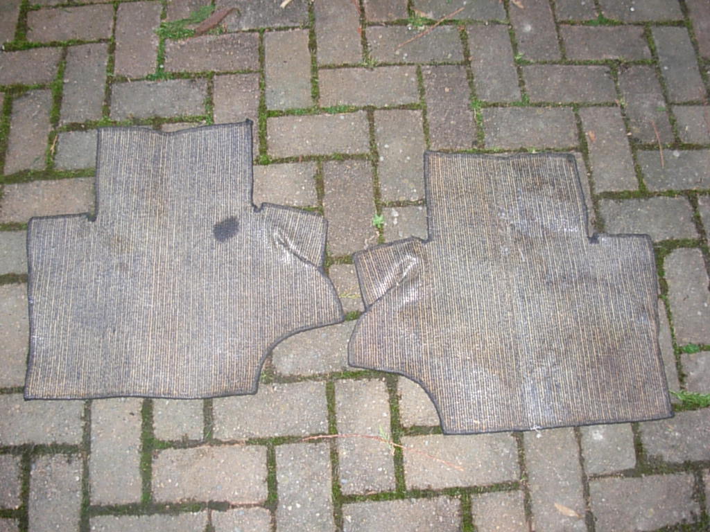

These are the front floor mats from another 1972. I forgot to take pictures of the ones in my 5/72 before it got dark, but these are the same style. Note the brown backing.
-Mike

I can confirm that the faded and worn carpet in my 7/71 cat is the same as the pictures Mike provided from the 3/71 car.
MikeB---
Thanks for posting those pictures. They are the same as what I had tried to clumsely convey in previous posts. In particular are pictures three and four of the first group--it shows the cut made and then resewn to get it to conform to the rise behind the seats toward the rear.
The carpet I have in storage is similar to both the styles of original you have shown.
Some is rubber backed from the later car and the other is the smoother, more like plastic backed from the early car. All of the cutouts and notches match up to what I remember. Thanks again!

Picture Below: later 70 carpet on the Left and 69 carpet on the right.
