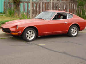

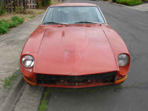

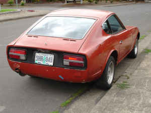

My twin brother currently owns a '78 280z and I am currently looking to buy a 240z. I recently found a '71 240z that looks like it is in good shape. Body is clean and do not see any large dents at all. It is missing the bumpers, but I feel it looks pretty cool without them. What do you guys think?
I called the owner and he said his son gave him this 240z and he just wants to get rid of it as he is not into working on it. He said the engine runs good, interior is in ok shape with just a tear on the back of one of the seats. The engine has been replaced and runs good. Heater box is not installed but he has it and the whipers do not work.
It really looks like a nice 240z and these are hard to come by as we all know! Oh he stated there is very minimal rust on this car. It is located in Oregon so its not like it is from the midwest where rust is rampant.
He is asking $1200 firm for it. What do you guys think? Any questions or concerns I should have? Any other questions to ask? What to look for etc? Your advice and input is welcome!

p.s. - I have included a photo for reference
You need to look at the typical rust prone areas to determine if thats a good deal. Under the battery, up inside the fenders, check under the doors, the doglegs, and the check the whole underside to see how much rust is under there. If you can, pull up the carpets to see the floor pans and rockers. Also check the rear deck lid and under the spare tire.
Post some pics here if you're not sure. If those areas are in good shape then you should find out if that red is the original paint, or how many times it's been painted. The engine bay is black so at one time there was some type of repaint probably.
My body metal looked great when I got it, but when i took 4 paint jobs off, I found all kinds of bondo and repairs. Take a magnet wrapped in a soft fabric and run it along the outside and see if it sticks or if theres bondo under there!
From the pics you sent its hard to tell any of this, but it sure looks better than than the z I started with!
Good luck.
From the little I can see from the pictures she doesnt look bad. As what was stated , look closely for rust . This cannot be stressed more. It is the biggest enemy of a Z. Also the costly to repair properly. Below the Battery and just forward of the doors , down low at the bottom of the fenders. Just to the rear of the doors down low in front of the wheels , ''dog leg''. When you look at the floors, check from under the Z, as well as under the carpet. The two ends of the hatch sill where the water drains down the channel of the hatch on each side, is a area to look closely at. Water tends to collect and puddle on the sill . If the seller has the bumpers and mounting hardware you should get it. Even if you don't think you will run them. Some insurance Co. require them. Plus they are not easy to find and are not cheap. All the best . Gary
Looks like the rear hatch is from a '70 Z based on the air vents (which seem to be missing). Actually, there are no side vents, so are you sure it's a 1971? As mentioned, bumpers are hard/expensive to come by if not included. Although fiberglass replacements are available if you have the mounting hardware.
It's an early '71 or Series One car. Like the other 2 members stressed, rust is public enemy #1 when it comes to Zs. Also, I agree with Beandip, if the seller has the bumpers, make sure you get them and any other spare parts. If the car checks out OK, then I would say it's a very good price for a Series One car.

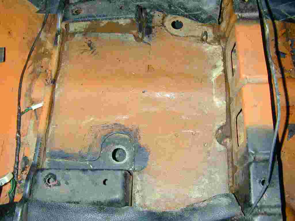

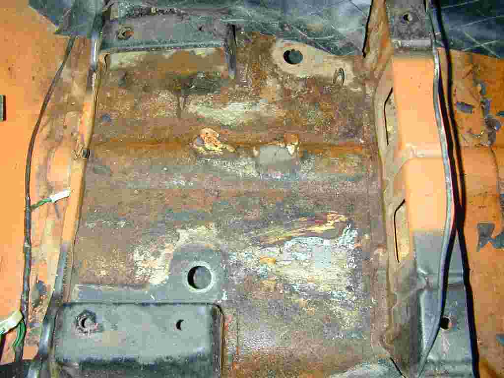

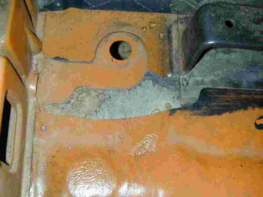

Asta, in the pictures you posted, if you'll notice the picture where you annotated "missing one of those rubber plug things, replaced with this metal thing" (I'll post a note on that metal thing later), you'll see that there is this "indent" in the general floor surface. That indent is the edge of the "tar mat" that Beandip is referring to.
If you'll look further up the floor pan on the passenger side, to just below the firewall cardboard/insulation, you'll see where the tar mat did NOT cover the metal and you can spot a dash of surface rust. Also on the right edge of it, you'll see the tell tale signs of it starting to creep out from underneath it.
The basic problem with the original tar-mat is that it was applied at the factory on unprotected metal. Some people have said they've noted it on top of color paint, others on primer and others on bare steel.
Since it's impossible to detect whether it is hiding rust or not without removing it, it becomes a kind of "Russian Roulette" (no offense intended to anyone), with the bullet being rust. You could leave the tar mat alone and never have problems arise, or you could be masking a serious case of floor rot occurring right underneath you.

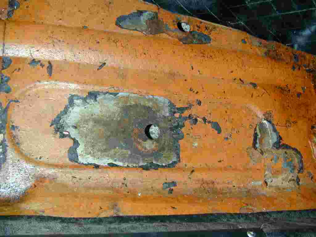

I've posted a few pictures I took on a car I'm working on. The first 4 are from the passenger floor pan, and the last is one section of the driver's side.
You'll note that while the under seat area tar mat looked okay, it proved to be the one hiding nastier rust than the general floor pan mat. Then when you look at the piece I chipped off on the driver's side under seat area you can see where the mat was put directly onto bare steel, and part of it seems protected and part is beginning to rust.
This is an area of known problems on these cars.
While the "originality" factor will be considered by some, it needs to be stressed that the rust is ALSO original.
FWIW
E
