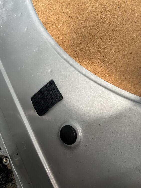

Hi, I have worked some minor things for mirrors, horns etc.
Fairlady Z series has mirrors on the front fenders and the way they mount is completely different from the one for the US.
Mirrors have to be flexible when they hit something.
The horn, the Higher tone has “H” and te lower tone has “L” shown on the bracket.

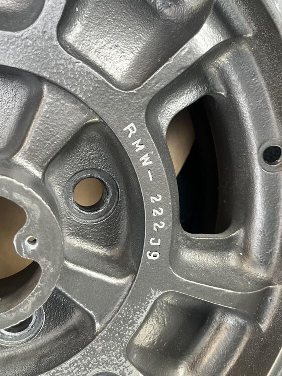

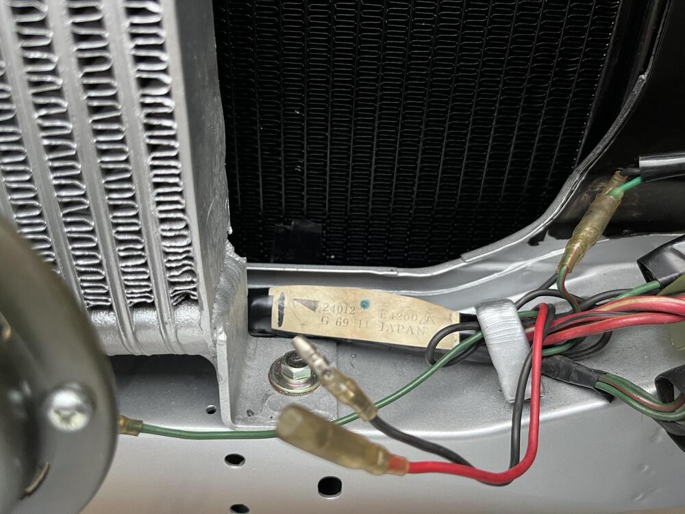

You see S12, I am sure S means 1969, 12 means December. It makes sense to my 01/1970 Z432.
My two 03/1970 cars have T2, indicating 1970 February.
Also my 1972 June 240ZG has V6, The rules seemed to apply for all of my cars.

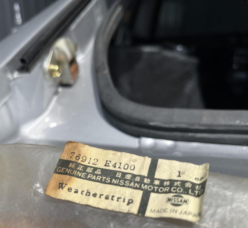

Here are some refreshments why Z432. Please note the inner rear gate weather strip is NOS the earliest version. It is now a bit harder than when it was newly delivered but the rear gate can close almost perfectly. Probably after passing a few years the rubber will get used to cope with the rear gate more.

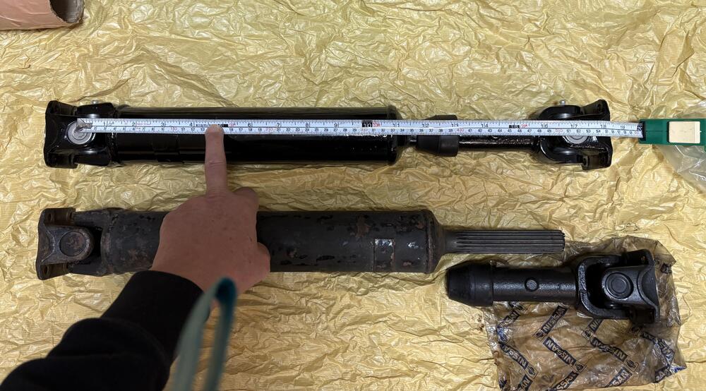

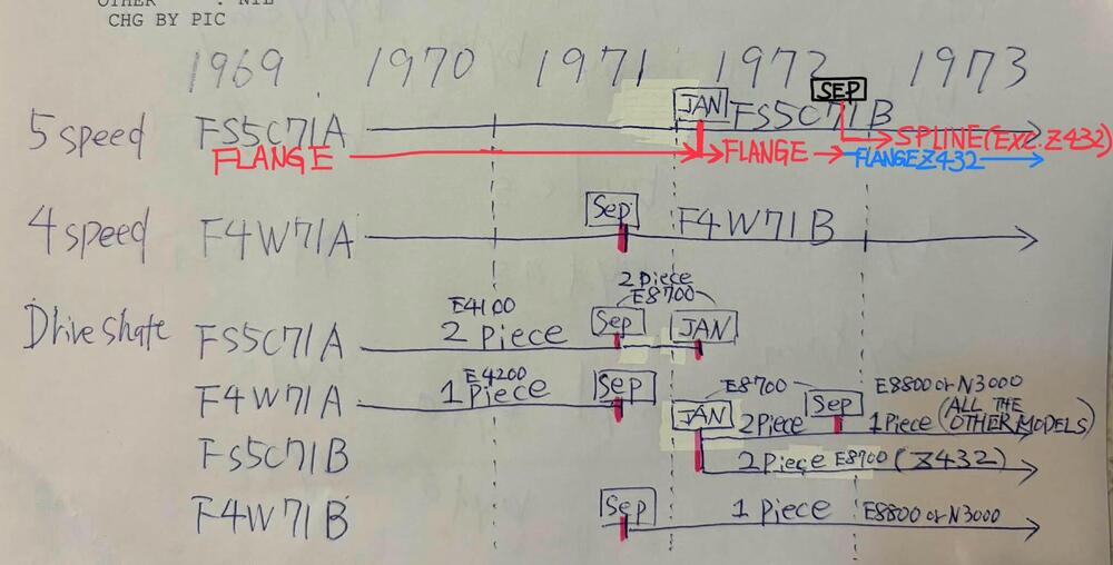

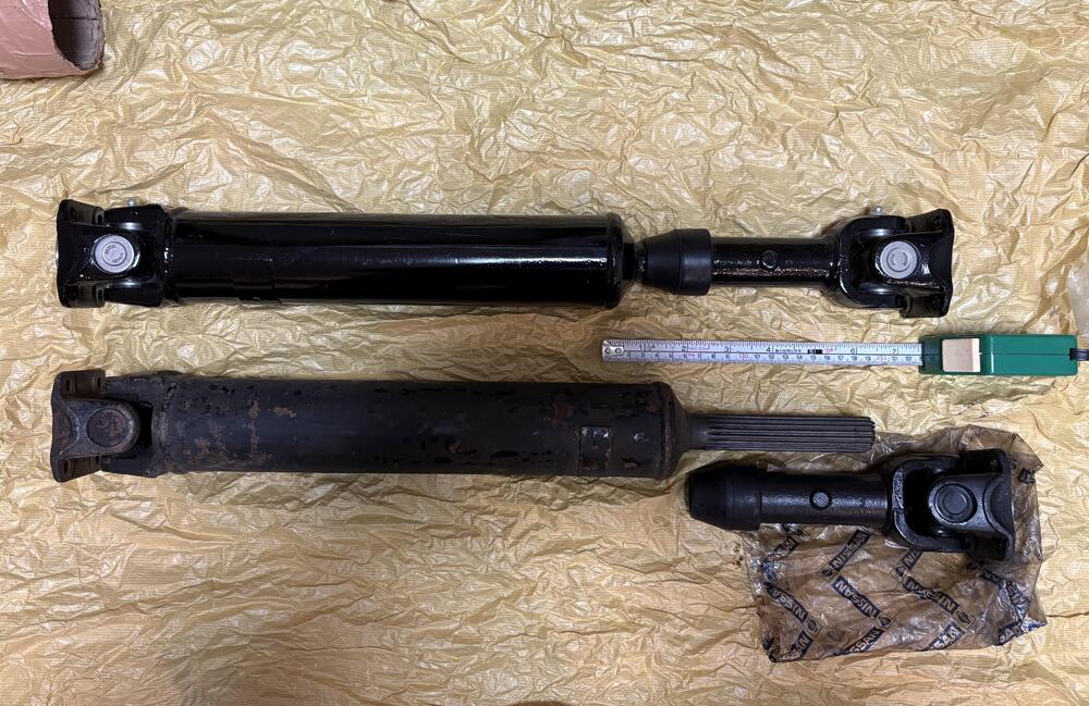

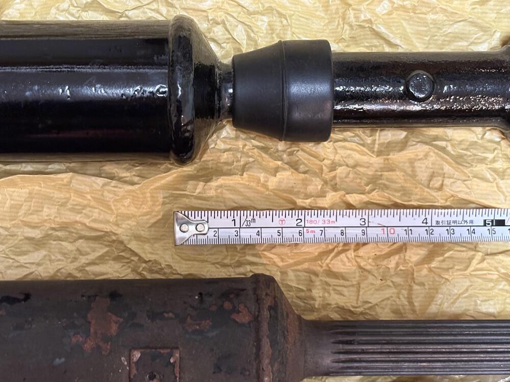

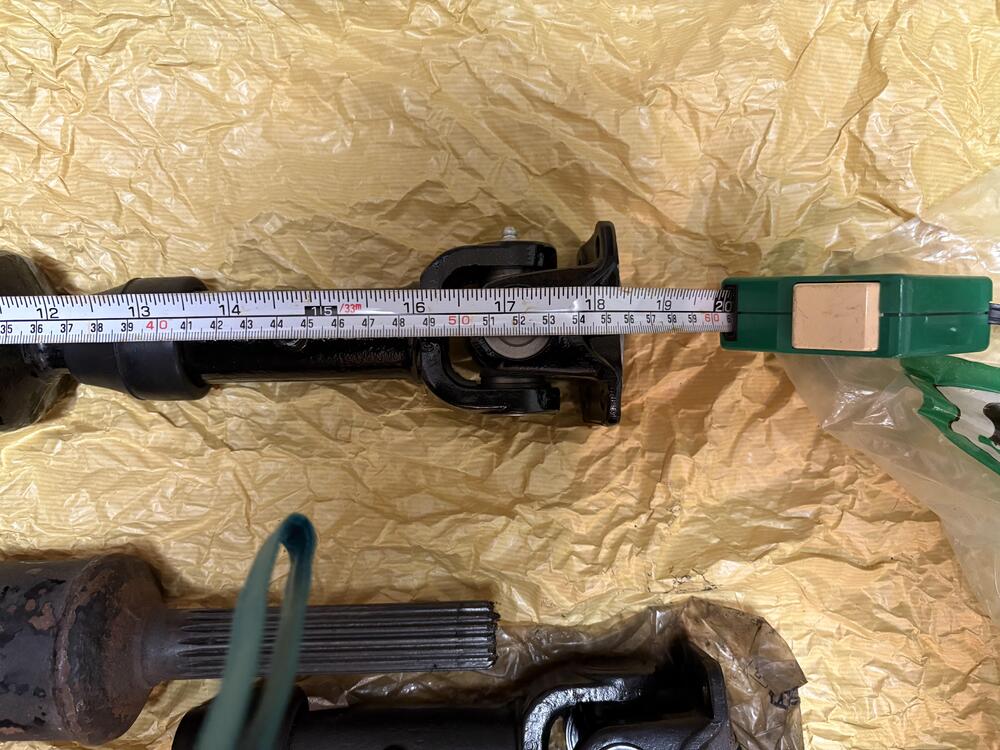

Here is a comparison of the two propeller shaft E4100 and E8700 for the FS5C71A and FS5C71B.
E4100 is 520mm, for cars up to Sep 1971
E8700 is 555mm, for cars from Sep 1971
Kats

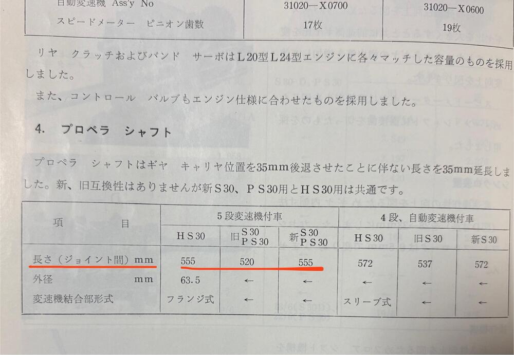

This is my memo for the transmission I have.
I don’t think most people here need this information though. For myself, and wish if someone will appreciate it.
Kats
Kats
This exactly information I was searching for last month..... Thank you Kats for both this chart and detailed pictures of the early/late driveshafts.... Still trying to figure out how a 75 car wound up from the dealer with a early a/monkey motion trans and short 2 piece drive shaft.
