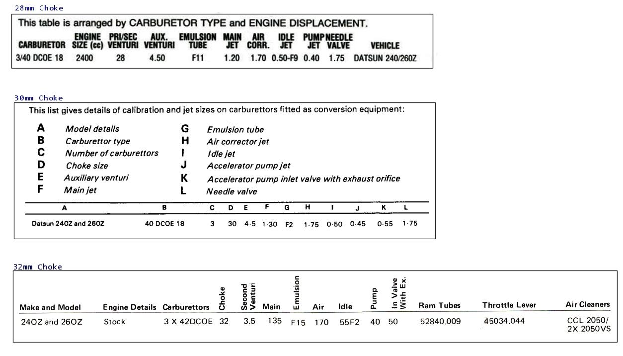

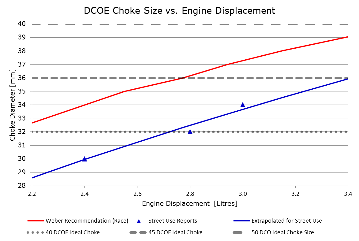

Merry Christmas!  As Alan mentions, you can make nearly any size DCOE carb work with any engine due to their adjustable sub-componets, however; Weber does give recommendations for racing and street use. These are plotted below.
In parallel, many engine tuners over the past decades have published recommended configurations for the street. They generally recommend 40mm and 42mm for street for 2.4 to 2.6 litre engines.... so for a two litre, 40mm would lean more to the higher side.
According to the great DCOE tuner John Passini, he mentions in several publications that the transition from a small choke to a larger carb throat causes fuel to precipitate to the carb floor.  For example going from 32mm choke to a 40mm carb throat has less fuel precipitation than going from 32mm throat to 45mm carb throat.
Weber recommends that the ideal choke size for racing is ~ 80% of the diameter of the carb throat. So for a 45mm carb, a 36mm choke would be best.  This is a very large choke for street driving and give poor low rpm performance.
A lot of great data is at this site that Hoover and I love.. they use 82% ratio for Solex:  http://www.carry-back.com/CARRY BACK Carbu setting 2.htm

Hi Blue ,
my 44mm has 34 choke , it is just right for the carb , racing use .
I believe U20 race option was 50mm , one cylinder is approximately 500 cc , so it is suitable, isn’t it ?
Kats

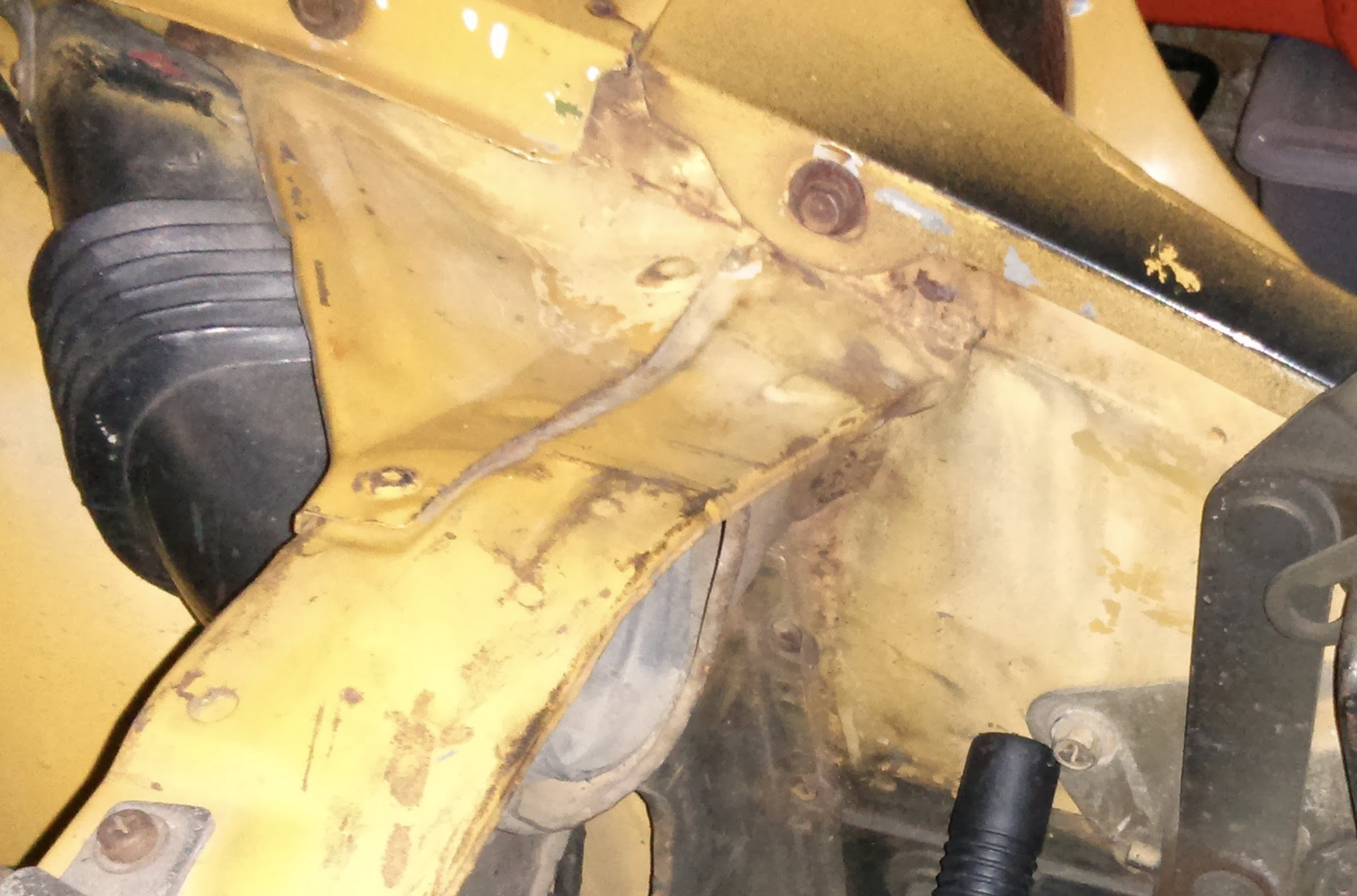

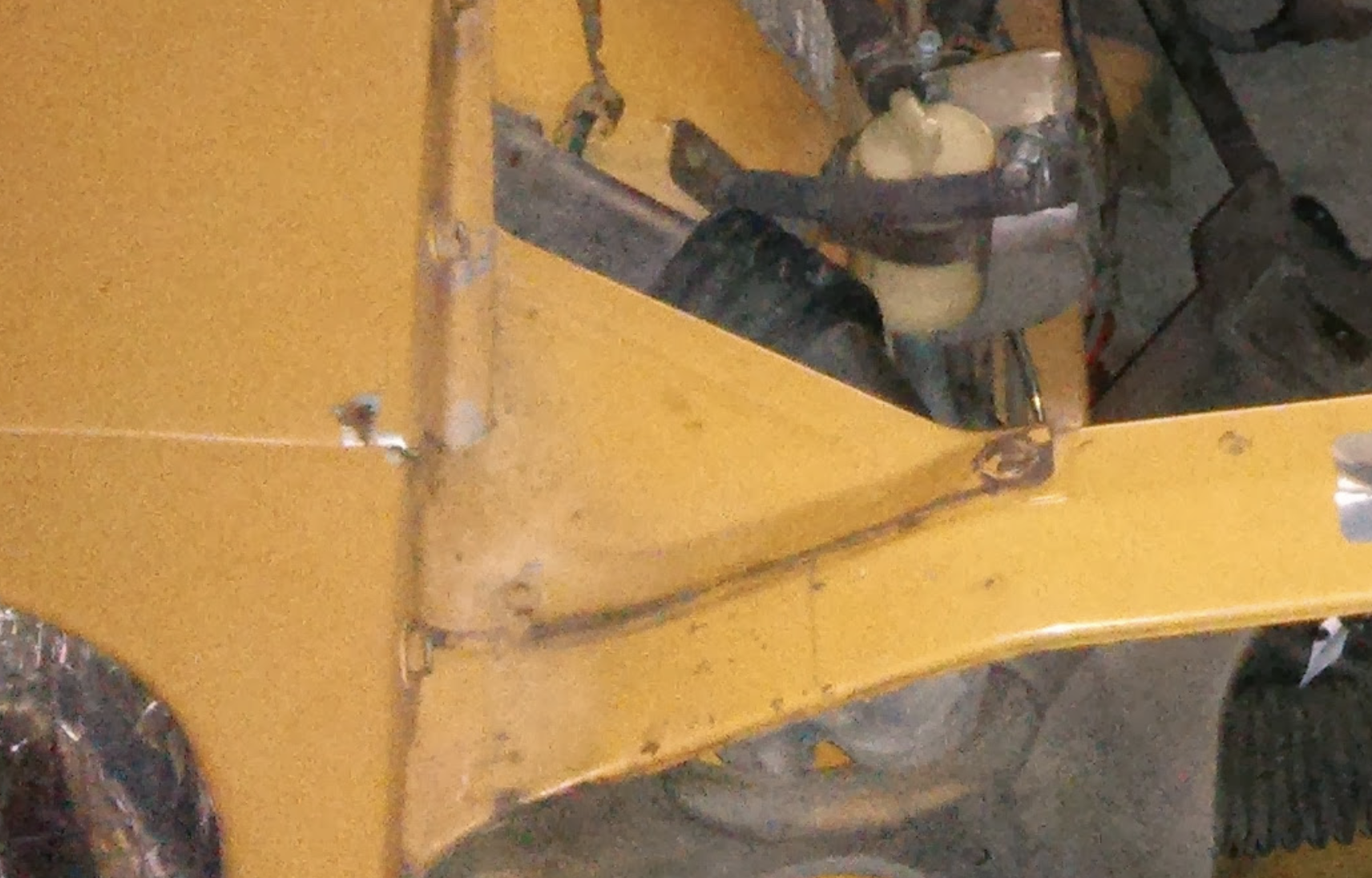

I immediately noticed the welding finishing touch of the radiator support upper L & R corner , this is what I call and love  “ hand crafted “ which is rarely seen in our mass produced S30 .
I noticed these on HS30 00150 too! I thought it meant the car had been repaired before. So this is good to see and know about as being "normal".
The car has been in a nudge on the passenger side, but not enough to disturb the radiator support. The driver side is still as OEM as new.
