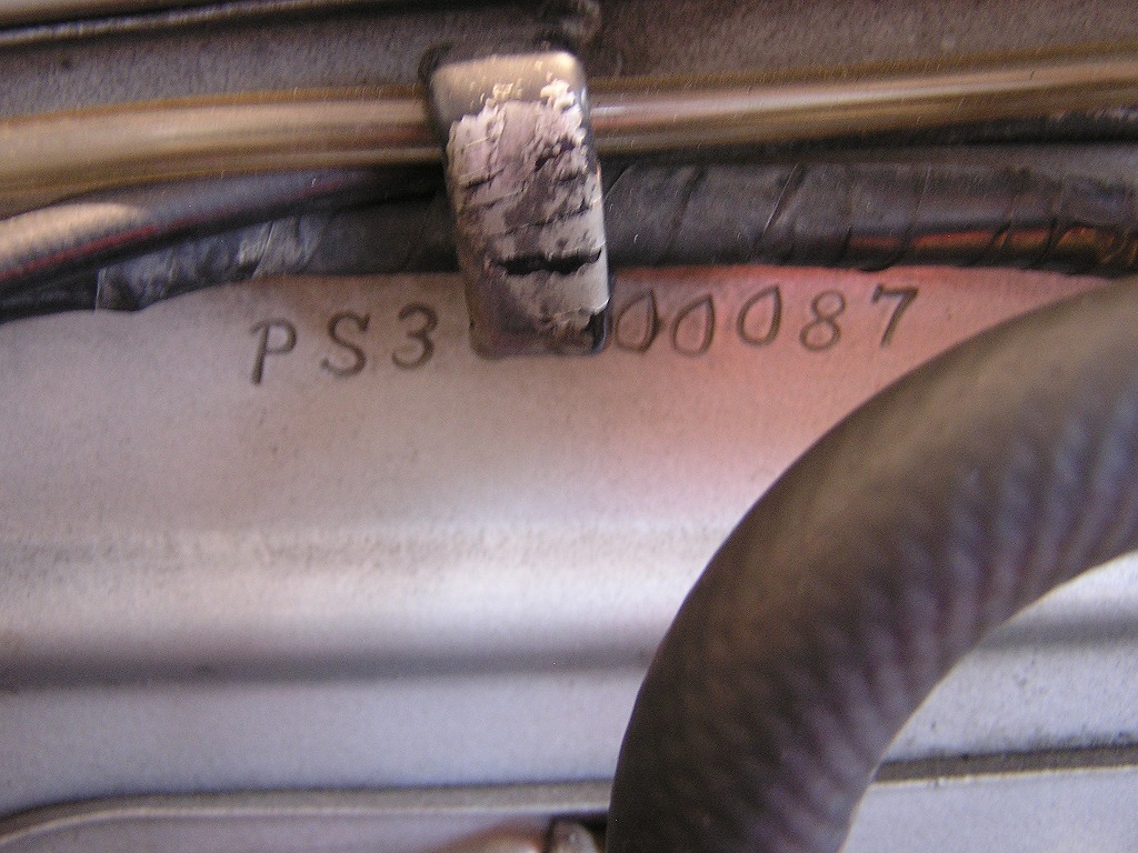

April 26, 200817 yr Author comment_245411 When I dropped at Mr.Moroe's shop, I happened to see PS30-00087. What a wonderful moment that my Z432 actually met her sister again since they came apart for delivery from the Nissan factory back in January 1970. Like 26th and 27th, Chris:love: They must have wonderful times. PS30-00087, she is now belonging to a new owner recently. She is very beautiful , still keeping original body paint with lots of original part.Amazingly, she has not been restored.Her S20 engine and suspensions have been modified, and she has got AFM air conditioning system. I was lucky I met her, she came to the shop to have totally restoration!! For someone may interested in, she has got reproduction Z432 aluminum wheels. It looks perfect, center cap is also reproduced.I do not know they are still available or not. If you see my Z432's original Magnesium wheel and cap in my website, you can see how the repros are close to mine. kats Link to comment https://www.classiczcars.com/forums/topic/23900-datsun-240z-vs-fairlady-z432/?&page=13#findComment-245411 Share on other sites More sharing options...

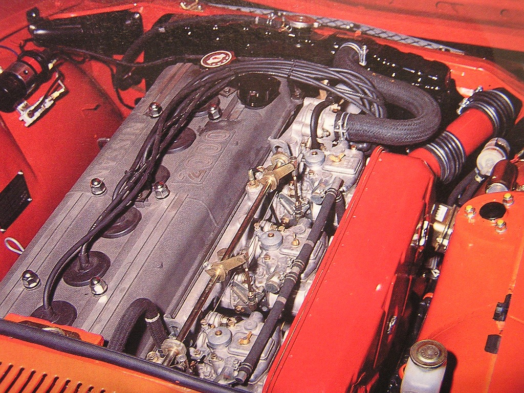

April 26, 200817 yr comment_245417 Hi Kats: See image below... FWIW, Carl B. Link to comment https://www.classiczcars.com/forums/topic/23900-datsun-240z-vs-fairlady-z432/?&page=13#findComment-245417 Share on other sites More sharing options...
April 26, 200817 yr Author comment_245439 Hi Carl,You have good eyes!! I am impressed you pointed these out.Especially a wing nut of the air cleaner box.There are some things that are still misssing, does enyone find out yet?kats Link to comment https://www.classiczcars.com/forums/topic/23900-datsun-240z-vs-fairlady-z432/?&page=13#findComment-245439 Share on other sites More sharing options...

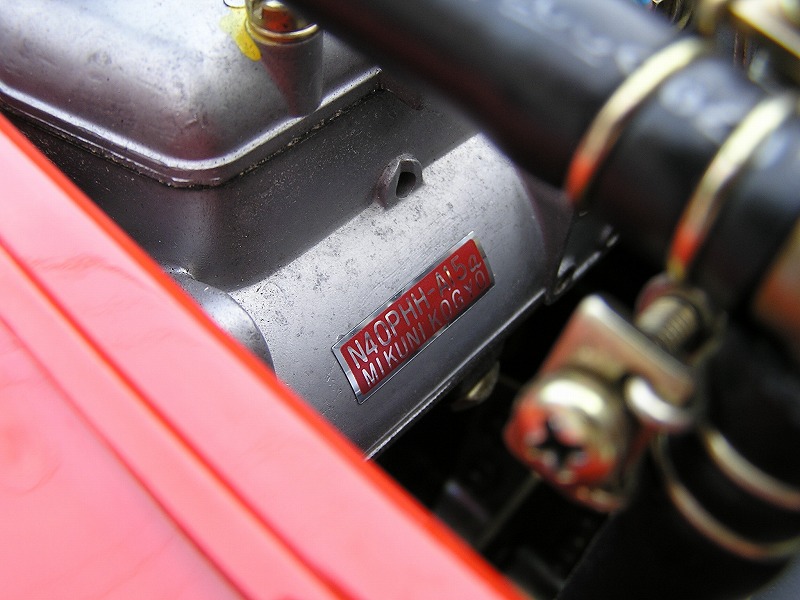

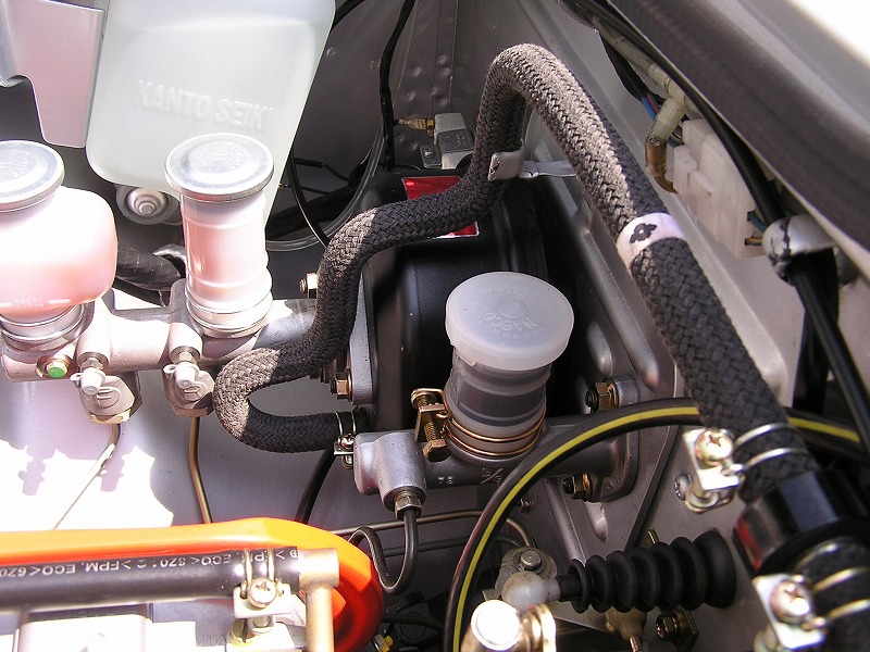

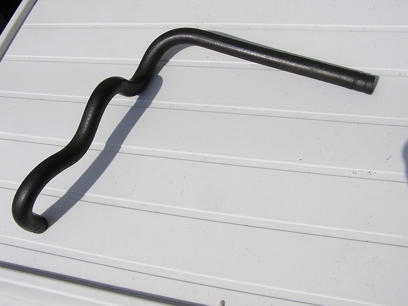

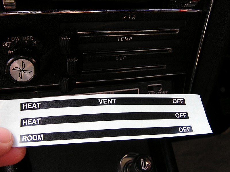

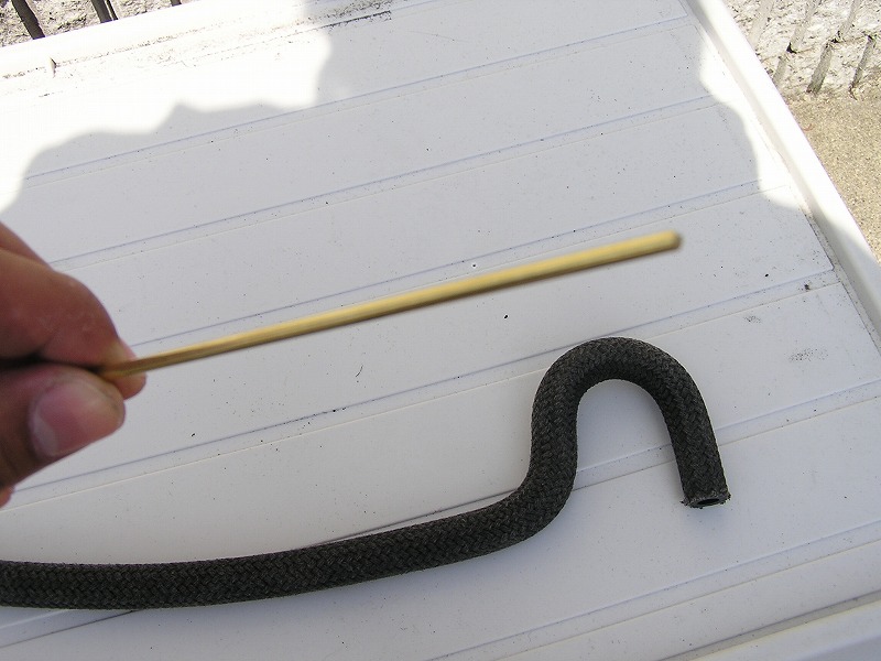

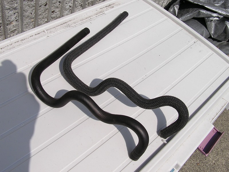

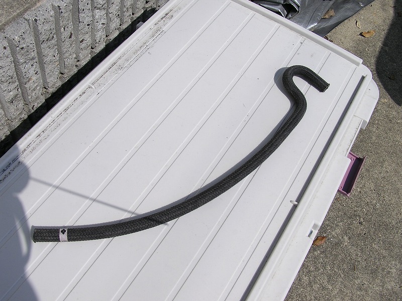

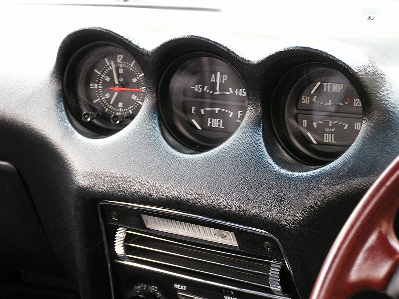

May 4, 200817 yr Author comment_246196 Hi, Now Japan is in a long holidays, very nice sunny day so I have done some works for my Z432. My Z432 had been using OEM new master vac hose, but it was not cloth-braided. How everyone is doing about master vac hose? I have never seen NOS one in the EBAY since I have joined it in 2002. So, I made it. It is not an OEM, it is a fake. But it looks pretty good shape is not it?? I use a NOS fuel hose, and a brass rod. That is all.The rod can be anything if it has enough strength to bend the hose and keep its shape. Just cut the rod appropriately and let it go through the hose. Then you can bend the hose as much as you satisfy, now you go it. Just apply the hose to its original place, the rod is sitting inside with out problems. My 240Z has done same thing and still without problem ,4 years has passed. And the temp/oil gage, my Z432 got NOS one but it is for 1972 or 73. Indication scale is different, later gage does not have white center reference(actually for the water,it is not in center though) So I replaced later scale to original re-conditioned ones.Only facing was replaced. Heater panel label,Mikuni carb label,are in place. Did I show the battery? Fairlady cars have a small battery not like exported cars, the battery hard ware is completely different. Thank you, kats Link to comment https://www.classiczcars.com/forums/topic/23900-datsun-240z-vs-fairlady-z432/?&page=13#findComment-246196 Share on other sites More sharing options...

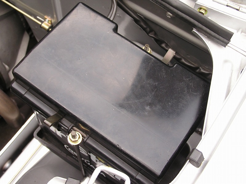

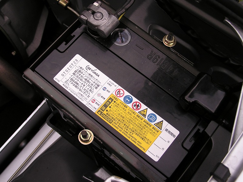

May 4, 200817 yr Author comment_246197 pictures of Z432's battery. kats Link to comment https://www.classiczcars.com/forums/topic/23900-datsun-240z-vs-fairlady-z432/?&page=13#findComment-246197 Share on other sites More sharing options...
