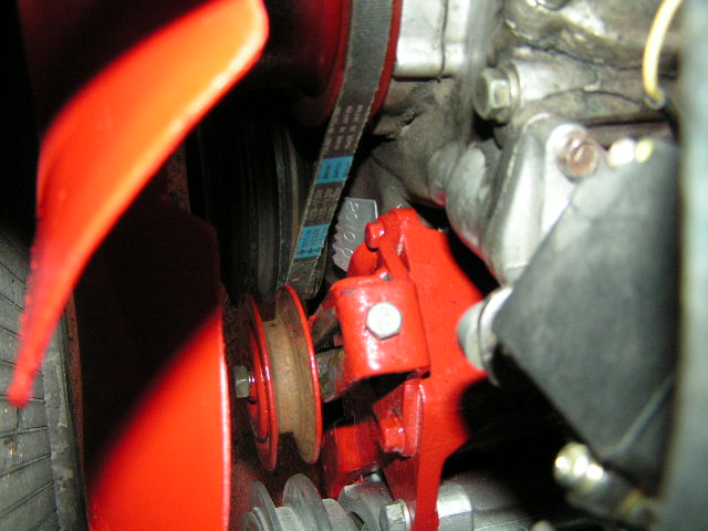

I tried checking the timing with the strobe light but I couldn't see a mark on the crank pulley? I have read a lot of threads trhat mention as many as five marks! Yikes!
I kinda think I have found one using a wire brush degreaser and a can of high heat paint but its debateable.

You probably need to remove your valve cover and make sure get the mechanical time at top-dead-center. Once you know that, the mark should be easy to see and you can make it more visible by filing or marking it.
To be sure you are at TDC you can remove the #1 spark plug and see that the piston is at the top of it's travel (or you can stick a wire tie in there to feel it). When you are at top-dead-center the dizzy rotor should be pointed toward the front of the car. Your correct timing mark should not be easy to find. I think it takes a 27mm or 1 1/8" socket to turn the engine crank.
Some engines have a single pointer with multiple marks on the crank pulley. Others have a single mark on the pulley and a sort of timing ruler with multiple marks. Which type of pointer do you have?
