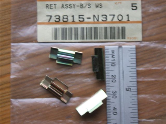

Now that you have them off, look to see if there might be tiny little razor blade like clips inside the moulding. If there are, don't loose them as they are tough to get and if you try to reapply the moulding without them, they won't stay on long. Trust me I know alot about those little buggers!
Thanks again. The clips are in a plastic baggy! Carl

Sorry for digging up an old post, but I was replying to a post on Zcar.com and searching here to add weight my relpy, and come accross this thread. I thougth I might as well finish this thread with the info required.
EScanlon asked for a picture of said clips, well find attached. 5 clips per side for a 2 seater, and 6 or 7 (can't remember which) for a 2 by 2. These seem to be NLA, and the last few I brought cost me over £6 ($12) each!! (I live in England) If anyone has any luck finding some new ones, I do need some more to make a set for my car.
Regards
Ian
Ian;
That's excellent info.
With that part number I was able to track the item down in the microfiche. It only appears in fiche 155-2 item 9 & 11 and it isn't even illustrated along with the actual mouldings for each side.
But if the microfiche is correct, these clips ONLY apply to the 2+2's AFTER Oct. 73. Then it's 8 per side for the part number ending in N3701 and 7 for the prior part number which ended in N3700.
Thanks for the picture!
