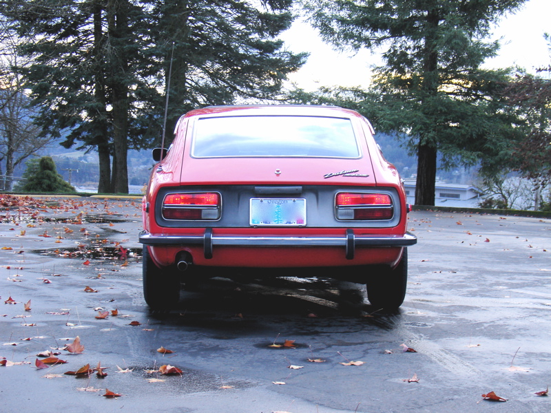

I have a late '71 with 60,000 miles, and the tail finishers and grill have never been repainted, as far as I can tell. I also have set of 'D' hubcaps that are near mint, were removed when the car was new and have been stored away from sunlight their entire life.
The grill is obviously lighter in color than the hubcaps. But the effects of 35 years of sun on the grill are not easy to determine.
On the other hand, as you can see in the attached picture, the tail finishers have obviously faded, and faded rather unevenly - probably due to the sun coming through a previous owner's garage window on the passenger side.
The right side of the car's finisher is quite pale in color, getting darker towards the left side. The far left edge is much darker, and appears (to my eye) to be the same color as both the area protected by the license plate, and also the same my near-NOS hubcaps. I tried to take a picture to show this comparison to the hubcap, but the picture can't show subtle differences like this.

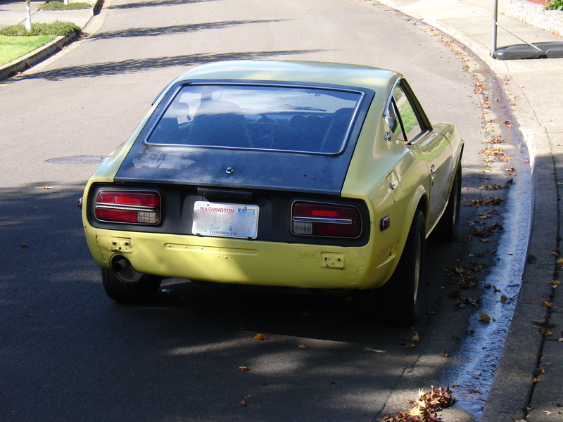

Additionally, the finishers on my early car (10/70) also appear to not have ever been refinished. But for some reason they have not faded like those on the Series 2 car have. They are nice and dark, and definitely appear to be the same color as my 'D' hubcaps. I don't have a real good picture of these, but in the attached picture look at the left side of the car where it is not in the shadows.
So when I refinish mine, I'll be quite satisfied if the grill and finishers are the same color as my hubcaps. (I'll most probably use the paint from Les at Classic Datsuns.) If there was any difference in color when the cars were new, it was very minor, and I don't think it will be significant.

Thanks everybody for your help I really appreciate it. I am not an expert and I don't think I will ever get to the 300 point gold medallion however the closest color to correct is Arne's panel. Especially the right side of it. I don't agree with Wick Humbles opinion on the paint. As for Les I did buy some cans from him but he told me difinitvely that it was only for the Hubcaps for which I have one restored set and one brand new set and the paint on both is dead nuts perfect and identical believe it or not. So Les makes good paint or wherever he gets it.
I am absolutely positive that the rear panel and grill are the same color a medium to lighter gray in a fuzzy texture. It's interesting the grill on my Land Rover Sport is almost the exact color of what it's suppose to be so I think I'm gonna go with that minus all the mettalic.

...however the closest color to correct is Arne's panel. Especially the right side of it.
I'll have to disagree with your opinion on that. The right side on my red car is obviously badly faded, when compared to any protected area of the finishers. Not only when comparing to the left side, but under the license plate, and at the top where the plastic rivets hold it (which is protected by the tailgate) on the same right panel. Any place on that right panel that has been protected by the sun is much darker, basically the same color as the hubcaps. They show absolutely no signs of ever having been repainted, either on the front, edges or back side. (Yes, I've personally had them off the car and checked.) So I'm at a loss to figure out how you can determine that the 'original' color is the obviously sun-faded pale color. I've seen pictures of cars with pale gray finishers before, and they always look wrong to me. (And yes, I'm old enough to remember seeing 240Zs when they were new.)
So when I refinish my red car's grill and finishers, I will use the dark paint from Les. If you want to use the pale color, go ahead. It's your car, and your decision. But all the available evidence on my original un-restored car points to the dark color being original.
