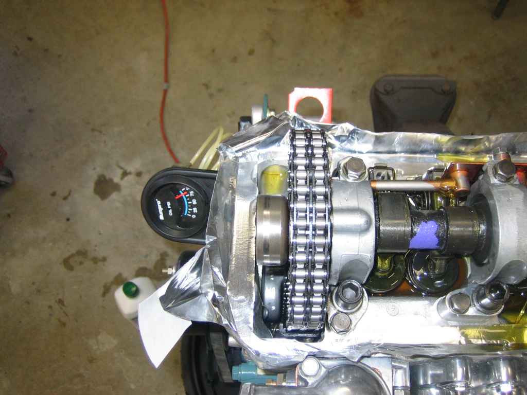

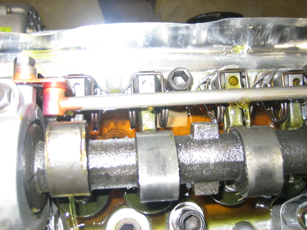

Still waiting on my new spray bar from MSA. They sent me one ,but my luck it didn't line up with the towers . I guess I got a defective one . Sal was very helpful and has sent me another to try . I have a oil presssure guage mounted to the motor(mechanical type), and I will checking pressures with the new spray bar mounted.
  • 3 months later...
I left off waiting on an oil pump and a new spraybar from MSA.I failed to fix my original spray bar and actually melted it trying to resolder it. I had another one but couldn't find anyone who wanted to mess with it. I will assume for the sake of this experiment that the Nissan replacement that MSA sells performs the same.
I ordered the high volume pump plus some HP springs so I knew what I had doing this experiment. I also mounted a pressure guage on the block to keep an eye on things.
Bottom line is that I could NOT get satifactory results using both oiling systems. I never could get the spray bar to spray with enough pressure to actually reach the lash pad even with the HP springs installed and showing 75psi. So IMHO there is no reason to run a spray bar and the internally oiled cam both.
My disclaimer is that i am a novice mechanic and your results may vary. Hope you guys get something out of this:)
