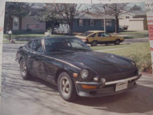

You'll notice that I said "fiasco" in my post.
Boy was it ever!!
Not only did they lose my cap---they put those G'Damn stick on weights all over the inside and outside of the rims.
I had given up on the first place---got my money back and told them they'd never see me again!! Sheeesh!!! :sick:
I took this pic just before I posted on the boards about wanting to find a new cap and just before I went to a different shop and had them balance the rims correctly with the weights on the inside, as you mentioned.
All better now---:)

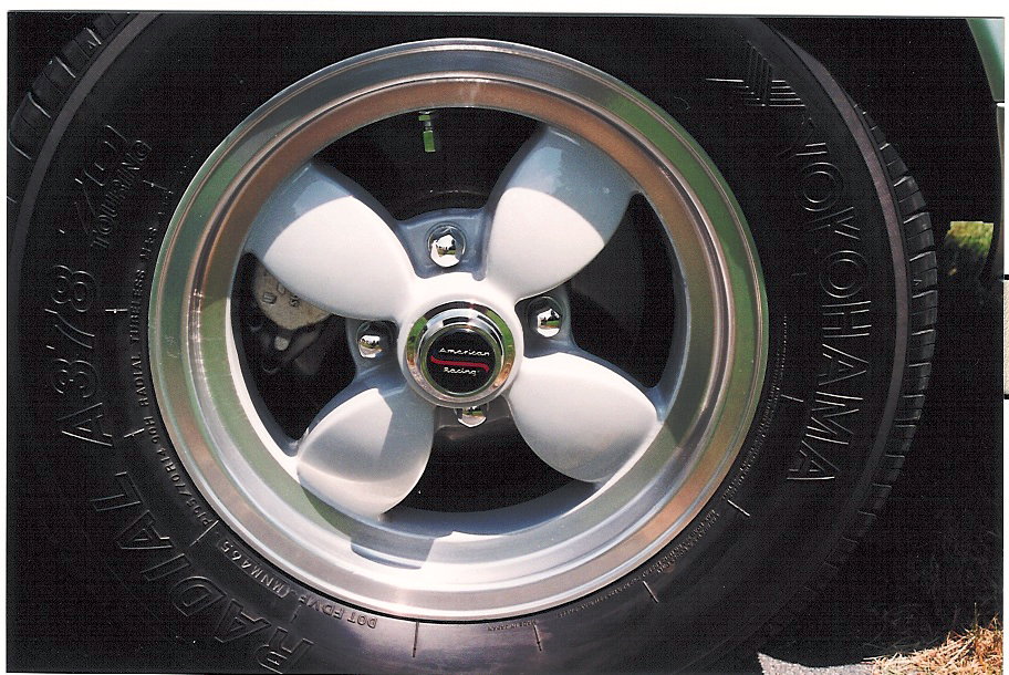

Hi Stephen---
Your's are another rim pattern that I like!
There's just somethin about 4 lugs and four spokes that goes together.
I guess it's the symmetry. Just looks right!! :love:

Hi Carl, Stephen and all,
I've still got the set of Libre's off my long deceased 71. Would you guys recommend getting the backsides of the wheel bead or soda blasted? I'd like to get them cleaned up and use them occasionally. Anybody have a good suggestion for the proper compound to bring the lip's shine back?
Thanks,
Chris A.
Hi Chris:
Glass beads come in about three grades of abrasives... AIR they are Course, Medium, Fine. You can use Medium on very dirty, oxidized or stained wheels, or Fine on wheels that are in better shape. The key is in controlling the air pressure used with whatever gun is used. Most common mistake is to use too much air pressure.. which can take away too much if the material that you want to save.
Soda blasting works, but it takes quite a bit longer and on the original rough cast surface it can leave them a bit too polished. That can happen as well with the Fine Glass Beads if you go over them too much.
You do NOT want to bead/soda blast the polished lips, unless they too are in very bad shape. Blasting them will leave a very fine texture.. which then has to be wet sanded out 1000 grit then 1500 grit, then polished with metal polish... done by hand that can take a weekend per wheel.
If your going to Blast them yourself - do the inside/backs first - so you can see how effective the blasting process is - and then adjust accordingly for the fronts.

Dealer installed (January 1972, for delivery) Libre (American Raceing w/caps) on my 1972 Datsun 240z (Silver Bullet). Thirty years later they were professionally cleaned and powder coated. The firm that did the work said they would charge twice as much if they ever had to do a set again. After blasting, cleaning and baking the first coat of powder was applied to the spokes. Upon removal from the oven orange peel was present from continued outgassing. They had to correct and apply a second coat. The same thing happened with the polished rim. I don't recall the exact process or materials used. Have put over 15,000 miles on them and all it takes to clean them is a damp cloth. Balance weights are on the inside of the rim.
Thanks for the tips Carl.
Ken, those are great looking wheels. I'm thinking black or charcoal powdercoat for my spokes. The gold just wont look good on a silver car.
Chris A.
