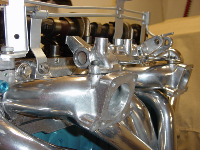

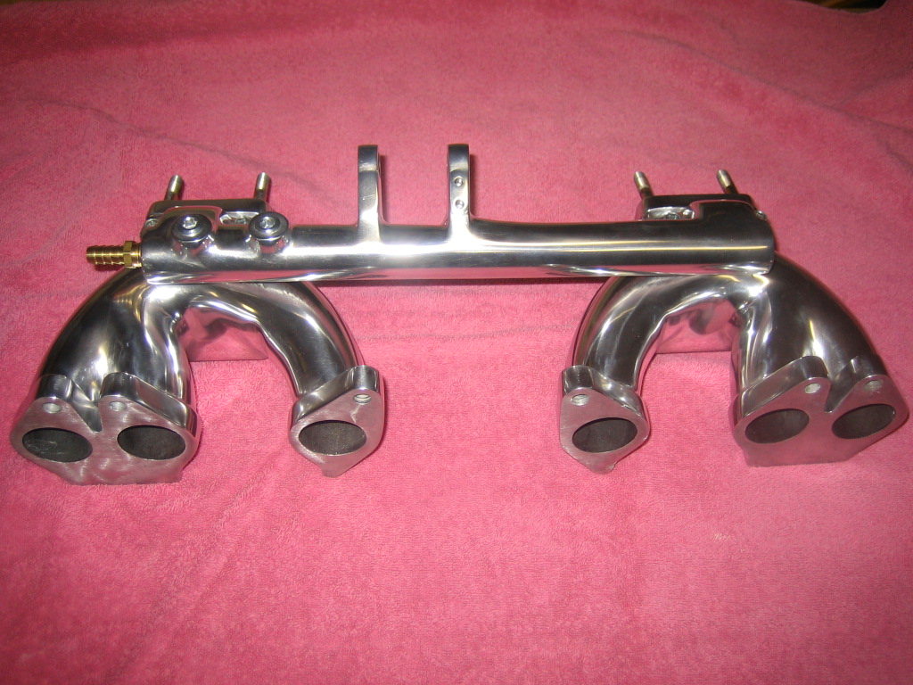

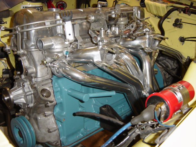

Posted May 10, 200619 yr comment_167002 Well, I am making some progress on my L28 swap into my '71 track car. Got my new intakes on and the engine/trans back into the car. Here are a couple of pictures of the new intakes. Who can guess what's different about them? Marty Link to comment https://www.classiczcars.com/forums/topic/19998-check-out-my-new-intakes/ Share on other sites More sharing options...
May 10, 200619 yr comment_167005 Marty, how did you get these polished like this. Did you do this yourself? My guess is the angle of the carb side intakes Link to comment https://www.classiczcars.com/forums/topic/19998-check-out-my-new-intakes/#findComment-167005 Share on other sites More sharing options...
May 10, 200619 yr Author comment_167007 One of my Z buddies ported and gasket-matched the the intakes for me. That should greatly increase the air flow. I am hoping for a aproximately a 10HP increase. While he was at it, I had him polish up the outsides too. I believe he first use a sanding wheel to get them smoothed out, then buffed them with a buffing wheel.As far as the guess, sorry, that is the stock angle.Anyone else?Marty Link to comment https://www.classiczcars.com/forums/topic/19998-check-out-my-new-intakes/#findComment-167007 Share on other sites More sharing options...

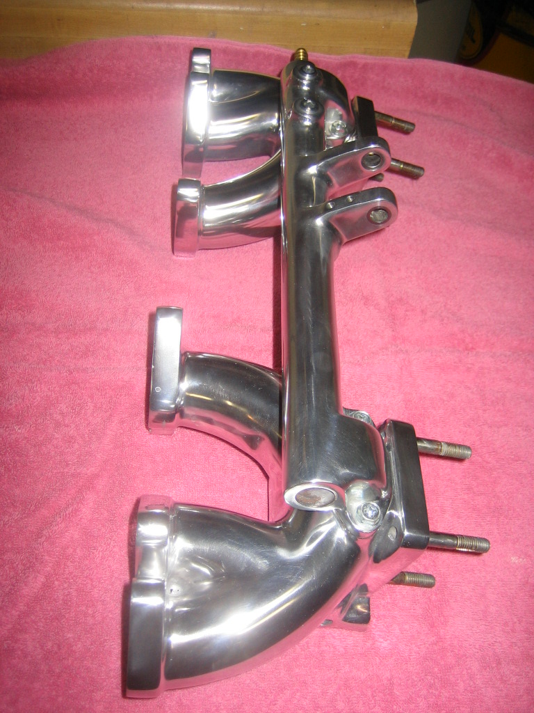

May 10, 200619 yr comment_167013 Marty:I would guess that all the water passages have been removed and filled-in. Don't have to water warm those puppies any more! Link to comment https://www.classiczcars.com/forums/topic/19998-check-out-my-new-intakes/#findComment-167013 Share on other sites More sharing options...
May 10, 200619 yr Author comment_167020 And Ken gets the Booby Prise!! Go directly to the Boobs thread and enjoy! The water jacket area was interfering with the header tubes. So it was completely cut off and ground smooth. He did such a nice job that it looks like it came from the factory that way. A very clean look. Here are a couple of close-ups to show the finished product. Marty Link to comment https://www.classiczcars.com/forums/topic/19998-check-out-my-new-intakes/#findComment-167020 Share on other sites More sharing options...

May 10, 200619 yr comment_167053 Nice job on the polish, but I'm suprised the guy doesn't clean up the balance tube while he is at it like I did.What casting is that intake? Link to comment https://www.classiczcars.com/forums/topic/19998-check-out-my-new-intakes/#findComment-167053 Share on other sites More sharing options...
May 10, 200619 yr comment_167056 Is that a MSA header,because I have the same set up but not installed. I have a 2.4 but that shouldn't make a difference. I hate to think I will have to grind again on these intakes. This is the first post i have read that there was interference of the header with the intake. Anyone else??? Link to comment https://www.classiczcars.com/forums/topic/19998-check-out-my-new-intakes/#findComment-167056 Share on other sites More sharing options...
May 10, 200619 yr Author comment_167058 Nice job on the polish, but I'm suprised the guy doesn't clean up the balance tube while he is at it like I did.What casting is that intake?He offered to clean it up. At the time, I thought I wanted to hook everything back up. I have to pass emissions tests in my state.Marty Link to comment https://www.classiczcars.com/forums/topic/19998-check-out-my-new-intakes/#findComment-167058 Share on other sites More sharing options...
May 10, 200619 yr Author comment_167059 Is that a MSA header,because I have the same set up but not installed. I have a 2.4 but that shouldn't make a difference. I hate to think I will have to grind again on these intakes. This is the first post i have read that there was interference of the header with the intake. Anyone else??? No. It is a Pacesetter Header that I bought direct from Jet-Hot Coatings. It shocked the hell out of me to, !!! I never heard anyone say that they had a clearance problem with this swap. Oh, well. It just slowed me down a bit, but it is fitting great now. Marty Link to comment https://www.classiczcars.com/forums/topic/19998-check-out-my-new-intakes/#findComment-167059 Share on other sites More sharing options...
