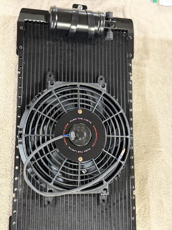

My suggestion would be to install an electric pusher fan on the condenser. Thermostat control sensor that comes on at 185 degrees. Mitsubishi has a 10” that fits perfectly. “MMFAN-10C”
That fan is way too large besides being expensive. Here’s one that fits nicely on the Ac condenser. Pushes air while the factory fan pulls air.
What size is that Mishimoto fan? And would you just use the Mishimoto mounting kit to attach it?
10” It comes as a kit. You can buy it through Amazon. I listed all the information in a previous post

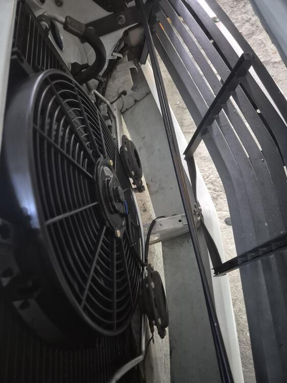

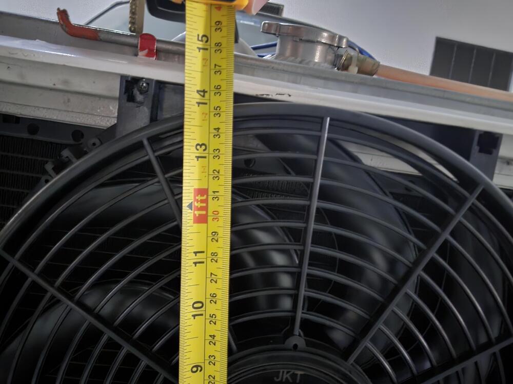

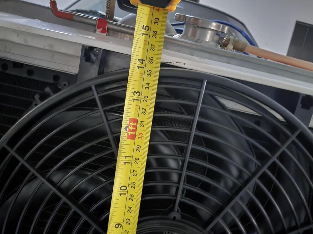

Thanks Yarb. We bought a cheap chinese 50usd fan for the AC. Its 14 inches. I need at least 12 inch powerfull fan to ventilate the engine bay and avoid issues during traffic and high tropical humid weather.
