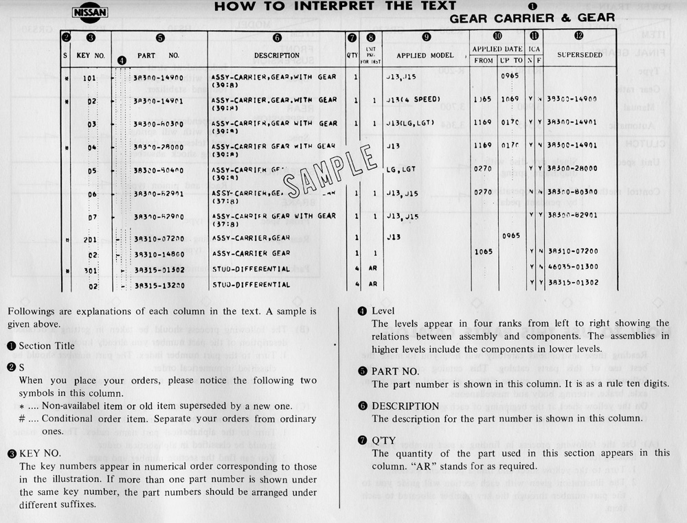

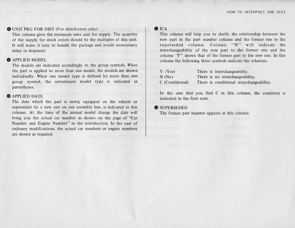

There is one other question I have tried to get an answer for about this CD but, in the past, got no response. Maybe someone could help. In one of the last columns of this CD the heading is "ICA" and beneath this are two sub- columns labeled "N & F". Down in the parts list these columns will either have a "Y" or "N" and sometimes a "C" for a specific part. I am assuming this reflects the interchangeability of parts, but I don't know what the "N", or "F" stands for, or the "Y" or "N" or "C". Can anyone help me out on this definition?

AZ-240z,
These scans of two "How To" pages from the paper editions of the Nissan 'R-Drive' parts lists should give you all the information you need:
Thanks Alan, I looked and looked for those pages. Was really perplexed that I could not find them!?
Ha! You're slacking, Mr W. :)
I just took a peep at my one and only USA-market R-Drive parts list too, and its there alright ( although slightly different to the RHD Export market versions ).
Did these pages not make it onto the CD-Rom then? That's a pity if so.......
Alan T.
Alan,
Your the greatest. I have been totally frustrated trying to find this information. Many thanks.
