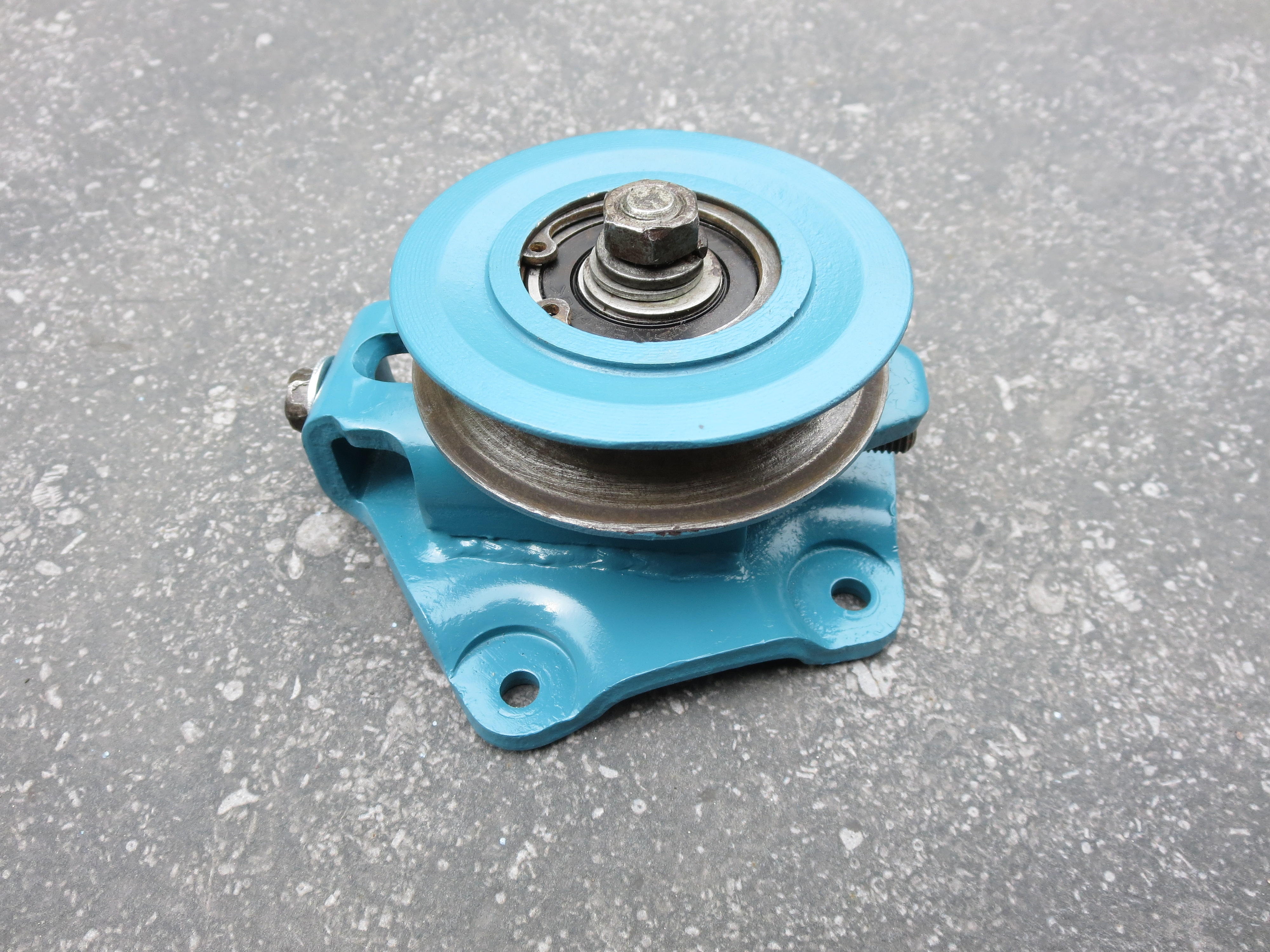

The nut is a M10x1.25.
The pitch is fine compared to the normal nuts (M10x1.5) you will fined in a hardware store. You best bet would be an autoparts shop or machine shop. You could ask a garage is you can hunt through a nut and bolts tin.
The other thing you might want to know is the nut flats are 14mm opposed to the standard M10x1.5 nuts with 17mm flats. 17mm should still clear the bearing.

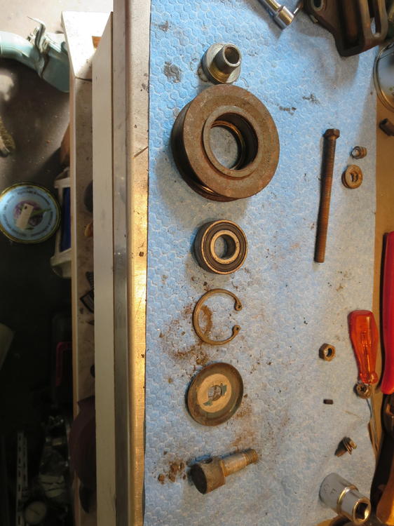

The flat washer also has a small outside diameter OD: 16mm, ID: 10.2mm, thickness 2mm. The spring washer is normal size.
Edited by EuroDat
added photos
