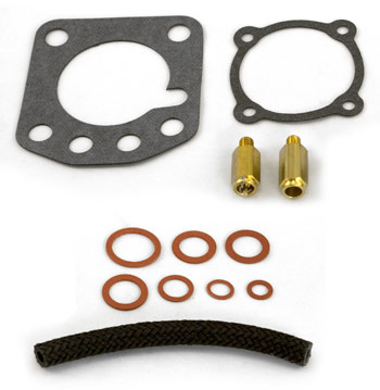

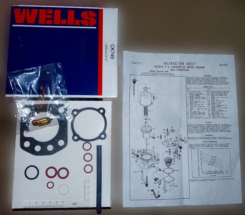

I just picked up two SU kits from Black Dragon (Victoria British) and the quality was poor thus the spur to revise this post.
Black Dragon
Manufacturer: Wells
Part Number: CK749
It only includes:
- Fuel bowl needle valve assembly and gasket (much shorter assembly than the two I have in the carbs and not easy to disassemble like the originals).
- Fuel bowl top gasket (very thin paper material)
- Carb to manifold gasket (very thin paper material)
- Rubber gasket for plunger (very thin rubber)
- Clear plastic spacer for spring base (very thin clear plastic)
- Fuel bowl drain gasket
- 2 paper washers different colours and materials (for fuel banjo I assume?) I was hoping they would be aluminum like the existing ones.
- 3 mystery paper washers (not sure where they go? ID of hole is 10mm and OD of washer is 14mm) Any ideas? Cooling passages?
- fuel hose (best part of kit)
The gasket paper changed between the two kits I received.

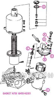

The documentation was generic and did not show where gaskets go however it was informative:
Page1:
su carb.PDF
Page2:
sucarb2.PDF
This is my 2nd kit. At least the gasket material is the same in this one.
Comments:
This kit needs front gasket for carb and metal banjo gaskets then it would not be so bad. A fuel filter sock, taller needle valves, and better quality paper would also be improvements.

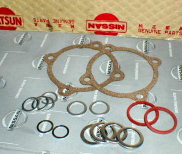

This all Nissan kit from Japan is good value for $30. Does two carbs.

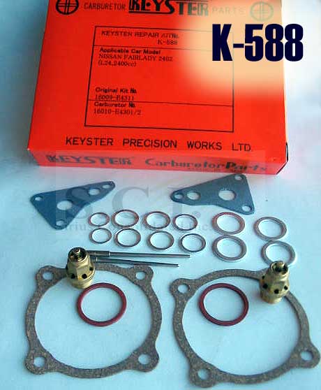

Best Value seems to be this 72 240z Keyster Kit for $30. It does two carbs and has needles too!
Needle valves look aftermarket.

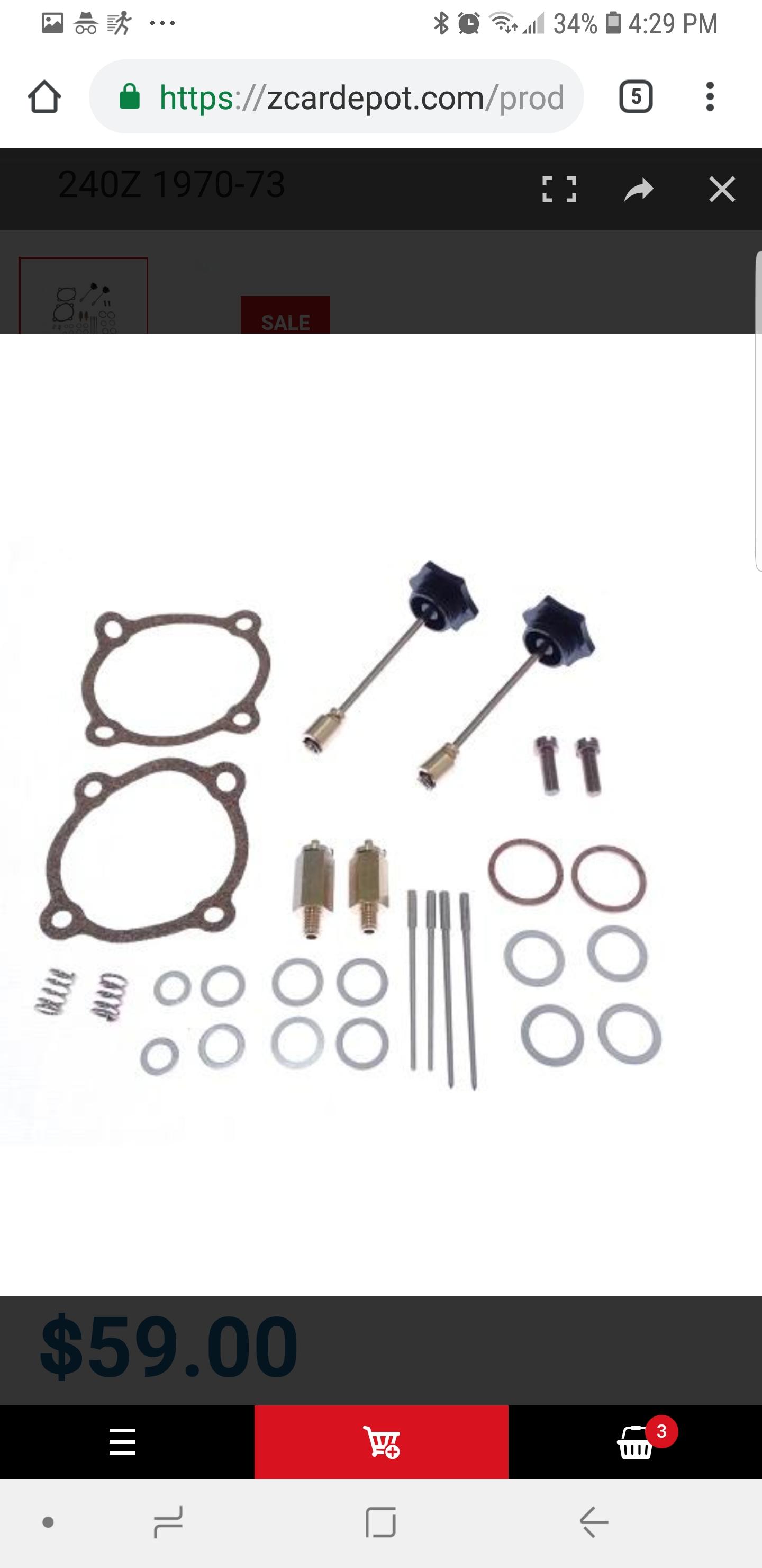

Bring this one back to life. Does anyone know anything about the kit from zcardepot that includes damper dip sticks?
