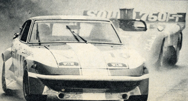

Here are some reference pics of Yanagida's car. First shows him being overtaken by the Lola T290 of Urushihara, and second with the McLaren M12 of Sakae looming in his mirrors. Third is a closeup 'mood' shot in colour, and finally a portrait of Yanagida himself from mid 1972.
Hope that helps.
